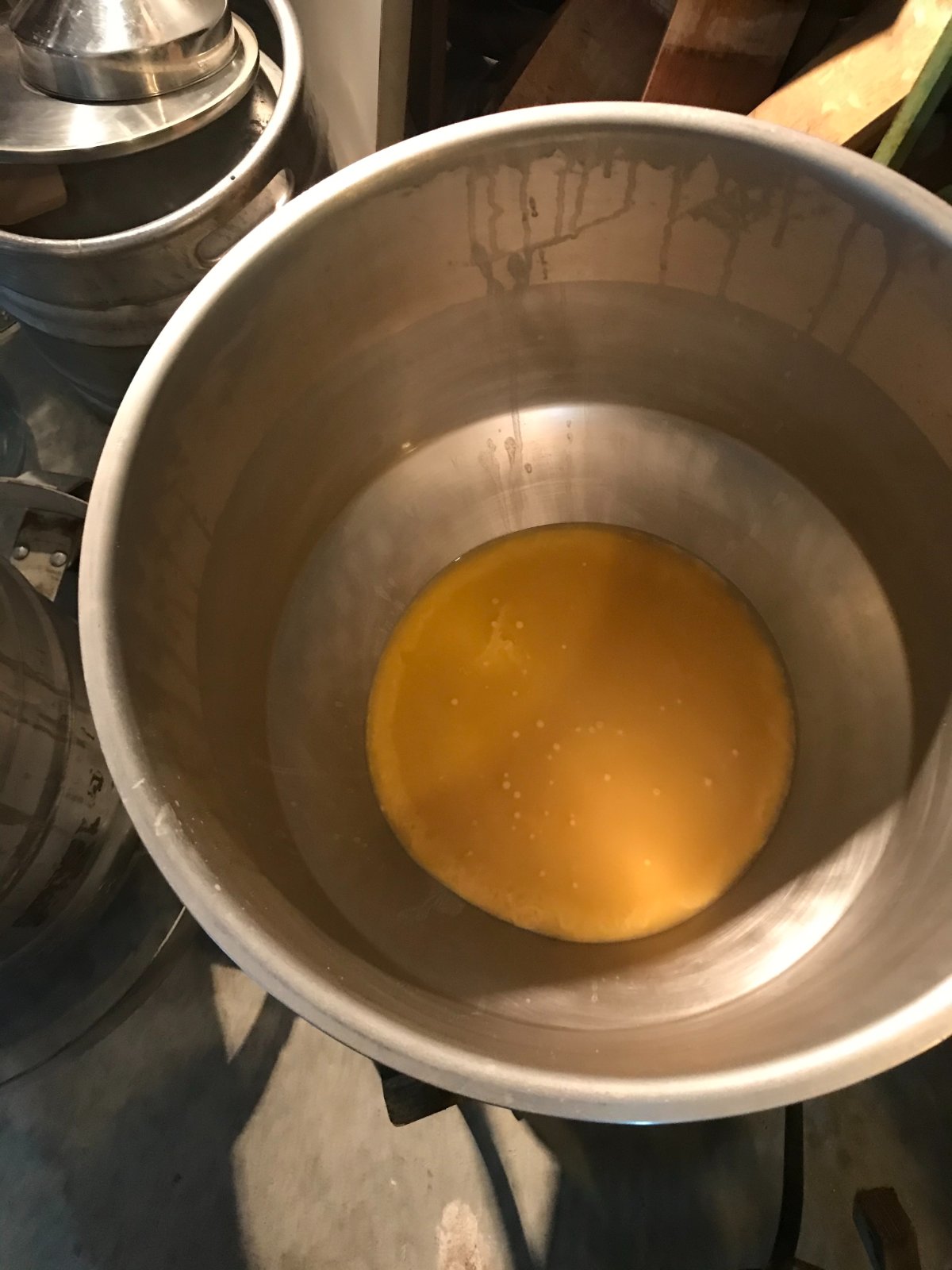

Definitely an exercise in patience. The finer the grain is milled the more fines are created and the longer it takes to clear. After racking the clear top half of a finished keg ferment into a carboy, I let the squeezed bottom half clear (7-10 days) in a conical. The remaining custard I put in the fridge and a month later rack the clear to my next stripping run. I feel this liquid from the custard is the heaviest, richest beer of the ferment.

TB I will give this a try on next multi run batch. your idea will increase the quality on next batch for sure. Patience , hard to spell and hard to implement. This is my first adventure past one and done.
