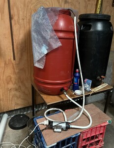

Orpheus , the teaspoon or so of citric acid that is added to invert sugar may be causing you issues . However , I would never worry about how my fermentation was going an hour after adding yeast , it’s just too soon .
Another thought is that boiling during inverting the sugar will remove oxygen so it is important , just like any wash , to stir the crap out of it before adding yeast to introduce heaps of oxygen that the yeast will need to initially build the colony . You aren’t just mixing in the extra cold water but adding Oxygen.
On that theme , I have recently been using a pump during the first 6-12 hours when the yeast multiply . It pumps the wash out of the bottom and splashes it back on top . As an added advantage , it keeps the fermentation in suspension and aids mixing .
I have found that recent fermentations are finishing quicker and sugar washes not needing as much , if any shells .
This is it on a Rum wash , but I do it on the Right hand barrel for Shadys Sugar shine too .
Incidentally , the Domestos Bleach is never used in the fermenters , nust used in benches and barrel over flows to stop mould growth .

Yummyrum wrote: Thu Apr 17, 2025 8:49 pm On that theme , I have recently been using a pump during the first 6-12 hours when the yeast multiply . It pumps the wash out of the bottom and splashes it back on top . As an added advantage , it keeps the fermentation in suspension and aids mixing .
What you’ve got there is a wort circulation system perfect for when you’re sparging the mash, Yummy. But I am sure it will do wonders for adding oxygen to the ferment during the yeast lag phase.
I got a paint mixer that I run with a drill in the wash before pitching. It creates a vortex in the tun and produces so much oxygen, there’s like a carpet of foam on top after I’m done. After that I tend to leave the rest to sacharomyces, I dont even bother to shake the fermenter during the lag phase anymore, 6-12 hours later the ferment is usually orgasmic! :) My whiskey washes ferment out in three days, the rums in five days.
You are right about the citric acid being the culprit in the inverted sugar. Must be.
