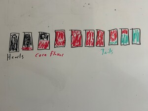

Yes. My whiskey was bland until I started stripping deeper, and cutting further into the spirit run. I look it as four sections now. Heads, hearts, flavor, and tails.
A decade of taking only “hearts” was sub par. Some will say hearts is what makes the cuts. Semantics….call it late hearts, early tails, or whatever… but I look at hearts as the most neutral part in the middle. Taking only that kinda sucks.
I drew this based on my own nose and experience.
