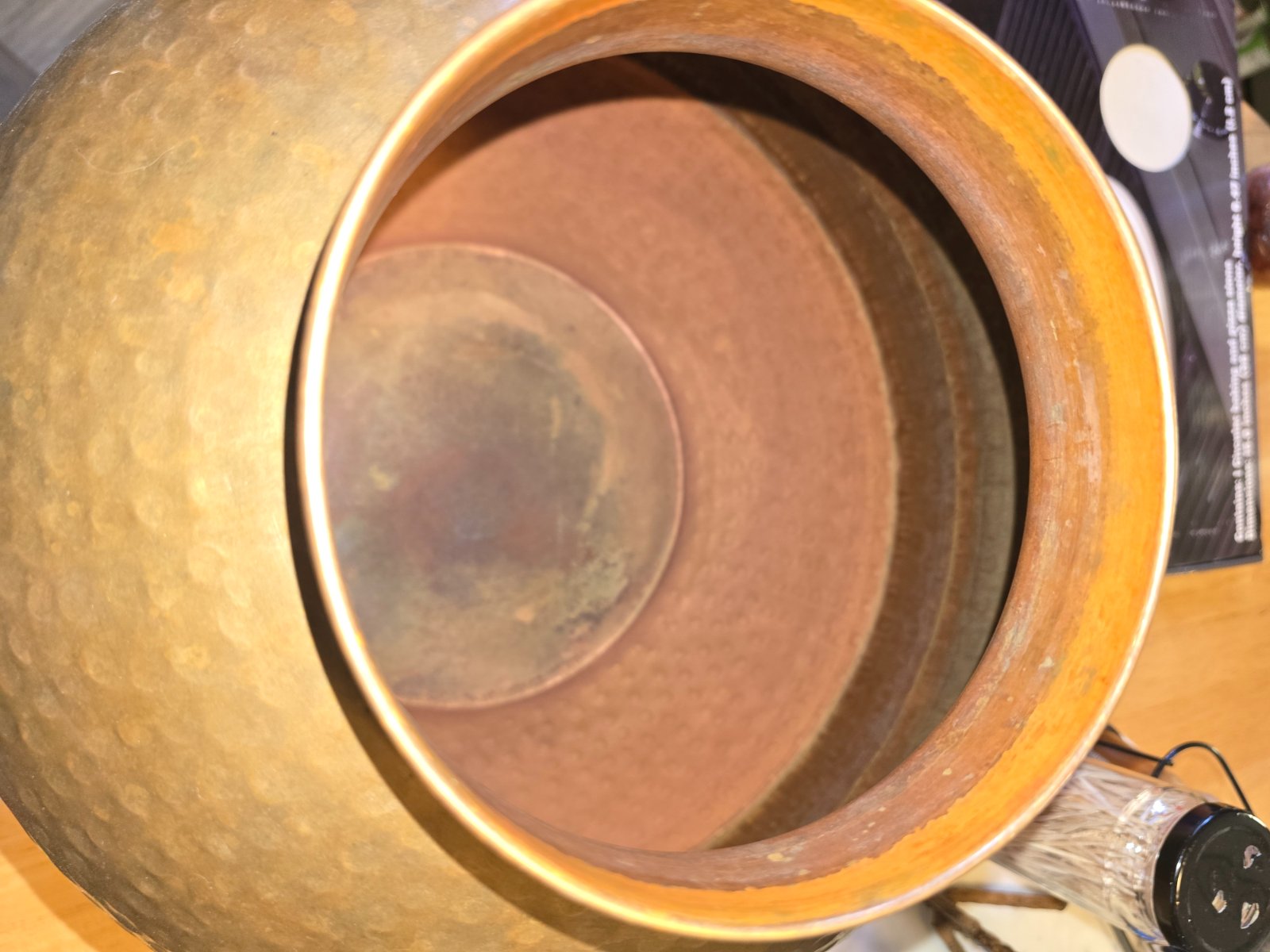

Can you take a pic or three? That would be helpful to see what you're seeing.
Copper will develop a patina (aka: seasoning) the more you use it.
I'd recommend rinsing before use and then using it alot and often to get the patina developed. Not a blue/green verdigris kind of patina, more of darker coating. This patina is desirable. Cleaning it to a shine each run is not desirable. Typical to just rinse it and let it air dry.
You might towel dry it and see if it still develops.

This is the only picture I have on my phone. This was after I wiped it out and you can see towards the bottom the color Im talking about starting. By the next day it will be noticeably whiteish blue. Im almost starting to see what the above dude said about hard water. It makes sense. Its speckled throughout that part thats very patinad but not picking up real good on the camera. None of the colors are coming through good enough. But that ring around the bottom definitely turns a real lightish blue after a couple of daysjonnys_spirit wrote: ↑Fri May 16, 2025 10:56 am Can you take a pic or three? That would be helpful to see what you're seeing.

That looks beautiful thanks!
Is that where the liquid level line is after the run? If so, I think it's pretty normal. I see the patina develop differently above/below the liquid level line. I had it turn purple before if I can find the pic.
If you can get a pic of it in a worse state at some point that might give folks an idea.
Maybe rub some off onto a clean napkin or something and taste it?

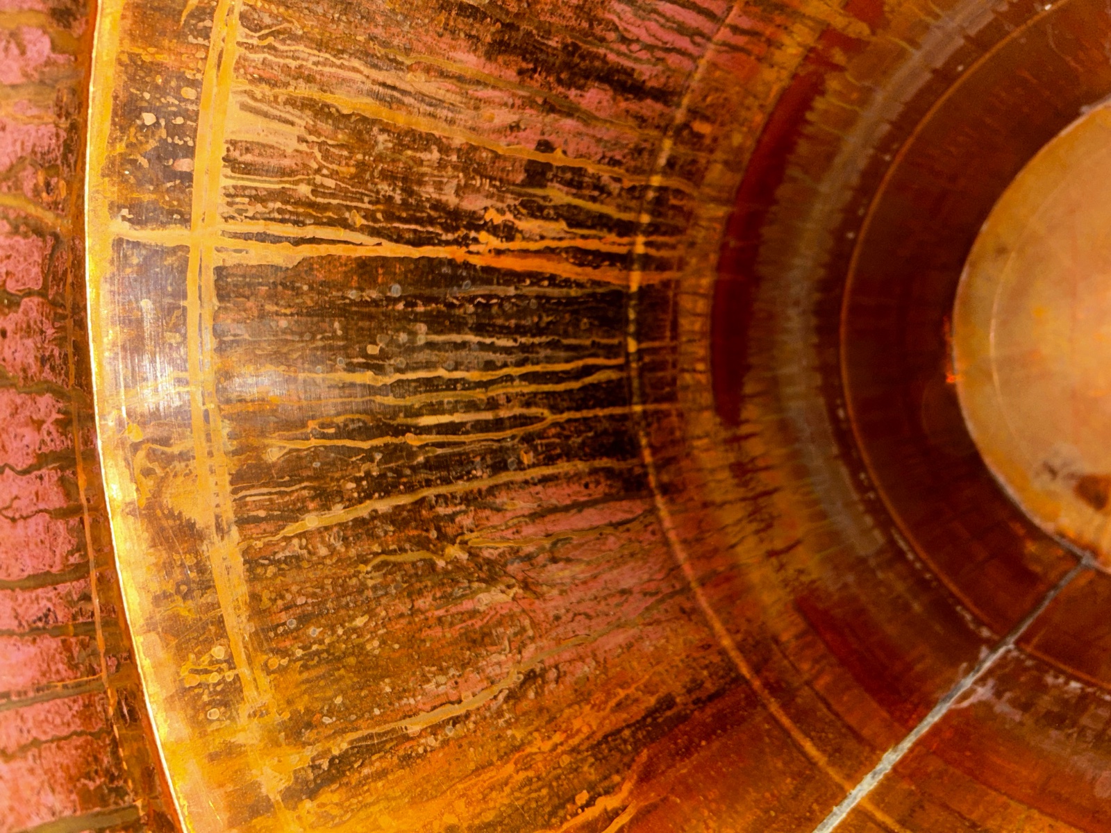

Thats the weird thing. No. My liquid level goes way on up. I fill it to about 20 outta the 25 gallon capacity. The bottom 1/10 stays a pristine looking pink. Its weird.jonnys_spirit wrote: ↑Fri May 16, 2025 11:24 am That looks beautiful thanks!

Yeah, below the final liquid level at the end of a run is consistently clean/bright and it's more patina'd above that line and patina is bit thicker right around the line. The backset liquid left behind in the boiler is fairly acidic so it's a good cleaning agent and the vapor above the liquid line is more hot ethanol vapor which I guess is also a good cleaning agent.
I think the drip marks are condensate dripping back down throughout the run..
The purple I had was more like the copper changing color, less like a powdery residue...
I'd taste a little and see if it tastes like verdigris... Rinse and spit!

Id also guessed the drips were the water finding its way back in too. Those streaks are a yellowish-greenish tint similar to what the backset looks like.jonnys_spirit wrote: ↑Fri May 16, 2025 11:50 am Yeah, below the final liquid level at the end of a run is consistently clean/bright and it's more patina'd above that line and patina is bit thicker right around the line. The backset liquid left behind in the boiler is fairly acidic so it's a good cleaning agent and the vapor above the liquid line is more hot ethanol vapor which I guess is also a good cleaning agent.

That's minimal. Whatever is there will get washed away by the next cycle, and then it starts over. No worries.

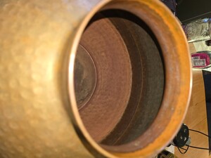

That's my 5g alembic, it just does it, every time.

Yep. I can see it on yours. Same circular pattern and allCorn Cracker wrote: ↑Fri May 16, 2025 4:11 pm 20250516_181553.jpg

Looks like condensation from moist air while setting is making streaks on the natural patina that's trying to form.
Hells of fire, when you said "Copper salts wont go away" I thought it was some kinda nasty build up. Don't worry about the pot and thumper, it's the worm that's going to progressively build up crud and will eventually need cleaned
But less so than potstilling because there's a thumper before it to keep oils from getting to the worm.

I figured the discoloration was just the wash level leaving oily deposits and discoloring the copper, I've never noticed any off flavors but, I do scrub it before and after each use
