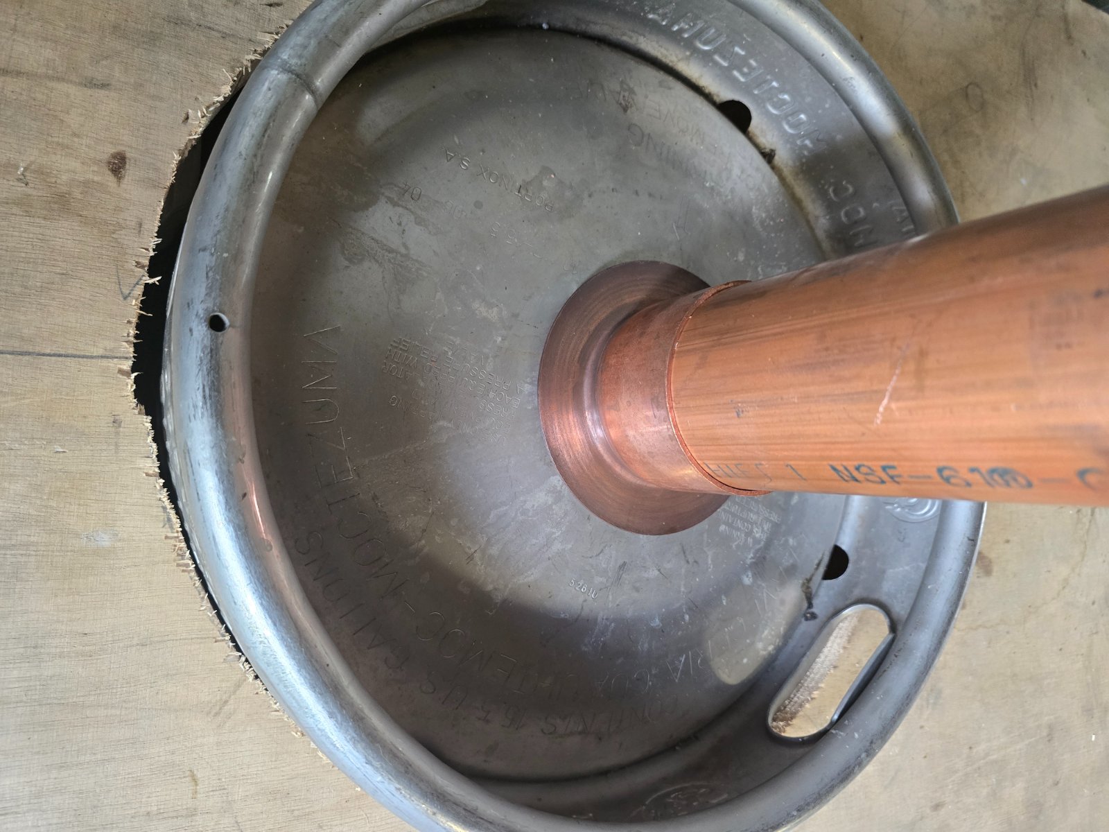

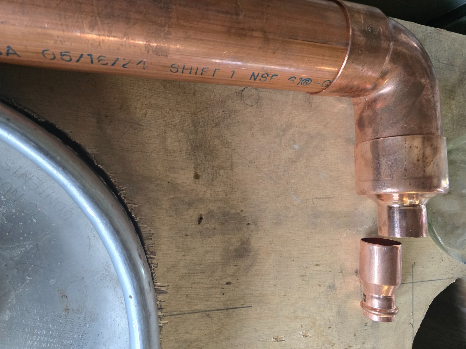

I misspoke on the reducer i have, it's a 3x1½ and I have a 1½x1 in the fitting reducer to go in it.
I've also got a 3 inch copper flange to solder on the smooth ( not starred) top of the keg when im ready to cut the sankey out and install it. I wish it was 4inch for getting in and cleaning it.
I still can't upload pics and am in no big rush on this 3 inch project, I've only got 1 stripping run on the new keg build so far and I still need to learn how to drive it and the thumper

- Posts: 544
- Location: s.e. Texas
Re: Stuff for a 3 inch upgrade
Here's what I have
