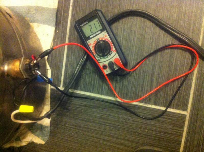

Thats what I did, the 4500w heating element I got from an old water heater I found on the street was longer that the keg diameter, so I soldered a female threaded (2.5 in long) fitting on the bottom side of the keg and it worked great, at full power it boils 40L of wash in about 25 to 30 mins
Heres a pic:

Janee, any chance you could show some pics of your "Adjustable 3800W AC 0-220V Voltage Regulator" and how you have it set up? I don't see a SSR in use with it on any of the google results I found.

I wired it to a 220v outlet, with two switches, one to bypass the controler so it runs at full power till it gets up to temp. then i switch that one off, and turn on the switch to the controler, run off the knob on controler to adjust how much heat i want, i have an s.o. cord to plug into my 220 recptical, put it all in an old plastic battery box, i bypass it because my element is 5500 watts, but after its up to temp. you dont need that much power to hold it where you want it. also drilled holes in the box for air cirulation.

So you put it inline, no SSR or PSR to control? How hot does it get, or did you add a fan?

it needs no ssr or psr, i beleve is a triak based control, if its a real hot day i do put a fan blowing in the box, i have touched the heat sink after a long run and its not hot enough to burn your fingers, there is another one on there thats bigger, more watts, bigger heat sink, 20 bucks, i might get it for a spare, just incase. i think its 10000 watts, that would be 40 amps. but at 40 amps you would be exceding 80% so it should be on a 30 amp breaker

I just ordered two of them, only $8 each. Can always find use for a cheap speed controller if it works, maybe on my grinder. Where did you find the 40A version? I did find a nice voltmeter & ammeter for $9
Thanks. This solved another project I've been working on. Silicon Controlled Rectifiers are awesome.

if you want to look a the bigger one, it 10000w 220v voltage regulator, it is a scr- silicon control relay-, looks more heavy duty than the 3800w

I have ordered some and so has I_am_braveheart, I will come back to you when they turn up and tell you how they perform, or if they just explode.
Ok i just got these, thought I would test them with a light bulb on a cable with the plug on it first and they work a treat, best £5 I ever spent.
