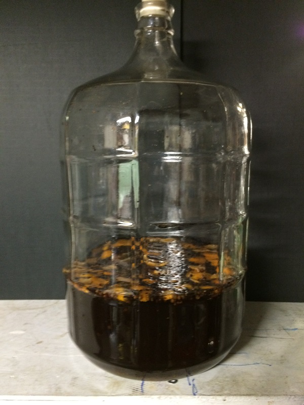

Well yesterday I got around to starting out on a small batch of OEJ.
My base is a batch of Bird Watchers Neutral sugar spirit. I strip it first in a pot still, then I run it through by BOKA reflux still to 95% ABV or so. I took reasonable cuts of heads and tails so the hearts seem very clean, just the slightest hint of sweetness once cut back down to 45% +- ABV. The store was out of distilled water so I used spring water with the lowest dissolved solids I could find of the lot. The neutral is fine for mixing with juice for a quick evening cocktail.
I used about 6.25 Litres of 45% ABV as my base for the Gin.
Taking Odin's recipe I had this below as the baseline per litre:
1 litre of 43% plus ABV neutral spirit
12 grams of Juniper berries
3 grams of coriander seeds
Skin of one tangerine
My multiples were as follows:
6.25 litres of 45% ABV neutral
75 grams Juniper berries
19 grams of coriander seeds
6 skins of clementine, (It's winter here and harder to find a wide variety of fruits, Clementines are a cross between a Mandarin and a sweet Orange and are closely related to Tangerines as I understand it so that's what I used)
I also included two stars of Anise for a wee kick. Note, they really go a long way, I may have overdone that part.

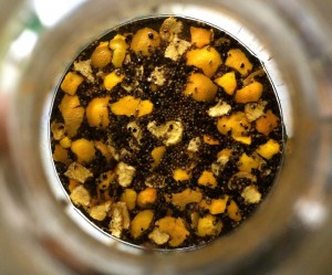

I put all the dry goods in the cocktail blender and did a few quick pulses to bash them to bits. Some elements remained whole, some turned to dust, I figured I'd give it a try to see how it went. My order for a mortar and pestle from the wife is still outstanding and I ruined my coffee and spice grinder by grinding up a bunch of the kids crayons for a craft project gone wrong.
The spirit was loaded in my 20 Litre Carboy and then the fruit skins and finally the dried goods. It was all given a good shake to get started.
A few hours later, it smelled awesome, just like Gin. A hearty flavourful Gin, not exactly a delicate one, but we'll see where we get to with it.
So tonight I plan on running it through my pot still. I normally use a largely uncontrollable table top electric heating element but tonight I will have her set up on the gas kitchen stove so I can have more precise control over the heat. I want to run it a bit slower then previously.
The plan is to decant the mix, botanicals and all into the boiler, then pick out the Clementine skins. I'll run it like that through the pot still. My boiler is about 14 litres in total, with a 48" Liebig condenser. In total it will be about 30 hours of maceration time in the neutral before I run it through the still again.
Wife had one wiff and is already asking for a more complex nose on the whole show. I explained that I have to do it pretty much according to Odin's specifications before I get all fancy or everyone here will get a shade upset with me for going off the rails from a T+T recipe. (She used to work in the libations industry flogging major brands across the country so her palette is not exactly new to this game. Thus her request for something more sophisticated).
For my next batch I'll be putting together 100 litres of RAD's All-Bran wash for my base. I'll be paying a trip to our big market downtown to speak to the spice traders about finding some more exotic stuff like Seeds of Paradise, Orris Root, etc.
Depending on how this goes, my next batch I might be trying vapour infusion instead on my reflux still by putting a basket in the top of the packing with the botanicals in it, so my low wines will be distilled with the vapour passing through the flavours. I am building it so it has a small capture funnel at the top of the basket that will grab the refluxed liquid and channel it through a small copper tube, down the middle of the basket past the botanicals and into the packing. The aim is to eventually get to a more delicate Gin like Bombay Sapphire with that approach.
Eventually my Holy Grail is to be able to re-create a version of Pimm's so I can enjoy our flaming hot summers with a vat of that available to me.
Thanks Odin, smells great so far. I will let you know how it goes.

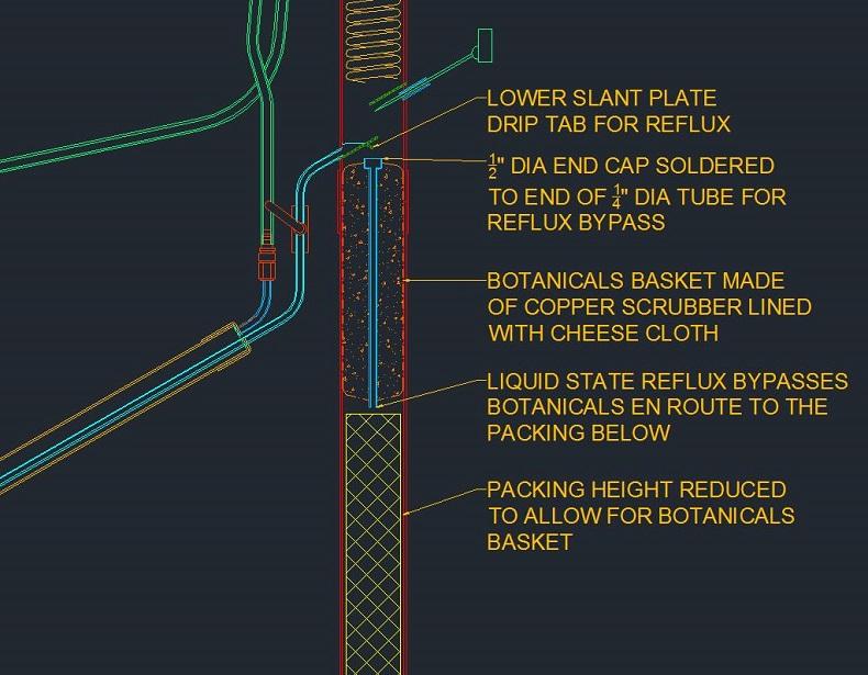

Edit: here be the botanicals basket design for the Boka reflux still:

Nice write-up, Rum Monkey! Soon you'll be a gin monkey ...

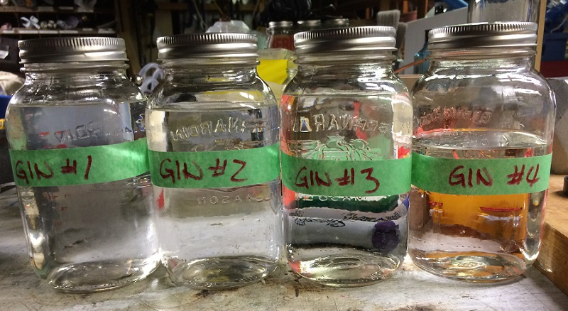

So fired up the pot still last night and did a spirit run.
All the macerated concoction went in the boiler and then I picked out the orange peels and pitched em.
Came up to heat pretty quickly and then I turned it down and let it go slow. 1 mm stream out of the condenser.
I collected and dumped the first 20-30 ml, then straight into the jars for the rest of the distillate.
Jar 1, 900 ml+-, 84% ABV +-
Jar 2, 900 ml -, 82% ABV+-
Jar 3, 900 ml +-, 78% ABV +-
Jar 4, 600 ml +-, 40% ABV+-
Thinking I'll use the first three jars and send the rest to feints for the BOKA. Thoughts?
Smelled and tasted quite nice coming off the parrot last night. Lots of orange coming through last night. Even Jar 4 smelled and tasted pretty good last night, not tails per se but...?
Had a sip this AM of jar 2, seemed less refined then last night. I'll give it a day or two to air out, blend it, and let it rest as long as I can without consuming it to see if it behaves a little better with some time in a bottle.

I don't believe there is anything to be gained by splitting the run, so run into one container for a calculated volume, then collect the last in 100ml increments. The only decision I make is whether, or not, to include any of them. They often taste ok, but might make the gin cloudy close to 40% ABV. There is no way I would chuck them in my general feints collection, so keep them separate intending to add them to the next gin, but usually drink them instead.

So I went with everything I had distilled and blended it all. I had pulled at least 50 l off the top and pitched it as fores already. Everything else smelled pretty good but with a range of flavours across the different containers.
Once blended I cut it to just North of 40% ABV. Again using the spring water I had laying about as the store still was out of distilled water.
A few of the bottles went cloudy on me but I am not too fussed about it, would have liked it clear but it still tasted very good.
Tasting notes:
The Juniper was the dominant taste by far. Wife and I were not sure at first, so I pulled out all the botanicals used in their raw form and crushed up a bit of each so we had some reference smells to compare to.
We had the Gin mixed as Gin and Tonic's with a dash of fresh squeezed Lime juice on ice.
Up till now wife has generally been disinterested in the whole distillation thing but this actually got her attention. Her general comments were that this was a very dry Gin and the one flavour was particularly dominant. Again, we determined this was in fact the Juniper berries coming through strong, but not overpowering. Hints of the Anise were coming though. At first we thought it was the Anise as the dominant taste, but once we tested against the raw botanicals again we saw it was the Juniper.
So all in all a success. 7 bottles worth plus at 750 ml per bottle.

Odin, I made my first "easy gin" this week. Great recipe and I really appreciate the protocol outline. It makes things very (easy) controlled for consistent results.
My run was scaled to 2 liters of 43% ABV all-bran neutral and I added Angelica root and Oris root at the X/100 ratio (according to Zymurgy Bob's post). I also added dried bitter orange peel and dried lemon peel at the X/100 ratio. Total botanicals and citrus was 30 grams per liter. It smelled wonderful throughout the 20 hours of maceration.
Oh, and I macerated the citrus separate from the botanicals (in 700 ml for the citrus and 1300 ml for the botanicals) to simplify the removal prior to redistillation. Then combined the liquids together into the boiler for the run.
I pulled off 50 ml at the start and discarded (maybe too much??) and then collected 100 ml (jar 1), 650 ml (jar 2), 150 ml (jar 3), and finally 200 ml (jar 4). I shut down when the distillate fell to 45% ABV.
I kept the jars separate so I could blend them to taste then next day. Jar 1 had a distinct orange aroma and the citrus taste was evident over the juniper. Jar 2 is the "textbook" gin, with juniper aroma and a clean dry finish. Jar 3 is very big in the "roots" flavor, bitter and somewhat spicy. Young (day 2 off still) it is "peppery".
So, I blended all of jar 1, 2, and 3 giving me 900 ml of 79 %ABV, which I tempered back to 90 proof (about 1.5 liter). Beautiful to look at (crystal clear) and it has a subtle juniper/piney aroma. Tasting it, the spiciness still predominates (day 3) yet and the juniper could be more forward according to my paradigms.
All this background for this question....as this matures in the bottle, will the peppery spiciness subside allowing the juniper notes to come forward? Or, do you think the berries should be increased in my next run? The berries are fresh and moist from that shop that Bushman recommended. Very good juniper, for sure.
I think the gin is great and perhaps I made it too complicated (for my first). I will definitely do another.
And "thank you" for building such a detailed recipe and protocol for us all to use. It does take the "worry" out of the process.

Hey, would anyone be able to show me what 12g of dried berries looks like? I'm hoping to give this recipe a shot with fresh, young, green berries, which I assume are a lot heavier than dried mature berries. Or even better, has anyone tried this with fresh berries, with recommendations on the amount per liter of neutral?
The best info I've found on this so far is here - http://homedistiller.org/forum/viewtopi ... 3#p6788592 - so I might just use that recipe as a starting point. I couldn't find much else through searching...
