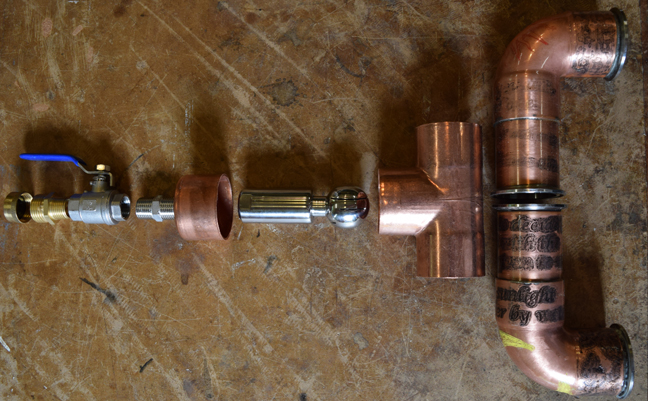

I’ve also included a few pictures of the botanical section. This was a late add to the still design, and thus had no etching in store for it. So I left it in a bucket with a good amount of white vinegar and salt on it for a week to develop some aggressive patina. Wish that I had took a few snapshots of it as I first pulled it out… the colors were amazing. Blues, greens, oranges, reds. However much of them were rather powdery layers, and I ended up brushing them off for fear of them screwing up the lacquer finish when I applied it. By the time I got down to a relatively stable layer of material, most of the beautiful colors were gone. After 3 coats of the finish these images are what was left. Pretty, but a pale shade of what is was coming out of the vinegar environment.

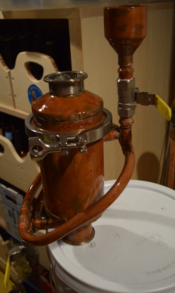

Here are a few more photos of the parts after applying the liquor finish. Let’s hold it stays solid at 210 F. And a couple interesting shots of the salts left over after I let the etching solution water evaporate. This stuff makes a serious herbicide, so it’s important not to poor the waste down the drain.

Two more photos of the base, showing the stillage drain projecting out, and the base after I applied a few coats of polycrylic finish.

Finished my CIP (Clean In Place) upgrade today. Very glad for this, as it should prevent me from having to take everything apart every time.
First shot is of the parts I was starting out with in an exploded view. The two elbows with the tri clam flanges are from the still as I had built it. These were the very top of my column. I am replacing the top center tri clamp with a 2” T fitting. This will be a tolerance variability reduction (improvement) to my design, and an opportunity to solder the bits to help correct the fact that my 4” plate column and my product condenser side tend to bend a little close to one another. Partly due to poor alignment when I first soldered this mess together, and partly due to the bending moment that gravity puts on my system.
The top of the 2” T is capped, and a hole has been drilled into the cap center to accommodate a ½” NPT double sided nipple. Inside the cup, I’ve soldered on a stainless CIP ball system, which is then inserted into the top of the T when the cap is soldered on. This leaves the CIP spray ball about in the center of the cross flow of the 2” arch. Can’t recall the exact cross sectional area reduction by the CIP ball, but it’s not too bad considering the pipe T opens up about where it is. I think all in all the ball cokes it to about 70% of the normal 2” cross sectional flow area.
Then you can see the valve, and a couple of brass fittings which I didn’t end up using. Instead I replaced the brass with a stainless quick connect and added a mating quick connect to my garden hose.
Second shot shows the original elbows after stripping the finish off with some foreshots, and marking where I need the cuts so they fit right into the T addition.
Next shot is my hack job. Kind of a bummer to re-work the work you just recently did, but those are the breaks with a big project like this.
Next shot I’ve first soldered the CIP sprayer onto the cup (roughed up the stainless and applied a lot of heat to get a puddle solder joint), then screwed in the double sided ½” NPT nipple to hold the spray ball in place if it got too much heat when soldering the cup onto the T and the T onto the two elbows. I splayed the elbows just a tad wide with respect to one another so they are no longer perfectly parallel as they project downwards. This helps to overcome the bending moment of the rig that I mentioned above.
Last shot, I’ve added the nipple and valve in to give me a feel for it.

Two more shots, after installing it back onto my flute. These two include the quick connect fitting. It’s now in place and ready for another cleaning run which I’ll be performing this weekend.
Happy, happy, joy, joy.
