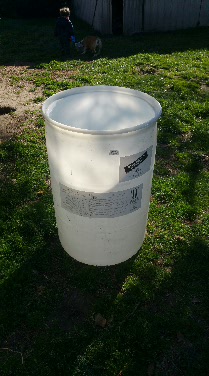

Heating up and ready to cut my teeth in AG!

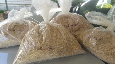

Grains ready to go and freshly ground, I'll be using cracked corn for this go but will get a mill soon to help with conversion for the future.
I'll post some more when things get rolling.
