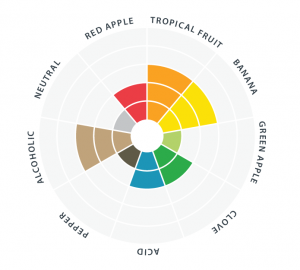

So I ordered some yeast for making an experimental batch of rum - wondering about your thoughts (group)? I got the Lallemand Abbaye Belgian-style ale yeast - qualities:
Other suggestions, or thoughts about this? I thought this yeast with it's high banana esters profile would be interesting to use...
I found this on the Lalle website, specific to this yeast: Was planning on running this one right at the top of fermentation suggested temp, 75F and after the heat bloom subsides, touch it up to 76F. Then also doing the esters tricks, some vinegar in the wash for distilling, long slow heat up, maybe even put a banana or two into cheesecloth and suspend just over the wash in the pot when I seal it up to cook for that added punch of banana in there - but just one or two if I do that - and it's better than 'floating' the banana in the wash right?Fermentation Temp Range (°F) : 63-77
Apparent Attenuation Range (%) : High
Flocculation : Medium-High
Alcohol Tolerance : Up to 12% ABV
Pitching/Fermentation : Traditional styles brewed with this yeast include but are not limited to Belgian White, Belgian Blonde, Belgian Golden, Dubbel, Tripel, and Quad.
Notes : Abbaye Ale Yeast (Danstar) is an Ale yeast of Belgian origin. Selected for its ability to ferment Belgian style beers ranging from low to high alcohol, Abbaye Ale Yeast (Danstar) produces the spiciness and fruitiness typical of Belgian and Trappist style ales. When fermented at higher temperatures, typical flavors and aromas include tropical, spicy and banana. At lower temperatures Abbaye Ale Yeast (Danstar) produces darker fruit aromas and flavors of raisin, date and fig.
I read, I write, I still.

I think you know my opinion: When playing with infections, the yeast selection is not important, at least for the taste. Maybe stressing the yeast will have a strong effect. So I would not necessarily follow the recommended maximum of 77 F.

Oh, that/this rum won't have any infected dunder involved. My current rum, which I'm distilling this weekend, will be my 2nd 'infected dunder' involved batch. The one I mentioned in the post above I wasn't thinking about/planning on infected dunder. I was just going to include some vinegar to encourage what little boost of esters that bit of acid might encourage that may have formed from that yeast.
When going outside the recommended range of yeasts, will they produce more of the flavors they are 'known' (as in that chart) to produce, or is it all bets off and could they produce nasty flavors? I figure you of all people, der wo, have some knowledge because I've been poking around with HD search, reading about several things and seen a lot of your old experiments I've come across. The specialized malts was an interesting one!
Anyway, any idea what happens with yeasts outside the 'recommended' range and flavor/ester production?
EDIT-
Just found this
https://byo.com/article/fermenting-belgian-style-beers/" onclick="window.open(this.href);return false;" rel="nofollow
EDIT-
Just found this
So maybe I'll run it hotter, and shoot for an final ABV of about 12% when I'm planning the rum out. Plus, pitch normal, but not aerate with my stick blender, just with my big old stainless spoon very well and as usual my few drops olive oil trick so even then the aeration shouldn't technically be necessary.Belgian yeasts typically produce more esters than British ale yeasts, and also some molecules associated with wheat yeasts. Logsdon adds, “Fusel alcohol raises perception of isoamyl acetate (banana). It isn’t detected as strongly when fusels are lower.” Higher original gravities, higher attenuation and inadequate aeration leads to more esters. (See the sidebar on page 45 for more.)
Increased fermentation temperature increases ethyl acetate levels, floral and fruity esters, and may be necessary for some of these yeasts to finish attenuating. Lower temperatures promote perception of phenols.
