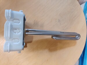

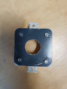

Ok, so after wiring everything up I wasn't happy with the element end of the wiring for 2 reasons.
I really don't want everything permanently wired to the elements, as it's a major pain to spin them back out of the keg if I need to, with the cables attached.
And secondly, the way the cables stick out is just asking for them to get bashed/broken/caught on something.
I tried making a 90 with pvc 40mm waste pipe, not good.
So I've had a re think and knocked up something that I think will be far better all round.
A thin steel plate cut and drilled to suit, goes over the element threads. This is bolted to a small electrical cover box, similarly drilled out.
Some PTFE sheet that I get at work for a face gasket will hopefully seal off on the fitting in the keg but PTFE tape on the threads will do that anyway.
This is as far as I've got for now, but I'm going to put an IEC socket in the side of the box wired to the element, and an IEC plug on the end of the cable.
Safe, instant, clean disconnect. Hopefully!

Short update, I got the elements wired to my controllers, fitted them and fired everything up, all works fine so I'm happy with my wiring etc but...
Still not happy with the element connection.
I've used little boxes with an IEC plug as per my earlier post, and it works fine but it still doesn't feel "Solid" enough.
I'm going to get a couple of the caravan (RV) connectors as suggested to me by zed and see if I can make something sturdy before I go any further I think.

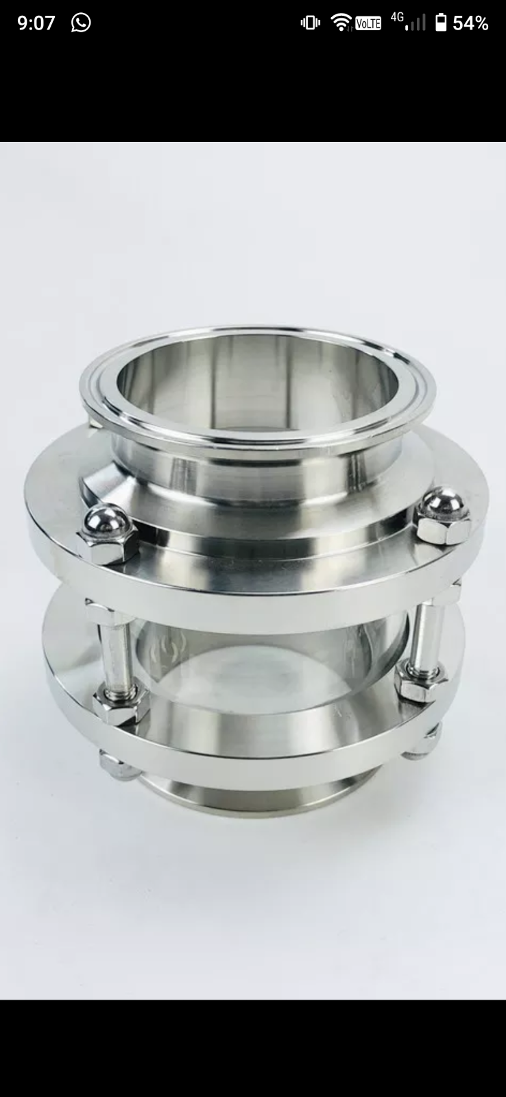

Sorry to regurgitate an older thread, but now that I've had time to run my still, I've been looking hard for a sight glass as suggested by Kim. It will make it just that bit too tall, but I really do think I need one to help me learn how to run it well.
And I've found what I think might be the perfect solution, a "Short" version that will only add 4" to the column!
Make Booze, not War!

Thanks Kim, now I've run her twice I really can understand how a view into the top of the column is so useful. I can't wait to be able to actually see the Reflux happening in there!
It's arriving from China end of this month, so the first dry weekend after that she'll get a run!

So, quite hard to believe really, but the sight glass arrived today, just over a week after I ordered it from China?!!?!
It looks really well made too, and super compact so it will hardly add any height or bulk to the still column, I'm very, very pleased with it.
I'm hoping I can do my first stripping run tomorrow in pot still mode, weather permitting, so I'll add it to the setup just to see what it looks like in there!
