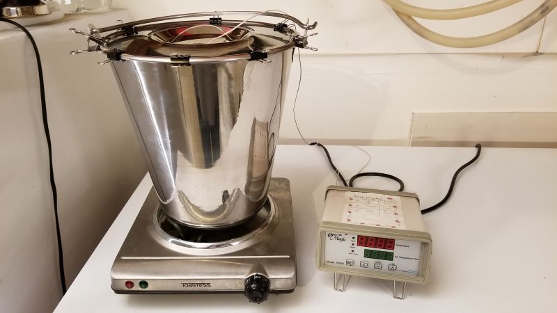

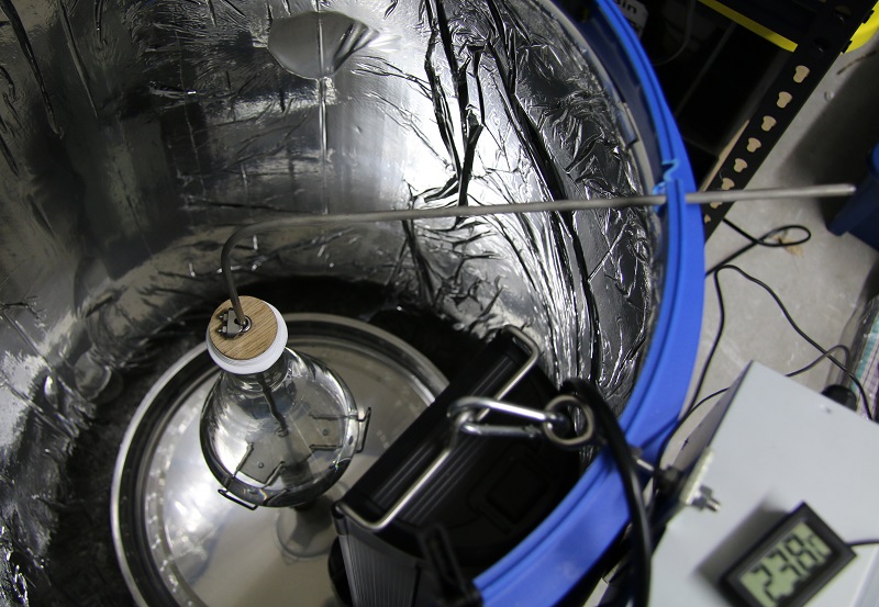

I am currently running a batch of UJSSM through the process and it has another 34 hours of heat to go, but it is highly promising (so far).
I have incorporated light treatment right from the beginning. After researching the patent and various papers on preservation against UV damage for museums and the textiles industries etc, I settled on 420nm (as a starting point). That part of the spectrum particularly, is responsible for vanillin extraction. 420nm Actinic fluorescent tubes are commonly used in marine aquariums as they are effective at penetrating the far depths of the tank and allow coral to photosynthesize. This should help them get through coloured distillate, which is something that red and green spectrums struggle with. They are relatively affordable and don't consume huge amounts of power or generate too much heat (which is a problem with close proximity for a hobby sized setup). Using a double fitting light fixture, I can mix and match tubes of different spectrums. But for now, I have two identical 420nm tubes from Zoo Med.
The first thing I wanted to do, was establish if the lighting in isolation, made any tangible difference. After all, if you can't smell and taste something, then its probably not there.
LS were generous enough to qualify their experiment in the patent with the descriptor of "extremely bitter" (in relation to a sample that was only treated with light).

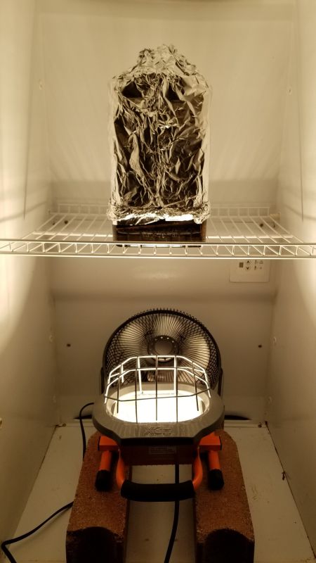

I set up two identical glass jars with the same white dog distillate, two halves of the same piece of white oak (med toast and med char) and placed them equal distance from the light.
One jar was blackened out completely. It was important that they both remained together as the light generates enough heat to hold the distillate at 30C/86F. So testing the two had to take account of every factor that could make a difference and void the experiment. Based on lux hour measurements, I calculated that I would need 19 hours to reach LS' minimum mentioned in the patent.
I taste tested at 12/24/48 and 72hr intervals.
Immediately, the difference was apparent. Undoubtedly, everyone here has tasted those early first few hours/days of oak tea. The light blocked jar exhibited it, dry and astringent, but the sweetness of the UJ still shone through. The light treated jar however was a completely different animal and I have never experienced it before (or ever want to again). The nose was completely closed. The taste however was more akin to Aloe Vera. It had none of the sweetness of the other jar and the last time I recall tasting anything like it, was when I bit down on an ant when I was a kid. Awful.
After 24 hours, things got worse. The light blocked jar started to exhibit tails with water, but the light treated jar was still horribly bitter Aloe flavoured. Water made it worse.
At 48 hours, things started to converge a little. Both rounded out and tails appeared in the light treated sample and both jars were less extreme in their offensiveness. 72hrs, it was even more so and I could not pick that the light had done anything further beyond 48 hours.
This was not a subtle result. I wanted to qualify that the light did something I could smell and taste. It absolutely did.
It has now been used with distillate that has been held for 48 hours at 65C/149F. I taste tested it and none of that nastiness is there, so either the light was ineffective at penetrating the much darker distillate, or it is behaving in line with what LS mentioned in the patent, which suggests that the bitterness is only in isolation with light treatment.
Further testing will be needed to really qualify the light's effectiveness within the whole process, but it is already far superior to the batch I've had on the same oak for four months.

I just followed LS' patent. The clear distillate is heated in a vessel along with wood and held at a set temperature for a set duration. There are many ways to accomplish this.HDNB wrote:salty, any chance for more details? maybe yer own thread?
thx.
I use a small coffee pot hotplate wired up to a PID and a small milk-can with a natural cork stopper and a stainless steel thermowell inserted through it. The can is never more than 3/4 full and the head space is there to provide a small amount of reflux.
When the first heat cycle is complete (typically 48 hours), I allow the vessel to cool enough and then transfer the contents to a borosilicate flask. There it is exposed to the lights at close proximity for 96 hours at a minimum. The content is then transferred back into the heating vessel and given another 48 hours.
Digging into some of the peripheral research (museum/gallery/textiles and paper industries) and their concerns about the damage light does to lignin, you discover that this damage doesn't happen linearly. It reaches a tipping point after certain amounts of hours or energy exposure has occurred. Museums carefully manage the hours as well as the types of lighting they use to illuminate their exhibits. For this reason, I think that short cycle Hot - Cold methods aren't all that useful for mimicking an aged product. If the threshold (where lignin is damaged) isn't breached, then you get little from the treatment other than a smoothing of the distillate and destruction (release) of the water soluble compounds within the wood. Lignin is a hard nut to crack. It will take abuse and then recover. If you don't degrade it sufficiently, then you won't get the good stuff locked up in it.

I had the stuff laying around for the most part, so I decided to play at this fast aging game. I tried to follow the Lost Spirits method closely as best I understand it from reading the posts here, the patents themselves, and articles written about Davis and his process.
First, I made some rum. The fermentables were Morena sugar and blackstrap molasses and the yeast was Fleischman’s. I fermented it fast and hot and the 22 gallon wash was done in 3 days. I distilled it on day 4 using my 4” flute with 4 plates. I left the cuts just a bit wider than I would if I were going to leave it white or age traditionally for a shorter time, but it was not objectionable as new make, even so.
I used oak cut from Garrison Brothers bourbon barrel staves that I had previously aged some rum on for a few months. Some of the staves, before charring the other three sides and cutting to length, are shown here. These staves have about 5.25 square inches of surface area per inch of stave length, and I target 70 square inches per gallon. That is about 13 inches of stave length per gallon of spirit. For this experiment given the amount of spirit I am processing , I cut 4 pieces a bit short of 6 inches in length.
About 1.8 gallons of new make proofed to 60% abv went into a stainless bucket along with the wood. I soldered a thermowell through the lid, and sealed the lid by coating the rim of the bucket in PTFE tape and using binder clips to hold it tightly in place. My sous vide controller regulated the batch at 149F for 48 hours.
After 48 hours, I sat the bucket in a cool water bath in the sink to cool down. When it was comfortable to handle, I removed the oak staves and placed them in the bottom of a large square bottomed glass jar I am using for the light treatment stage of the process. I purposely cut the pieces so that they would jam together at the bottom of the jar holding one another in place and covering the bottom surface of the jar completely. I poured all but a quart of the spirit from the bucket into the jar, leaving about 2 or 3 inches of headspace in the jar.
I then closed the jar, sealing its glass to glass joint at the top with a flour dough paste gasket, and covered it in aluminum foil all except the bottom inch or so. In this picture you can see the non-charred cut ends of some of the staves, with a charred end at the far left. I don’t know if I should have charred the cut ends or not, but I didn’t.
I set the jar on a rack in my “fermentation chamber” (upright freezer) over a 500 watt halogen work light and set a fan blowing on the light and bottom of the jar to remove heat. I left the door open and bathed the bottom of the jar in light for the next 48 hours. The light was powerful, and I was afraid to put it closer to the jar bottom for fear of heat buildup and jar breakage and spilling 1.5 gallons of 120 proof liquor on a hot halogen bulb. As I had it, the jar never got more than slightly warm.
For the final stage, the spirit all went back in the bucket with the oak and back on the hot plate for another 48 hours at 149F. Once complete, the spirit was allowed to cool, the wood removed, proofed to 57% ABV (“Navy strength”) with distilled water and rested for 3 days at room temperature to allow to “marry”.
All told, after 4 days in the fermenter, 6 days in the “reactor”, and 3 days resting we have a finished product in less than two weeks from start to finish. The verdict on the sensory qualities of the product?
To my knowledge, I have never had 20 or 30 year old rum, so I have no direct comparison. I have had some 20+ year old bourbons and for the most part I find them too woody and/or varnishy in character.
I sampled the product, cut down to between 45%-57% abv with water, at each stage of the process. After seeing how dark some of my more traditionally aged spirits can get in a relatively short time, I was afraid that I would have coffee colored oak tea after the first stage. Instead, I had a light golden color after two days at 149F. I attribute this mainly to the fact that the wood used was not freshly charred, but had already aged a batch of rum for a few months prior to being used for this. That rum did take on more color after a month or two than this had after 48 hours of cooking.
The nose of the rum was fairly pleasant but not obviously showing any excessive age or oakiness. The tails were still there, not in a really offensive way, but in the new make way where if you make a cut any larger than the heart of hearts then the tails will be noticable. Even so, it made a very pleasant sip at this stage. There was a bit of the prickle to the side of the tongue and cheek/lip that indicates heads, though no overly solventy or sweet notes. No overt sense of cooked fruits, raisins, or vanilla that are often associated with age and oak. All in all, even though I failed to hold back spirit to do a head to head test with, I think this is sort of like a microwave treated batch or similar at this point. Nothing really old tasting about it, but definitely an improvement over white dog or regular temperature oaking for 48 hours.
After the light treatment, I sampled again. I definitely noticed the closed nose that SaltyStaves mentioned, though I had no big bitterness. The flavor definitely did seem changed and off, but I perceived it primarily as a function of the nose shutting down so much.
When the final 48 hours of heating was complete and the batch proofed to 57%, I sampled again at that proof and with varying amounts of water added. This is definitely better. I still don’t think I would confuse it with a 20 year old rum, but it no longer reminds me of new make spirit at all, and I can start to spot strengths and weaknesses of the spirit that have nothing to do directly with the aging process. Maybe use a little more molasses next time, or maybe add dunder for richness. The tongue prickles and noticeable tails flavors are no longer present, and the drink is much smoother, if not as rich and full flavored with oak and vanilla and fruitiness as I would like.
After 3 days at the final proof of 57%, I started to sample again (daily, imagine that). The final verdict is that this is some good drinkable dern nice rum that doesn’t taste a couple of weeks old. It is not convincing me that it is a top shelf 20 year old, but it is night and day from white dog or 2 weeks on oak stuff.
There are so many variables to explore that this experiment is by no means definitive. I could have done any of the steps for a longer or shorter duration, higher or lower temperatures, different spectrum of light, new vs. used vs. charred vs. toasted oak of differing amounts, and on and on. Even if this particular try didn’t produce a clone of a very old rum, who’s to say a different combination wouldn’t? Plus, I have a highly drinkable “aged” rum in 2 weeks to complement my bar stock.

Couple of observations. I assume the jar is soda lime glass? There are gains to be had using borosilicate. Even better is Quartz crystal. I use a borosilicate beaker. The thicker bottom of your jar is also going to reduce effective transmission. Not sure how easily you can adjust your setup from underneath, to side-on.
The most horrible astringent flavour I get after light treatment, is very much amplified when I use virgin oak. Considerably more tannin extraction than when I have used oak. Generally after three treatments, my oak is considered spent. However, if I don't do the light treatment for long enough, I'm guaranteed a nasty result. Your 500w has probably got you covered for 48hrs, but I need 96 with my lower powered setup. It will be interesting to see what you get when running the light treatment in isolation.
Very good start.

Agreed, safety first. I was a bit paranoid about the light under the jar, but I set it up so that should the worst happen, the house might not burn downMax_Vino wrote:So be careful, it’s what you don’t expect that always bites you in the butt.
Thanks for the tips Salty. Since I was using household items and didn’t make a special effort to optimize everything, I did use a standard glass jar, not borosilicate. I’ll line up some more experiments and see what differences I can spot.SaltyStaves wrote:I assume the jar is soda lime glass? There are gains to be had using borosilicate. Even better is Quartz crystal. I use a borosilicate beaker.
- SaltyStaves
- Posts: 1096
- Joined: Sun Jun 14, 2015 5:18 pm
Re: 20 years of aging in 6 days
Where it matters is time. Given enough time, the soda lime glass will achieve the same thing.Fills Jars Slowly wrote: Thanks for the tips Salty. Since I was using household items and didn’t make a special effort to optimize everything, I did use a standard glass jar, not borosilicate. I’ll line up some more experiments and see what differences I can spot.
What you want, is for a tipping point to be reached. The energy from the light is taken by the cellulose and passed on to the lignin. Lignin is highly resilient stuff and starts to loosen its bonds only after a sustained assault. It fortifies its bonds quickly too, so taking it up to the point of degradation and not going over it, is as good as having to start over.
So there is no benefit to doing the light treatment slowly.
