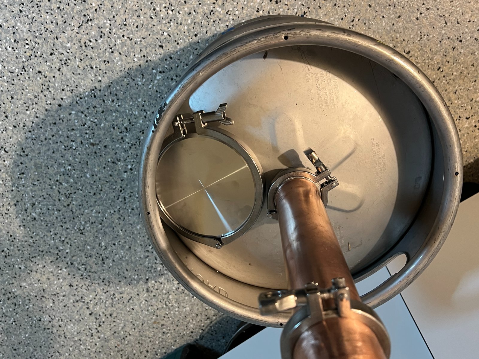

Getting closer!
I just received the 5 inch ferrule and it just fits. A local metal fab operation will cut the port and weld the 5 inch on. I don't have the equipment to do that, Thanks to all of you who steered me away from my idea of the large hat style cover.
Still have to remove the label
It doesn't get much simpler than this.

deanodeano, It looks like you really need to cut the brim off of at least the front of that keg otherwise that 5" ferrule can't be welded to the top of the keg. There just isn't any physical access to weld it without cutting the brim away. That takes a decent amount of cutting, grinding and finish grinding to remove any rough edges. Doing that will allow that 5" ferrule to be moved away from the 2" ferrule a bit to make enough room to remove and reinstall both clamps. If the ferrules are too close, you just can't install both clamps. There's a recent thread here where a guy had his ferrules welded too close and had to grind material away from his clamps to make them thinner so that they can be installed & removed. It's going to cost money for someone else's time, but it is absolutely necessary.
In the future it pays off to buy some basic tools like an angle grinder. You could use hand files, but I bought a cheap Die Grinder & air compressor and that makes doing all of this work very easy. Once all the work has been done, I then take parts to a local guy to TIG welds for a very good price. That way I'm only paying for the welding, not any of the cutting, grinding and cleanup work. The tools pay for themself real quick

Looks like a still Dean!deanodeano wrote: ↑Thu Jan 25, 2024 3:45 pm Getting closer!
Deffo need part of the chimb cut away with that big port though, for practically and aesthetics.

Thanks everyone. As I mentioned, I am going to have a local metal fab shop install the larger port. They will do a much better, and more elegant job than I would.
Also @Salt Must Flow shared this picture of his boiler with me a few post back. While I am keeping the original 2 inch port, the 5 inch will be installed beside it and the upper skirt will be cut away much like what Salt shows here.

I made mine leaving the 2" port and adding a 4" port at the edge of the top.
I wish I had made it with the 4" in the center and added a 2" beside it.

My keg and 5 inch are out for fabrication....should have it back this week

Deano, just a thought.deanodeano wrote: ↑Sun Feb 18, 2024 12:44 pm My keg and 5 inch are out for fabrication....should have it back this week
Have you checked the clearances of the two ports with tri clamps on?
I know that binding can be a bit of an issue
Good luck and looking forward to seeing it done

@Sporacle, great question! Yes, I did a rough check the clearances, and I left both tri clamps with the fabricator so he could test any fitment issues.

Just got pics from my fabricator. I am out of town and will pick it up on Monday. Pretty cool!

Your fabricator done you well looking at that.
Nice
No worries with clamp spacing .
Good call Sporacle on the precaution .
Nice

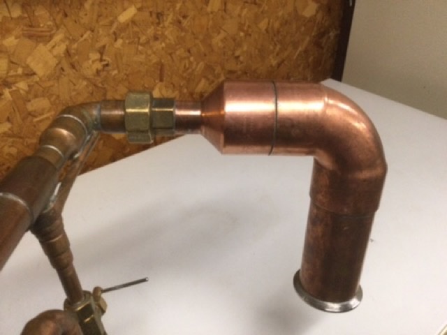

Reconfigure that last bit of 2” copper so that it won’t hold a puddle of liquid just before it reduces to your Liebig condenser. As set up in your picture it will hold a puddle and will cause smearing.
You might try a 90* set up similar to this tri clamped to the top of your riser. It won’t hold a puddle unless the whole still is tilted toward the 90*. You can see what I use for the Liebig swivel.

If I put a significant wedge under distillation keg, I can achieve a slope that should reduce any puddling?
What do you mean when you refer to “smearing?”

The picture you are referring to was a general working mock up

He's referring to the 2"x 1/2" reducer and it's potential for vapor to condense (due to passive reflux) and pool/puddle at that location. Throughout a run that pooling product is said to cause your cuts to smear from jar to jar. It's always ideal for all vapor and any condensed product caused by passive reflux to continuously exit the still. It's probably a relatively minor "issue", but worth pointing out.
You could prop your keg up on something higher creating a steeper angle with your Liebig condenser therefore product cannot pool in that location. Another way is just use a taller riser which would create a steeper angle with your Liebig condenser too. I use a very tall riser so I can collect on a table or counter top with my boiler still on the floor. I hate the thought of squatting down and collecting on the floor.

I had a look at your mock up and you have the ability to rotate the still head to bring the Liebig condenser to gentle slope. This will also reduce the potential for pooling in the 2 1/2 inch reducer area but it won’t eliminate it.deanodeano wrote: ↑Tue Mar 19, 2024 3:23 pm The picture you are referring to was a general working mock up
Smearing always happens, especially in a pot still. But any pool of liquid in the still head will cause more heads to smear into your hearts as long as heads remain in that pool. Or hearts into tails. You just want to be able to control the smearing of heads hearts and tails as much as possible. Small collection jars allow you to blend back in what you want to keep after a run. But it only really works if your still is running clean, as in smearing as little as possible so you have collection jars with distinct differences.
If you position the 2 1/2 to 3/4 reducer so LIQUID runs back into the still and ONLY vapor goes into and down the condenser you will reduce the amount of smearing. This will give you a larger hearts cut.
As stated elsewhere a taller riser will also allow collection at table or counter height. That is handy! My pot still riser is often made up of several sections to get the condenser outlet to the desired height. A sight glass or two 4” x2” reducers for a foam break all add height.
