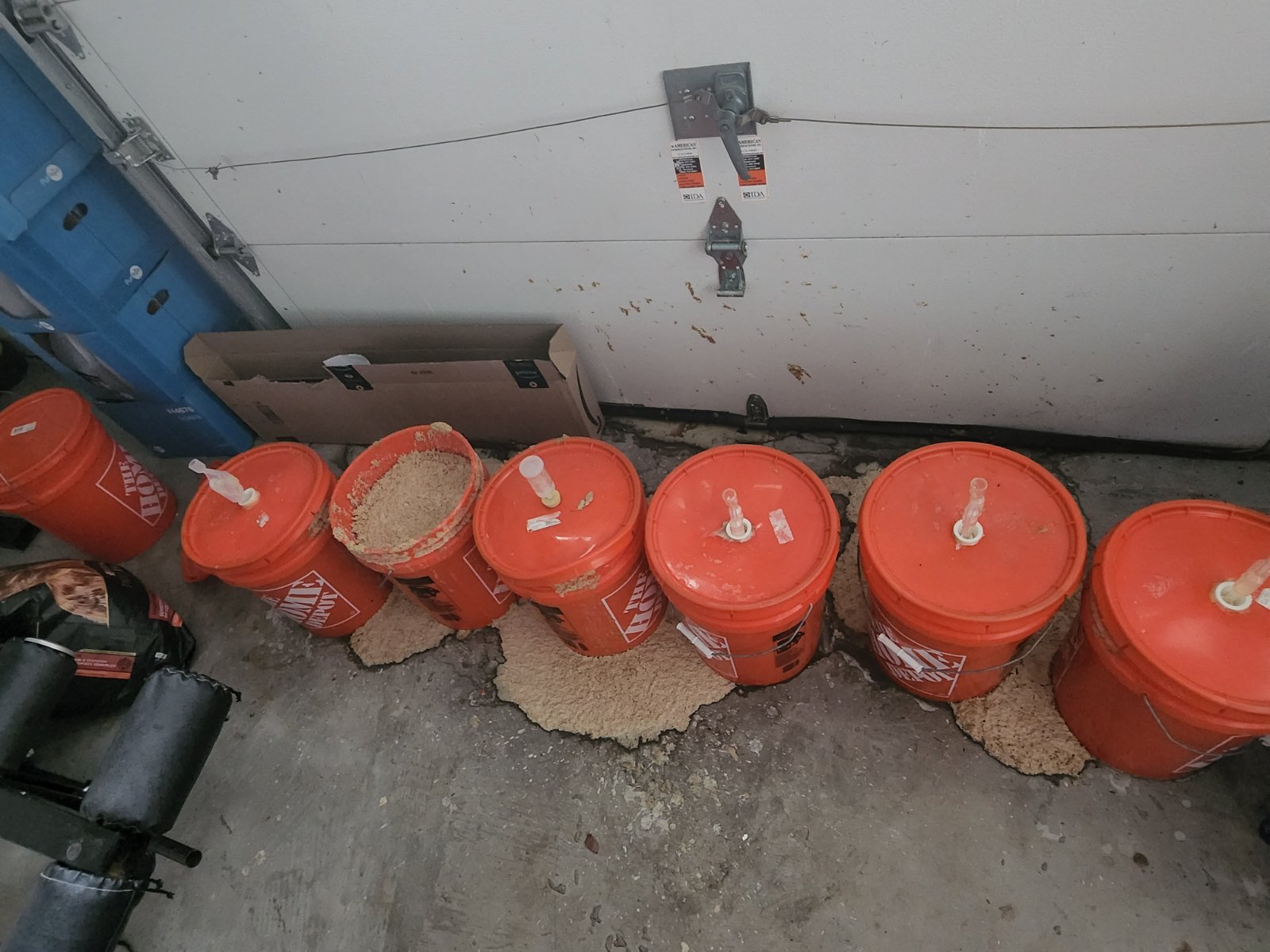

Did leave enough head space for my oat mash good news the hose is right round the corner

Nap, on the head space..
From what the picture indicates, the starting Ph was possible to high, and the mash looks quite thick.. a high starting Ph (anything over 6.5) will cause more foam.. cap should not raise more than a inch if the Ph is right..

The mash started super thick the ph was a hair over 6 though I had added some backset from a previous run that normally brings it down into the 5.8 range I willhave to pay more attentionto this I guess. In the end it finished out normal. I stripped it over the weekend and ended up not losing very much.StillerBoy wrote: ↑Tue Aug 16, 2022 6:26 amNap, on the head space..
