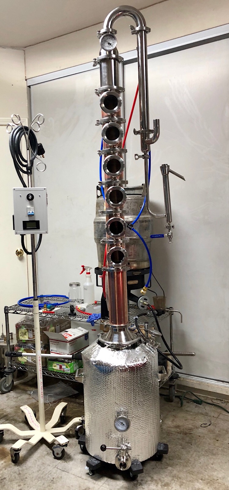

Somewhat new to this site and new to the hobby. I’ve lurked here for a couple years now and read this thread in it’s entirety including every other thread I can find on this subject and others. I’ve assembled a modular 4” flute with 6 bubble plates. I’ve also got a 12” straight section for packing with copper mesh. Reflux cooling is a 4” dephlegmator and the product condensor is a 2” shot gun condensor. Both with seperate water inlets. I have needle valves on the hot side of the condensors and a bypass for the dephlegmator so I can run it at full cooling with the turn of a knob without touching the needle valve. It sits on a 16.5 gallon boiler with a 220v 5500w ULWD element controlled by my homemade SCR based controller. I went with the modular flute because I wanted something modular and really flexible.
I’ve attached a photo of the rig just prior to the cleaning runs with the 12” extension below the bubble plates. The 12” extension would go above the bubble plates when used with packing. I have 3 pounds of copper mesh (3 rolls) for the extension. I’ve also included a picture of the needle valve setup with the bypass for the dephlegmator Cooling will be recirculated using a 55 gallon drum and topped with cold water as needed and or a bit of ice to keep the coolant water temperature down. I know some don’t like the ice idea though I am not quite sure why. I will likely add a spray bar to the effluent side of the condenser lines where they enter the holding tank and a sheet of rigid plastic or FRP sitting at an angle in the top of the coolant tank so the warm water from the condensors is spread/distributed across the sheet and run into the coolant tank at a slope with a fan blowing across it for evaporative cooling. My hope is that will help reduce the coolant water temp as it returns to the holding tank.
For neutral runs, I’d like to get as close to azeo as possilble. From my reading, it sounds like I’d need upwards of 60” of packed column above the 6 plates which really insn’t realistic since I don’t have the available height. It’s already pushing 93” on the little roller stand which makes it a monster in my eyes. I’m also afraid my boiler will be too small (if it isn’t already) if this thing grows much more. I can add another 12” section to pack with additional copper or something else. I could reduce the number of bubble plate sections and add a longer 4” stainless spool.
Edit: Another thought was to remove the bubble plates from the sight glass sections and add a role of copper mesh to each section but I’d be afraid that could result in channeling.
Ultimately, I’m looking for some advice that will get me close to azeo if I want to run some really neutral stuff. The other option would be to build a different column but if I can get close to azeo using what I have with some minor mods, that would be ideal. Any advice would be greatly appreciated.
- HDNB
- Posts: 7427
Re: FLUTE TALK
Height for one and done, but you can use water to scrub it clean too. cook some strips to 40%, load it up and run to as a high as abv as you want. water it down and do it again. even if you don't hit azeo, it will be clean, clean, clean.

- pfshine
- Posts: 3106
- Location: Vegas
Re: FLUTE TALK
Seeing as your rig is modular you can pull the plates and add copper mesh to it. That should make a nice clean drop.
- Posts: 73
- Joined: Sat Mar 03, 2018 10:09 am
Re: FLUTE TALK
Thank you both for your replies!
That said, if I were to pack the sight glass sections with copper mesh, the mesh I have is in 5” tall roles. The sight glass sections are about 6” tall. I assume, I would want the copper stacked tight on top of eachother without gaps between the rolls? Then comes the big question of how many plates to run and how many rolls to stack. If I ran 2 plates, It seems I could get 7 rolls stacked tight on top of one another for a total of 35” of copper mesh (including that 12” add on section) along with the two bubble plates. Or should I just ditch the plates all together for neutrals in which case I could get 9 rolls of copper mesh and still have about 3” between the top of the mesh and the bottom of the dephlegmator. I think I already know the answer to this (no plates) but the feedback is appreciated as I am going to need more mesh since I only have 3 rolls right now.
I’ve only got another foot or so before I hit the ceiling. Not sure that would leave me enough room for the pulleys to hang the damn thing from. I am however planning on stripping runs but would prefer to not have to redistill multiple times beyond a strip followed by a spirit run in large part due to time and energy costs. That is always an option though.HDNB wrote:Height for one and done, but you can use water to scrub it clean too. cook some strips to 40%, load it up and run to as a high as abv as you want. water it down and do it again. even if you don't hit azeo, it will be clean, clean, clean.
That’s kind of what I was thinking. I just spent a fair amount of time reading through the lava rock threads as well. That would be really easy and cost effective option as well. Seems others are having very good results with that stuff too though I do like the idea of copper unless there is a very compelling reason to run some lava rock instead of buying additional copper mesh.pfshine wrote:Seeing as your rig is modular you can pull the plates and add copper mesh to it. That should make a nice clean drop.
