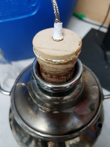

Max_Vino wrote:Hi Fulls and Salty,
I have a few questions for you based on the Davis Patent. Here are some patent quotes and my questions.
My corks deform over time and I have had runs where there has been very little pressure (or none) because of the poor fit, but I don't have a separate control for adjusting it.
This usually results in some Angel's share, but it doesn't have a negative impact on the product.
Haven't done the wood washing.
