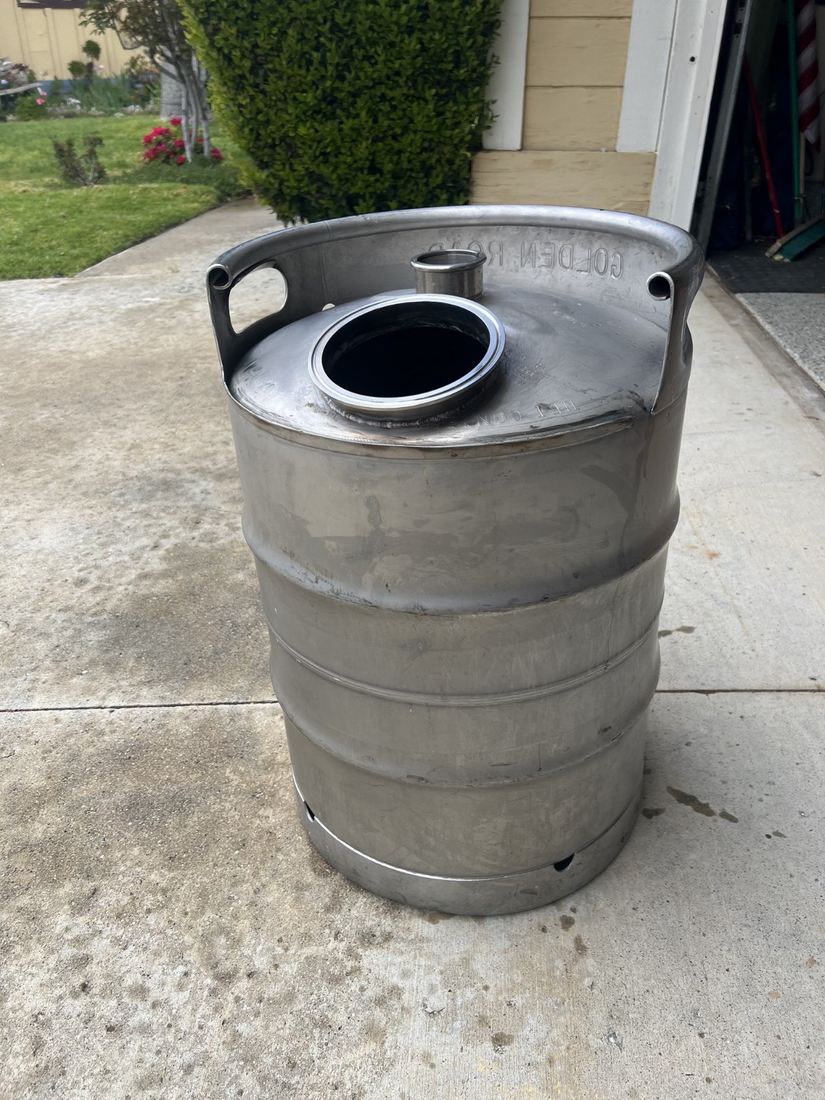

I removed all of the ugly label pretty easily with a paint and epoxy stripper. Painted the stripper on and let it sit and let it do its work.
Am still hoping to get at lease the vinegar run done today, but we keep having storm cells blow through with rain, thunder & lightening. Not conducive to running a propane still

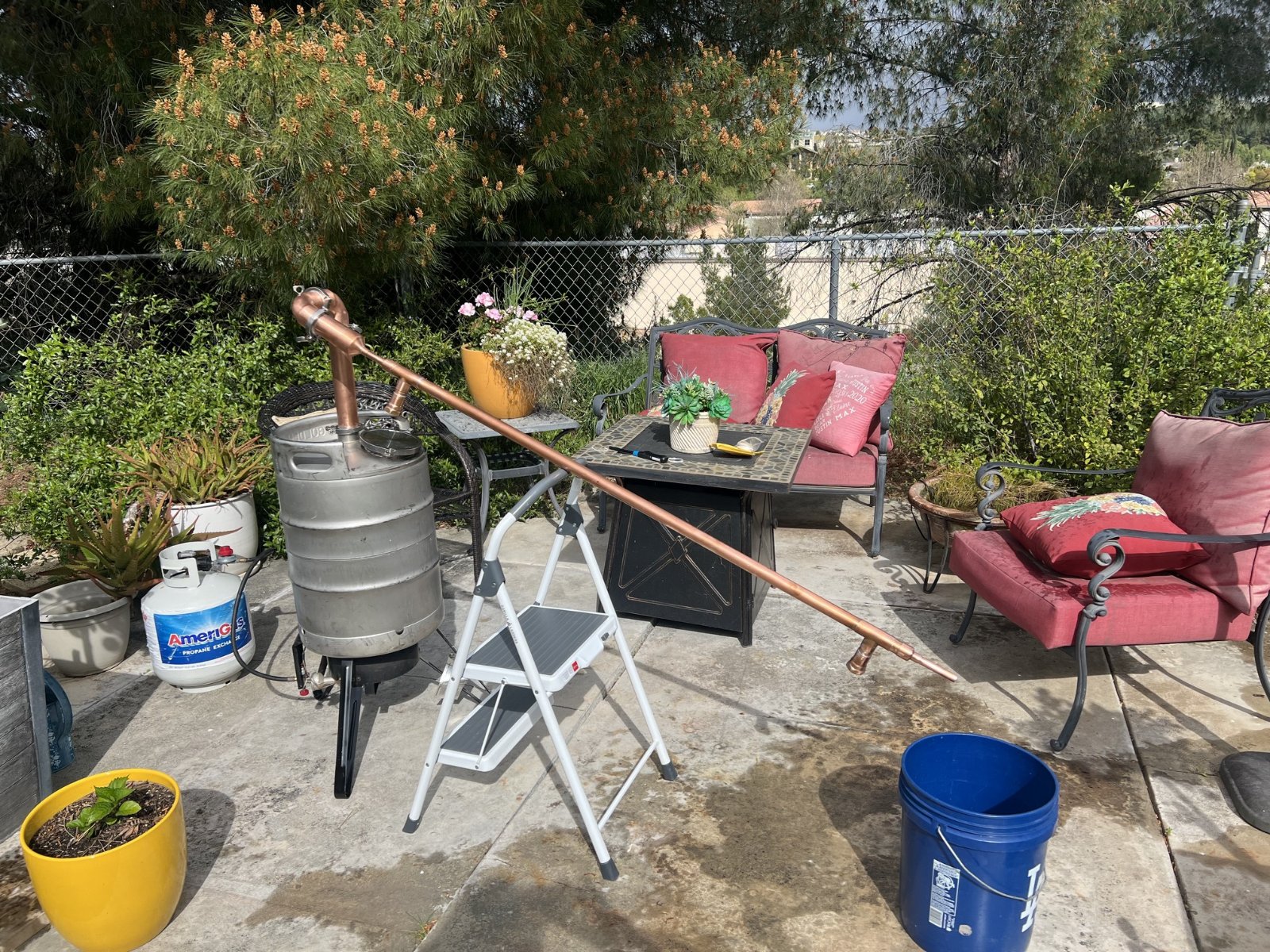

Vinegar run is under way. As I think Andy Stanton mentioned, I am just letting it blast through without hooking up the water source to the condenser for this run.

Good to see you getting started Deano.
Now the vinegar run is done, either get the sacrificial run done really soon, or give the boiler a very good clean out with water if you didn't already.
The acetic acid from the vinegar clean can start attacking metals if you leave it in there to go dry.

More so the still head . If you haven’t rinsed it already , have a look inside it . I bet its going green already .deanodeano wrote: ↑Mon Mar 25, 2024 8:30 am Thank you Mooseman! That makes sense. I did not know that.

Personally, I like to design everything so a brush and soapy water can clean inside everywhere possible.
Especially the areas that have been soldered or welded.
Not as the only cleaning but in addition to the normal sac run protocol.

I meant to say still, sorry, not sure why I typed boiler.
The copper in the riser and condenser will be what gets corroded, not the boiler so much.
Now shady mentioned it, a good few pull throughs with a clean white rag on a string will tell you if the evil green stuff has appeared.
That same rag can then be used to get it cleaned out before you do your sac run.
