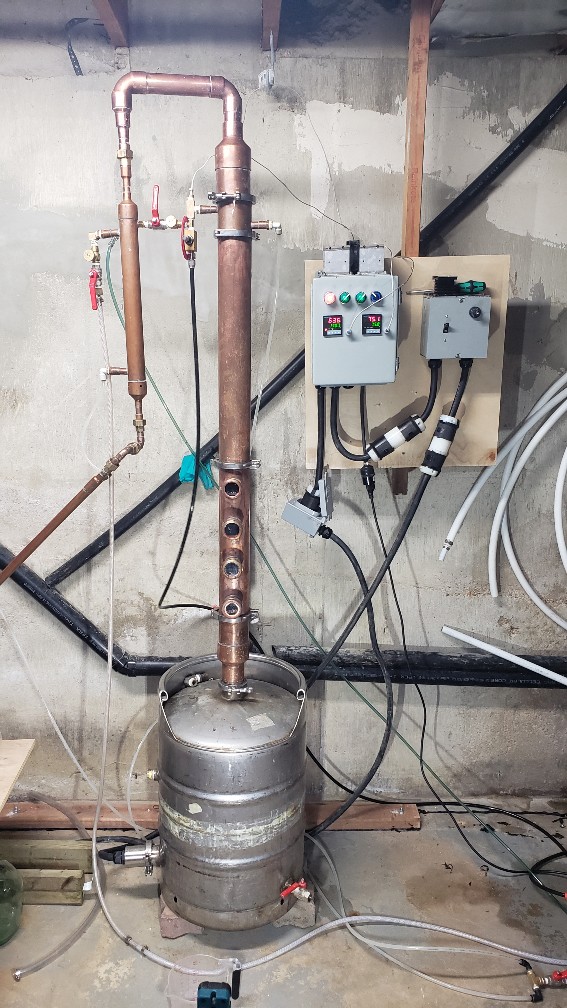

This is what I've built, 4 plates and packed section. Not all of it fit under ceiling in my basement (still too cold in garage)
Gives me 95% if i run slower but @93-94% i can collect almost a gallon an hour
Was doing an experiment, hooked up a DCV to output from dephleg to control temperature above dephleg, worked good for some time but then I realized it was a waste of time. One thing i did find useful from experience is temperature of water coming out of my dephleg - in my case 60°C is the magic number to have a steady frow of product and good compression of tails.
P.s. controller is for brewing, I always use SCR which i recently replaced with ssr+pot, just wanted to see temps and only had one plug in basement.

6- the only time I really go into full reflux is the end of the run, if I want to squeeze a little more out of the tails. you can tell by taste, and the bubbles will look flat and not as lively.
---Other things that will affect your run, which you didn't mention is, wash ABV,(strip runs in the beer, straight beer or all strips) and how many plates your running. More plates, higher ABV.
Personally on a clean, all grain run, or strips, I like 2 plates. With anything dirty, like failed beers, 3 plates.
Hope this helps..
2-Don't try to over power the deflag. With bubble caps, I look for lively bubbles just above the caps.
3-Don't worry about equilibrium too much in a bubble column. It's not a packed column, the fractions will only compact so much. I think a few minutes is all you need, or even just run it slow as your pulling off the heads is enough.
4- Don't run foreshots/heads that slow. Slower than the hearts for sure, but not too slow. Again, it's not a packed column, It's only gonna compress so much.
5-It's a balancing act. Figure out what's best for your rig, more heat, or less water to keep the plates loaded, again, nice lively bubbles, just above caps.
Hope this helps..

As stated it the post above .....not necessary , you can start milking fores off at a slow/fast drip almost immediately.BrewinBrian44 wrote: ↑Mon Feb 15, 2021 5:52 am I leave it sitting in equilibrium for 30min then turn down the defleg to start pulling off spirit, takes like 10min for the vapor to warm up the tubing to the condenser.
BrewinBrian44 wrote: ↑Mon Feb 15, 2021 5:52 am When the heads seem fade away, I crank up the defleg to full blast to restack the plates for like 10min,
Not sure why your doing that ?......plates should be loaded and ready to go , why do they need reloading?
My experience is that , that is the sweet spot for any 4 plater......that is where they are happy to run, trying to force them to run at lower ABV is a pain in the ass in my opinion and usually doesn't result in good.BrewinBrian44 wrote: ↑Mon Feb 15, 2021 5:52 am This still basically wants to collect at 91-92% ABV as a default.
If you want lower ABV use one or more less plates.
Everything else you are doing seems to be right ......I cant see why you would be getting that many heads jars. Plated columns by their very nature compress all of the fractions to a greater extent than a potty.BrewinBrian44 wrote: ↑Mon Feb 15, 2021 5:52 am Here’s the rub: I wish I could “compress” heads more. The amount of heads jars I see is still similar to the pot still, no matter how slow I run it. I’ve tried going at a snails pace and the only thing it did was extend the run.
- Posts: 729
Re: FLUTE TALK
Thank you both for the detailed feedback! Looks like I’m overdoing it with the full reflux steps throughout the run. Good to know I can start drawing off fores almost immediately. This advice will speed up my run quite a bit!
In regards to keeping the plates loaded, it seems like no matter what I do, they’re always loaded at the same level, even with barely a trickle from my defleg. I guess this should be a good thing, but makes me confused a bit. Should I run more power and more reflux or less power less reflux? Both can options will yield the same takeoff rate. I suppose I’d be saving energy by providing just enough power and reflux to keep the plates loaded and takeoff at a decent rate. The way I’ve been doing it the last couple runs is to have a trickle coming out of the defleg with hot water coming out.
As for what I’ve been making, it’s been UJSSM for all my runs so far. I’ve done spirit runs from pot stripped low wines and also one 10gal single run which actually turned out awesome.
I’ve been mashing large batches of Honey Bear Bourbon and I’m about to have 10gal of 28% low wines for my very first AG spirit run with this column. There’s soooo much flavor packed in these low wines, I’m afraid I might strip flavor with my 4 plate setup. I was thinking about going down to 3 or maybe even 2. I’d love to hear your guys’ thoughts on this.
Thanks again!
Thanks again!

Ifn you have gone to the hassle of stripping it, and are worried about flavour loss, do a potty run
- Tummydoc
- Posts: 979
Re: FLUTE TALK
Don't do a stripping run if you want flavor with a plated column. I run the mash on 3 plates as a single run. 2 plates will give you flavorful 160 proof liquor. Pot mode strip/spirit is most common for whiskey but with my setup (no drain on a keg boiler) that's 2 days whereas with a plated column i can run in one day, but its a slower run.
- Posts: 10593
Re: FLUTE TALK
I agree that there is no need to run low wines with a plated column, run straight wash for more flavour, that's how they are made to run, 4 plates is a good starting point for UJ in my opinion..many run 5 with UJ and what Ive tasted of that, has been good, yet others run 3 plates for UJ. Its all a personal things ...gotta experiment and find what suits you.
- frunobulax
- Posts: 634
- Joined: Mon Dec 17, 2012 3:23 pm
- Location: Sunny N.J.
Re: FLUTE TALK
Running stripped washes is why your ABV is so high, along with 4 plates. Like everyone mentioned, plates are great for 1 and done runs.
I would take those strippings and add them to your next beer, and run it on 2 plates.
***2 plates is just my personal preference.***
