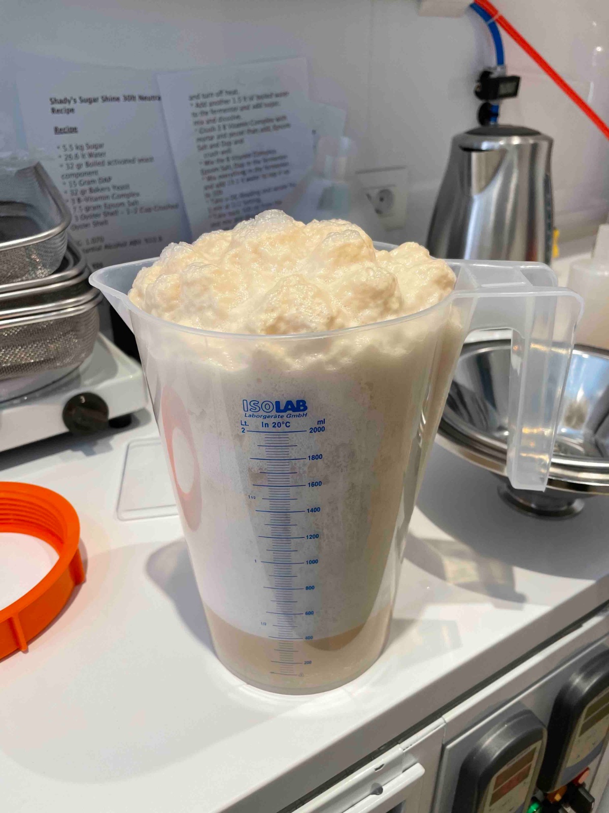

Shady,
Thanks again for this awesome recipe, this is my 8th and 9th batch together, now this is my base spirit for all my gins :)
I am doing 2 batches each 30 lt
The Yeast Monster :)
