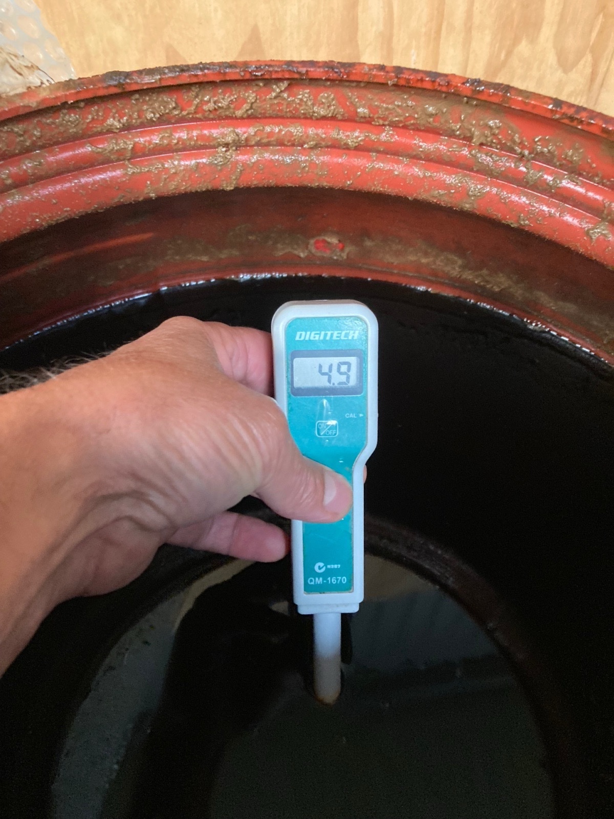

It does drop , but typically less than 0.5pH
I just checked my latest Fermentation . It’s been sitting there for over a week now .I just recalibrated meter prior to testing .
To be honest I did not check it before the fermentation started . But I might . I have moved to Queensland and the Molasses comes from a different mill to the stuff I’ve been using down in New South Wales .
This is a post I made in Saltys Rum topic last year . In that post , the finish pH was 5.4
To be honest , I can’t remember if I calibrated meter before I checked that one . Looking back , it does seem a bit higher than I normally got .
viewtopic.php?p=7740724#p7740724
