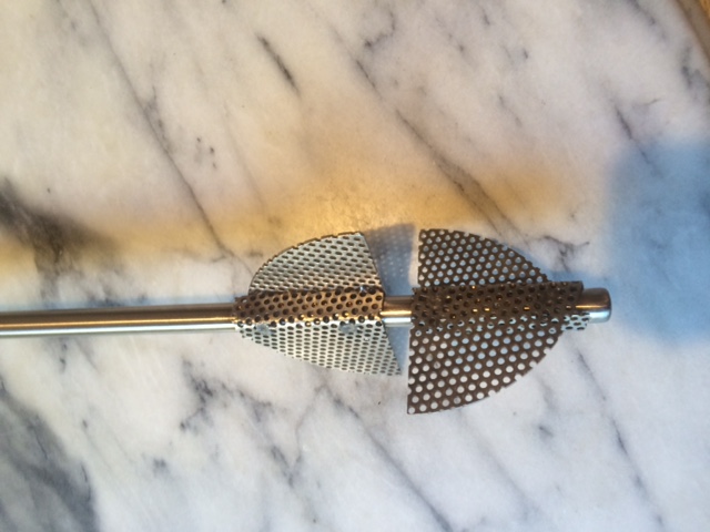

Destroyed a home depot and a harbor freight paddle - spent the money on a real paddle from nor cal, just got it today

When it arrived I wasn't so sure about it, thought that the blades should of been bigger. 50Lbs of cornmeal, 10Lbs of flaked oats (the brew shop didn't have enough malted) - that paddle did the duty on those grains, so I think that I'm happy with it. After adding he malts sitting at 1.07 waiting for temps to cool to pitch the yeast, once again this has been a repeatable recipe for me

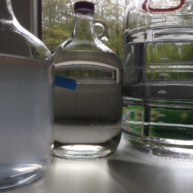

I took the Honey Bear plunge. Three mashes this weekend, using 50% more of everything than the original recipe to scale it up. This is a nice size for my 10gallon mash tun. I added a pound of oats to the first two, not to the third. Now I have 25 gallons bubbling in my Brute fermenter in the basement.
Smells fantastic.

SCD, the cap fell yesterday sometime, and it tastes dry. I'll probably measure gravity tonight, and if it's ready, start squeezing. It's been pretty warm lately, and the ferment was fast.
I have some time this weekend, and I'm hoping to get it stripped. Got some other projects going on too, including building a deck, so time juggling is required......
EDIT: Still some bubbling, and gravity measures somewhere around 1.009. I think I'll exercise some patience and give it a week.

Well work and the week got away from me. I was able to squeeze from the grain tonight and recovered about 17 gallons, with another five gallon bucket full of grains. In the time I let it rest, the gravity had dropped to about 1.007, but likely due to a starting lacto infection. Also picked up a distinct smell of bubblegum in the headspace of the fermenter. It has a sharp but very pleasing sourness. I anticipate something special.
Will be doing stripping runs this weekend. If I'm lucky I'll get all three done.
