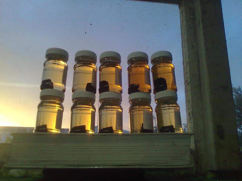

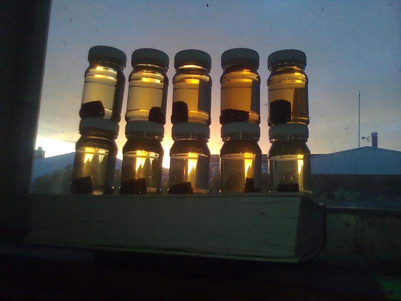

Day four and some marked differences are emerging... If a mod feels this is cluttering up the wrong thread feel free to move it, or just tell me to shut up and I'll post it all when I'm done.
On colour, for a start, the charred, on average, is significantly darker and redder than the toasted. I've tried to snap a few pics of the range with a crappy cell camera, with the setting sun as a backlight. The arrangement is charred along the top, toasted along the bottom, 50 abv left, 70 abv right, 5% steps.
another with more backlighting and contrast
The camera seems to (as compared with the naked eye) make the center jars darker. difusing the light with opaque plastic seemed to help a little:
As you can see all the oak is now sunken. Anyway, the darkest jar to my eye (in real life not the pics) would be a dead tie between the 65% charr and 70% charr. Very hard to tell the most colour toasted as yet, but I'd have to say it's probably a tie between 60 and 65%.
It's really way too early to talk about taste and smell, but I opened them up anyway :lol: the best, by FAR is the charred 70%, which is very strongly vanilla. the 65% charr, slightly less so, and all the other samples still just taste like slightly woody white dog. Needs more time. but they looked really pretty in the sunset :)

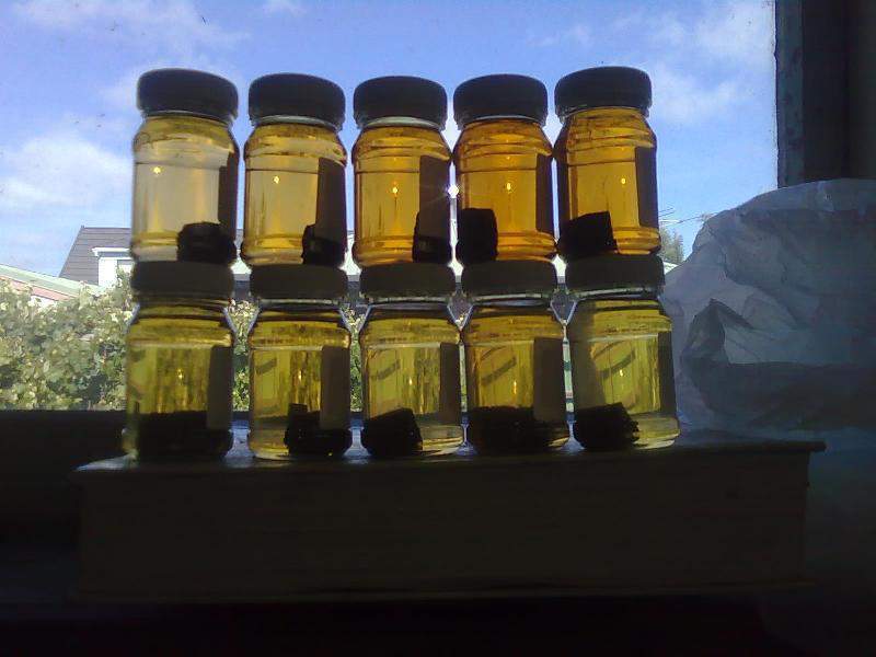

update on the oaking...
pic from the 5th
pic from the 7th
It's very hard to tell between the toasted samples by sight. the charred are dramatically different, even more to the naked eye than through the camera. the colour in the higher abv charred samples is just fantastic. very little variation in the toasted samples, I couldn't really tell them apart with the naked eye.

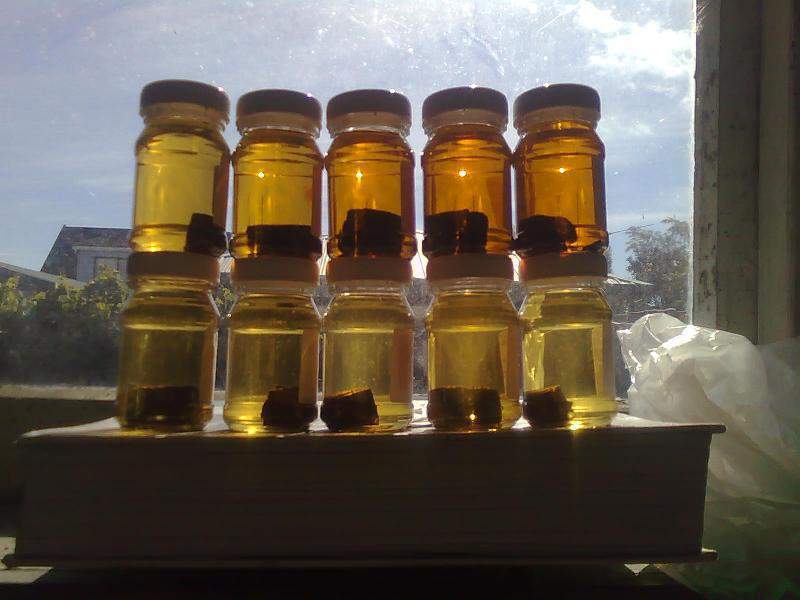

pic from the 9th. Day 10.
damn those charred ones are looking good. I reckon the best colour is the 65% char, but the 70% char tastes better. the best tasting toast would be 55-60 still.
quite cool how there is so much more contrast in the charred oak across abvs.

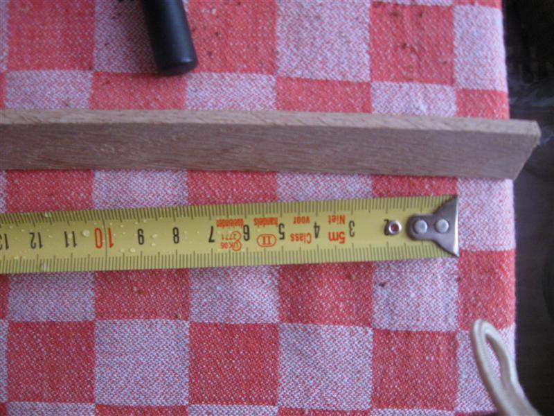

Next time I will take some pictures of everything. No cam here now say I will try to describe.
I use very thin sticks (would like them bigger, but they were a gift so no complaining) of around (and now I'm really guessing) 0.3cm * 1 cm * 5cm. I now have 2 in 1L, because they are very thin, but because of the rapid effect I will reduce to 1. Do I over oak?
They are wrapped in thin foil and toasted at a temperature higher then 200 degrees Celsius (i cant really control the oven, its on or off....) for about 1 h, 1.5 h. I tried one batch with light charring, and it takes color on even faster.
I oak on around 65% abv (what comes off after a thumper run)
I'll try to post photo's when i'm home

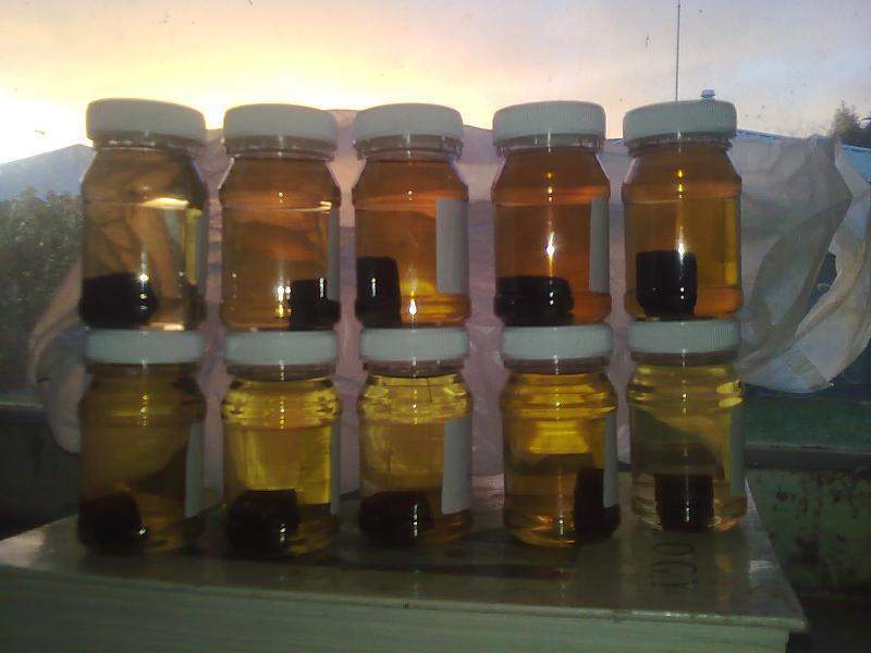

Pictures as promised. So these are on oak for 1.5 days. I oak small batches, well because I don't need that much. These sticks are about 7 cm long. Could be I'm using too much oak?
Sticks I use (untoasted) with bar in cm
1 Liter jars with UJSSM, first generation with backset. 65 % ABV, 12-12-09. On the left only toasted in the oven, 1h at 200+ degrees Celsius. On the right toasted and then lighly charred with propane torch.

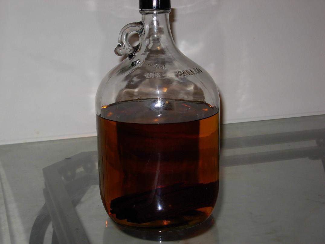

This is my oaked stuff after 2 weeks. Sitting at about 62% ABV
This is 3 sticks..2 new and 1 used...
This is 1 of the sticks i use...used the cutting slots method....
Sticks were made in the oven at 400 for 2 hours wrapped in foil.
I had tried 4 new sticks but found it to be too much oak so switched to 2 new and a used...finding less = more. It was a full jug but i cant stop "testing" :D
blind drunk
