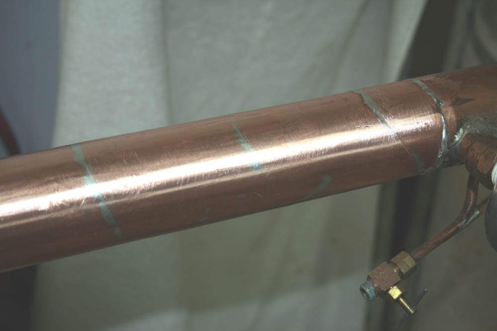

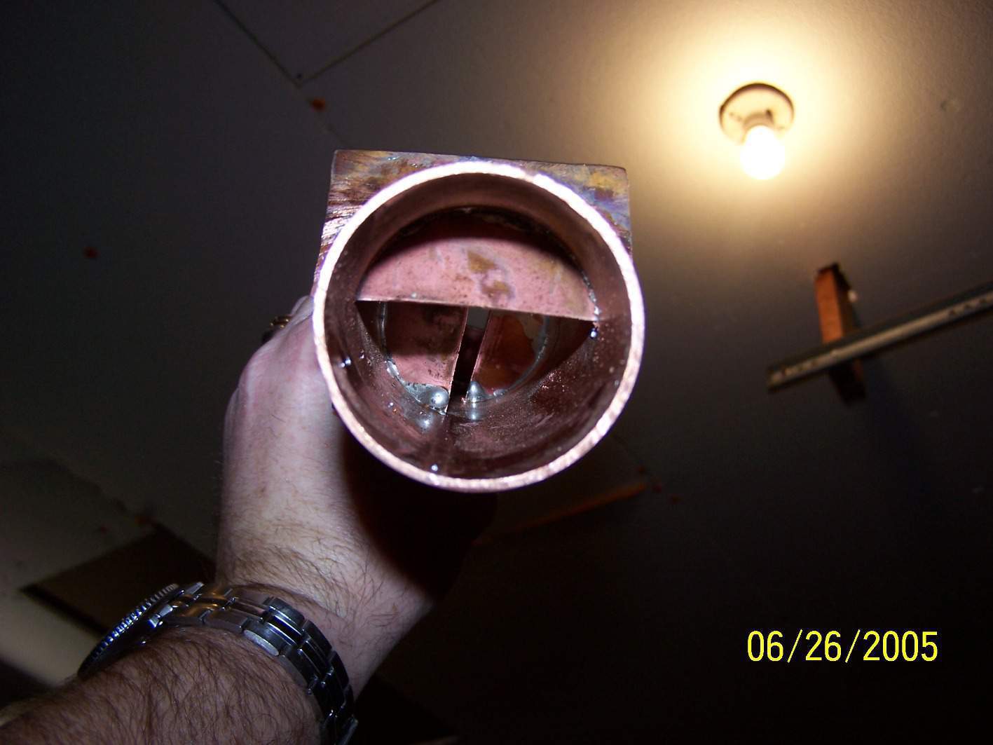

I added 3 plates today, for a total of 7 now. Here's a picture that shows 5; the other 2 are a good ways above these.

Here's my main column, which was once my Bok. On top of this sits another 14" or so of 2" copper before it turns down to the condenser.

Barney yours looks alot better than mine. I must have had one to many when i put the first plates in. I did not rotate as i intended. It is a little short but that is the story of my life (golfing of course). I’m going to start cleaning it tomorrow and hopefully start a wash. What do you think of a rum run for the first time? I have not done rum yet and debating on waiting on ujssm. I'll get some more pic when I have it together. date is wrong on the pics

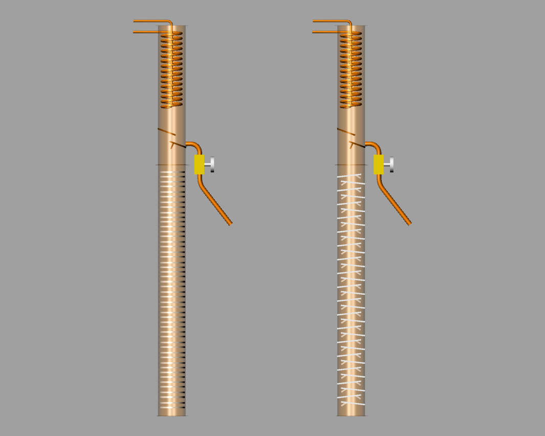

some time ago i did a post on an simple angle plate bubble column idea i had that was sparked by Bokakobs inline condensoe idea.
very simmilar to what you are trying to do, it might help.
the entire column is copper it is just pictured transparent. Here is a angled view showing the perferated bubble plates, the tubes return the reflux to the lover plate when the preset level is reached preventing flooding of the plates.

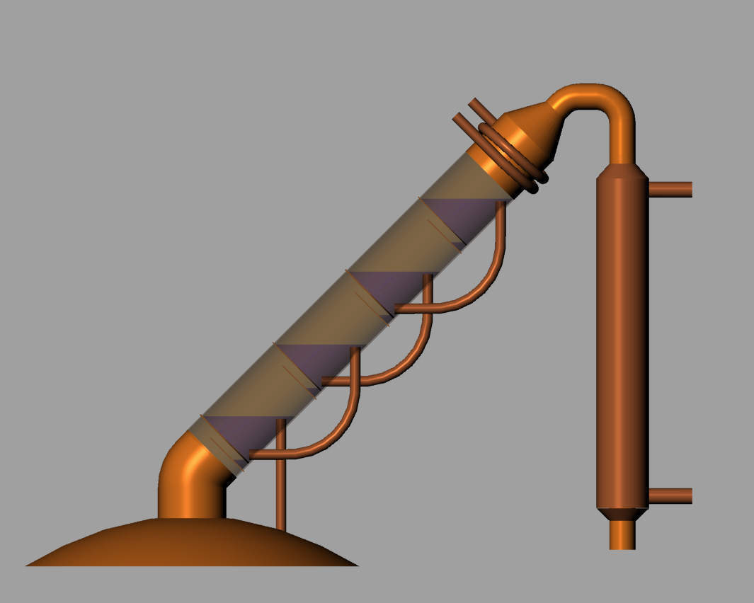

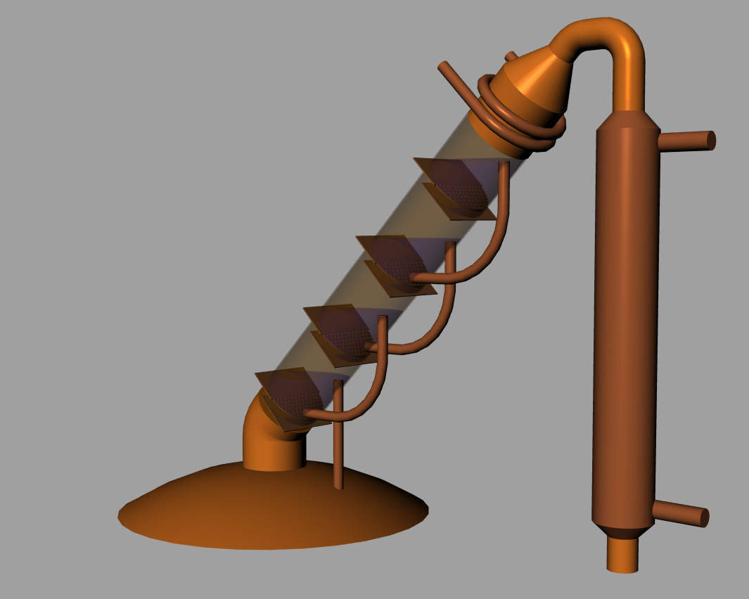

These where my takes based on a pistorious pot still and adapted to a pistorious column stil
again similar in what you are trying to do.
the column on the left is filled with trays pictured in the second photo pressed out of thin soft anealed copper sheet that can be purchased from craft shops.
On the right was an earlier design but i disliked the idea of not being able to pull appart the column for cleaning or service.
The theory of opperation:
I like the idea of this design because there is no back pressure.
As each plate level fills with reflux it over flows onto the level below it, same as the bokakob reflux overflow.
both the left and right side plates in the column are angled up to cup a small amount of reflux at each level, they do not create a Air lock or buble plate!
as the vapour travels up the column it condenses on the cooler surface then returning and suspending on the plate below while at the same time it the heat excahnge evaporates the more volatile liquid suspended on the level above it etc.
as i said no back pressure. close up of the perferated plates inside the column. hope it helps
