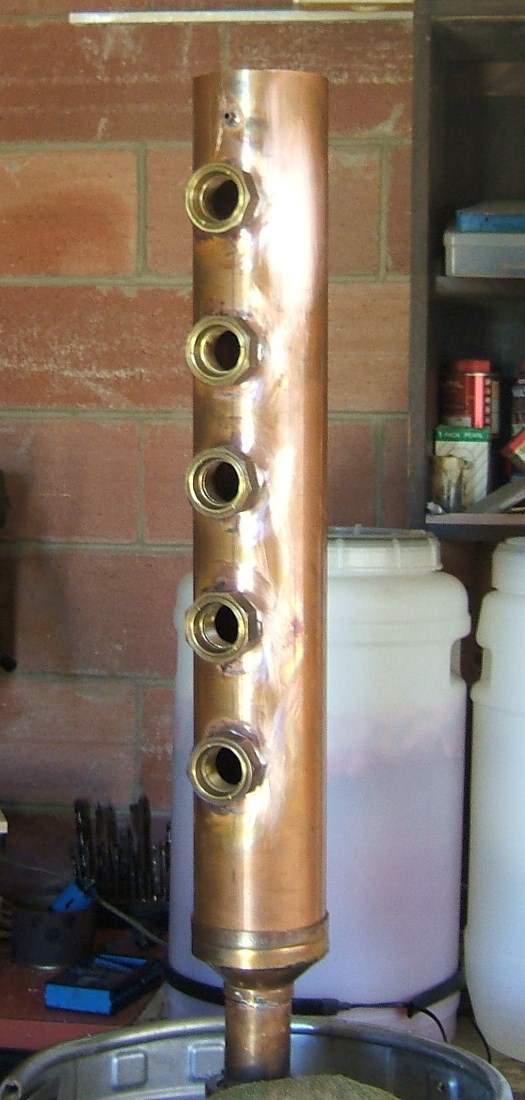

Latest progress on the build
The plate assembly fitted, the 1/4" tube was flattened on the end, which spreads it larger than 1/4", it was then drilled with 1/4" hole, and another piece of 1/4" tube pushed through the 4" wall to suspend the plate assembly, this can be used as a blind thermometer port.
The sight glass hardware now soldered into the column ( without glass ) , the column will need a major clean to get rid of any marks incured during the fabrication.

Wow, that looks soooo good OD.
Looking at the plates I would have used more but smaller holes but maybe looking at it in personal it'll be different.
At the end you can watch the performance in the sight glasses.

Those holes are 1/8" which I understood to be correct for a perforated plate.rednose wrote:Looking at the plates I would have used more but smaller holes

Thanks, but this bubble plate realy looks proffesional.

Looks a bit like a clarinet or some sorta musical instrument. What glass are you going to use? Cheers, bd.

Just curious, will you get enough light through those ports to actually see inside the column ?
Can't think of a name for your elegant creation, although I see an elephant's trunk.

I have to ask. is it my eyes or are the sight glasses out line? Are you going to do a detailed how-to on the sight glasses?
