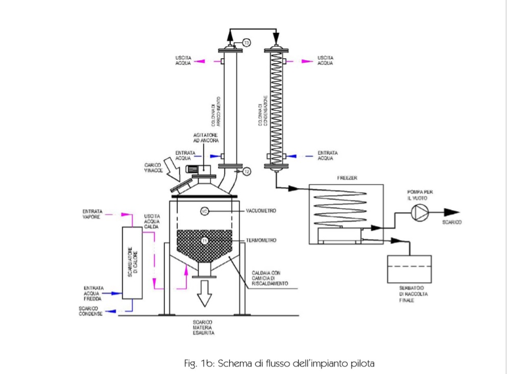

Probably I'm out of topic but, talking about drafts, I'ld like to share this about a prototype.
It's a new kind of distiller realized full size by a big Italian Distillery (Poli). The one described is a 50 liters but with all the industrial components: heating exchanger for steam, high vacuum pump, freezer for still.
Take a look to the column: it's without any plate, the flux is tuned only by the temperature control and the cooling system.
Hope to have some comments by the elders.

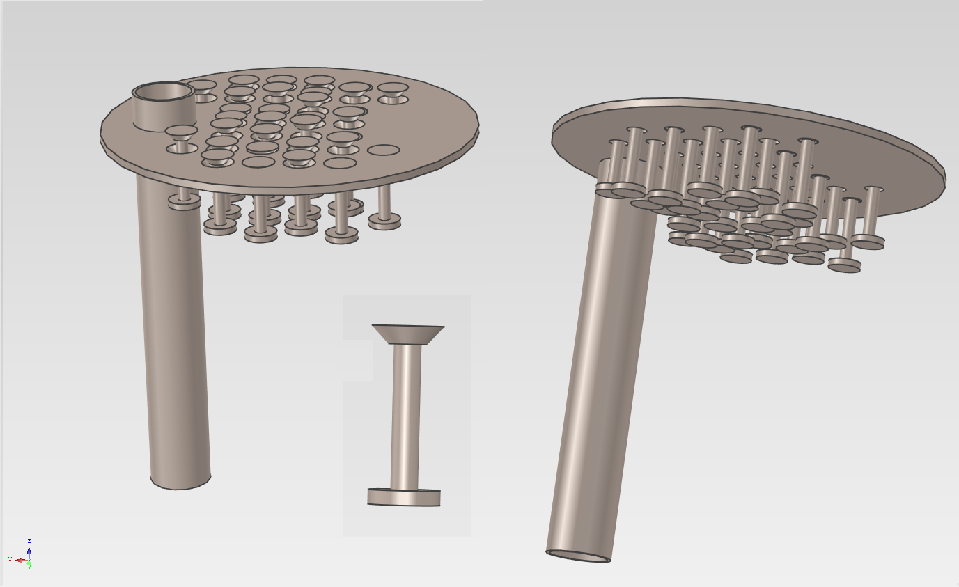

Valve Plate Diagram

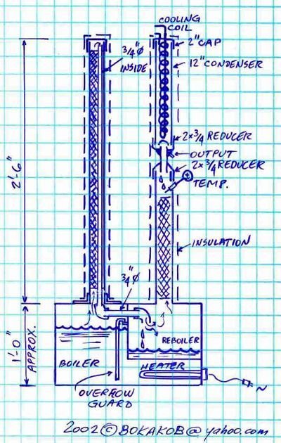

While cruising the internet I found this really interesting older bokabob double column drawing, I'm not planning to build it or anything, just thought it was cool and wanted to share it.
I immediately thought with a few simple modifications this could be used kind of like a small coffey still.
