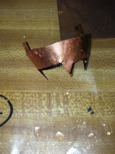

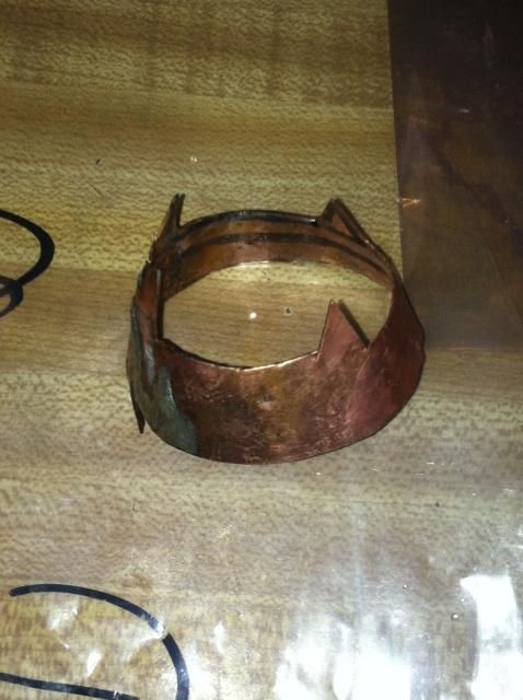

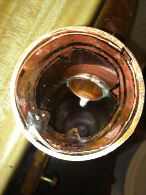

I know I needed a drip ring below the take-off valve to make sure the reflux goes back through the center of the packing, so I built one myself. Here is a picture of it and just for references sake it is sitting in the top of my pot still to show how it will fit in my boka once I get it in...
What ya think?
