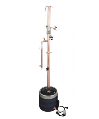

OVM confusion
Post by bunny »
While reading about "Re:SPP source", I came about a link from Dunkydonuts to https://destylatorymiedziane.pl/en/acce ... cking.html
They also make several Polish distillation columns. They seem very enthused about what they are calling "OVM". It appears to be a VM takeoff that is below the sight glass and in the packing "sucking" as they put it very high quality stuff in to this "OVM" through the control valve and down the product condenser.
Any one know anything about "OVM"?

Hi Bunny , I did my darnedest to find the reference to OVM on that link . I see what you were talking about , a VM takeoff that is below the top of the packing . Very strange indeed .I’d expect if you opened the VM valve , there would be liquid in the column ( and packing) that might want to poor out . It’s a strange idea . Do you have a more explicit quote ir link to where the actually refer to OVM ?

I clicked on their "Premium LM/VM reflux still". There is more info below the "add to cart" including a video and fairly long, but confusing to me description. I tried to drag the page over here but I'm not having any luck.
Click on "reflux stills", then "Premium LM/VM reflux still"
Their basic LM/VM reflux still has the VM takeoff between the Boca plates?
On closer inspection I can see a VM connector between the Boca plates on the "Premier" also.

That is an odd still. They are basically saying they have a side draw fractioning column that can collect in vapour or liquid phase at a lower point than the undesirable fractions that will be condensed and collected in the Boka LM top section and that once the majority of this fraction has been collected there will still be an upper headspace that will allow the small remaining amount to collect and hold down the desirable fraction in the lower section and collection system. The "o" in their OVM and OLM is the polish word for "lower" ... so lower VM or lower LM.
The idea that all the volitile heads components will be fully concentrated and collected like cream separating on top of milk and they will some how keep drawing from below without the stratification level dropping.until the hearts are exhausted, and that somehow the remaining undesirable volitiles will bypass the lower draw point and continue up to the condenser while the desirable components will be fully refluxed to 96% purity seems like a popular approach over there. There are various sorts of liquid traps designed to be installed below reflux condensers sold promoting this idea of having a seperate LM draw point above what is usually a VM system.
This concept makes more sense to me in a steady state continuous plated column.
