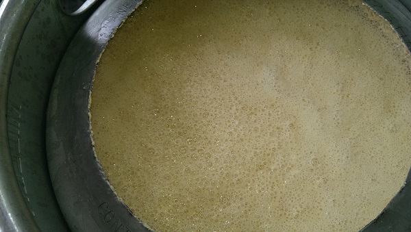

SG 1.06
FG 1.0 may go a little lower
~7.7% ABV
Heat water, turn flame off, NO cooking, no scorching, this is second batch.

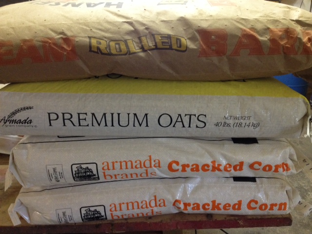

Corn, oats, barley and enzymes.
Sounds like the fun will begin.
Are you going to start by cooking the corn, then adding the oats and barley at their gelatinize temps?
In other words what is the beginning protocol for cooking the starches?

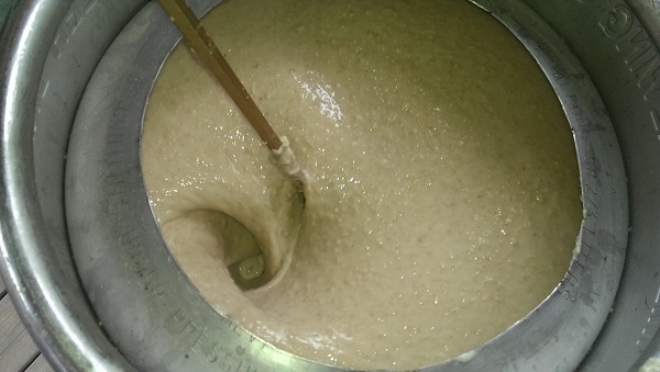

At least for this next batch, I going to cook the heck out of everything unmalted without a husk! (which will be everything in the pile)shadylane wrote:Are you going to start by cooking the corn, then adding the oats and barley at their gelatinize temps?

Putting things in at the higher temps, near boiling gives a better yield than does the lower temps we've read about. None of those grains have has a bitter tannin present to me. My wife always wants to drink the mash so it can't be bad. She's a super taster.MichiganCornhusker wrote:At least for this next batch, I going to cook the heck out of everything unmalted without a husk! (which will be everything in the pile)shadylane wrote:Are you going to start by cooking the corn, then adding the oats and barley at their gelatinize temps?
