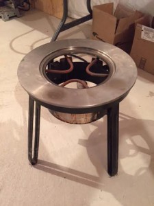

Also need to machine the base for my burner. I've got a big cast iron clutch plate that I got out of the scrap bin at work that I will machine to fit inside the ring of my burner for the keg to sit on. I will post some pics when I get around to finishing up...

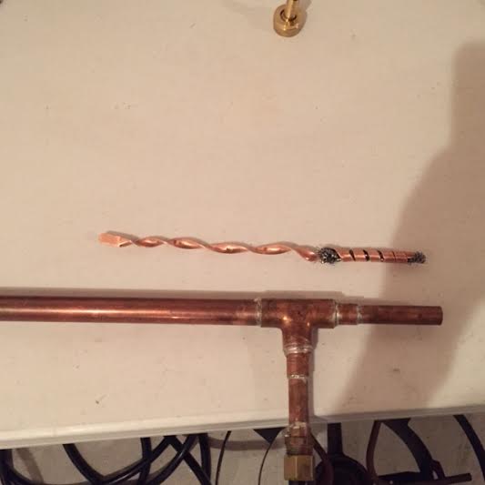

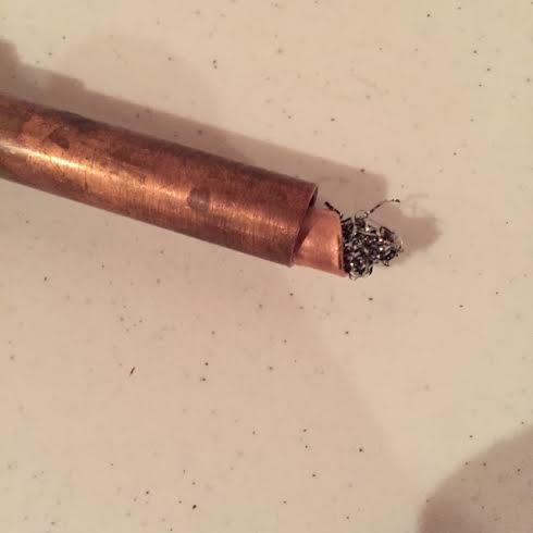

I dd makeshift test on my column with my air compressor today. I put it on the keg put my pot still cap on put a cork around my air nozzle and hit it with air. I d not hear any leaks anywhere, so that's good. I also made up a what I will call a silencer. I have always had to put a little piece of scrubbie in the end of my liebig to keep it from huffing and have read about people putting a spiraled section in their liebig to improve function. Now with that being said I have always thought that mine was more than good enough for the heat I was throwing at it. Mine stops huffing once the temp of the water in the cooling reservoir gets hot which leads me to believe it was actually shock cooling... but anyway I had some free time and some copper so here is my silencer...

- My take on a turbulator for a libeg
- silencer1.jpg (15.58 KiB) Viewed 1378 times

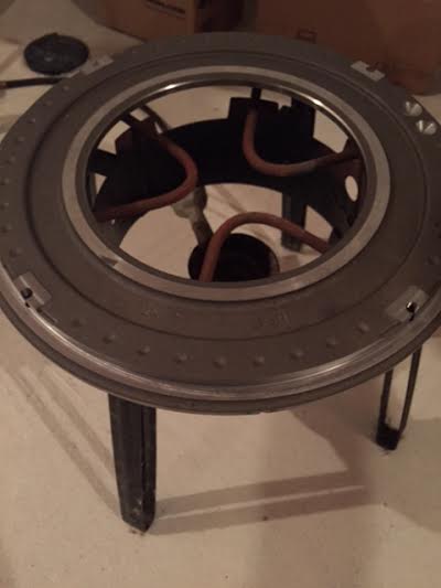

I finally got around to machining the new base for the keg to fit on to my burner. I also used my liebig on another still of mine and the silencer preformed great.
Anyhow here are a couple of pics of the base....

I like the reclaimed clutchbase on your burner.
