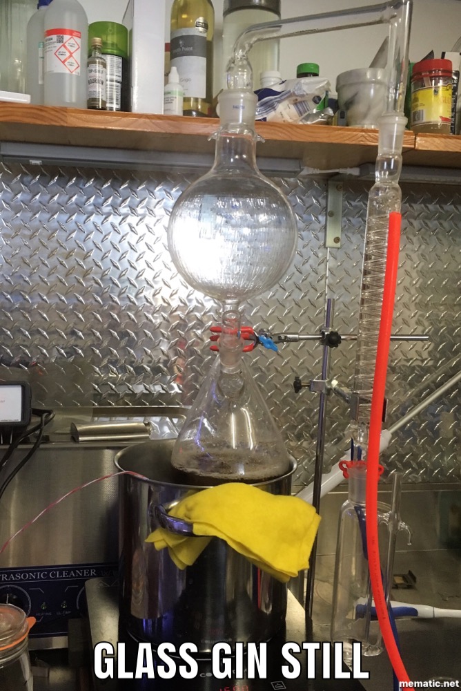

I came across one of these through a forum member elsewhere, it cost me $350 and is great for the last step of gin with botanicals and herbs. It has a 4L capacity.
I use an all copper 5 plate CCSC modular flute for the first step of making base spirit for the Gin.
BTW the Gin recipe is known as stubbydrainer Gin.

That bulb on top of that boiler (bio mass flask) is the same I use to get copper contact with my rig. Cut up copper scrubbies and put them in there and it works great. Acts like a boil ball too. Using a thumper for gin is more versatile. How hot I can run my rig depends on the bath I'm using, the abv of the contents, degree of reflux and the hight of the riser. My liebigs functional cooling path is about 12". In general, a strip done in a sand bath without a long riser I run at a middling heat. I use a propane gas stove for a heat source so a medium low to medium flame. Honestly that runs my wash off pretty fast, 1 1/2 hours at worst once I'm up to heat (45-60 minutes in a sand bath). I gauge by where the vapor stops condensing in the liebig. If I had to I could always connect a second liebig to the first one and run hotter but I can't imagine why I would. If I'm running the heat full blast I'm probably fooling around with destructive distillation and you don't use glass for that. On spirit runs I run the flame at it's very lowest in a water bath and I collect at a 2-3 drip a second rate giving about 85% abv. I'm going to try the vigreaux and reflux condenser thing on my up coming spirit run to see if I can push the abv up higher. That'll amount to using somewhat greater heat to overcome the reflux
