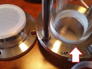

You just needed to adjust the nuts/bolts to reduce the height.rgreen2002 wrote: Because of the big gap between the glass and the housing I had to use the silicone gasket....
Sight Glass fun!!

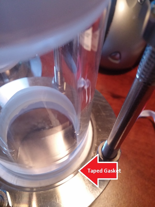

The gap is horizontally between the glass and the stainless. The silicone is thick there and keeps it centered. I think cutting the silicone so it only went around the outside (where it doesn't touch the vapor) would work fine. I myself went the wrapping route for my 4" one. I used a high quality thick PTFE tape and made multiple wraps.choppinlow wrote:You just needed to adjust the nuts/bolts to reduce the height.rgreen2002 wrote: Because of the big gap between the glass and the housing I had to use the silicone gasket....

Snackson wrote:The gap is horizontally between the glass and the stainless. The silicone is thick there and keeps it centered. I think cutting the silicone so it only went around the outside (where it doesn't touch the vapor) would work fine. I myself went the wrapping route for my 4" one. I used a high quality thick PTFE tape and made multiple wraps.choppinlow wrote:You just needed to adjust the nuts/bolts to reduce the height.rgreen2002 wrote: Because of the big gap between the glass and the housing I had to use the silicone gasket....
Correct... the gap is between the stainless and the glass. The picture didn't do it justice.
There is just a very small surface of the taped PTFE that sits between the gasket and glass after tightening the bolts down that is exposed to the product.
Ive so far been unsuccessful in sourcing PTFE gaskets that will fit into here...
The gasket sort of looks like this (without the PTFE ball...)
..but I have no idea what the shape would be called. Any ideas?
