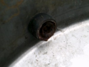

Here's the rusted remains of a expanding rubber plug that was in the bottom of the boiler.
I knocked it out and cleaned it up. It's a shame the hole is too small for the heating element.
But at least it's in the right location.

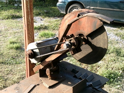

Threw in a picture of the old chop saw, one of the most useful pieces of shop equipment I ever built.

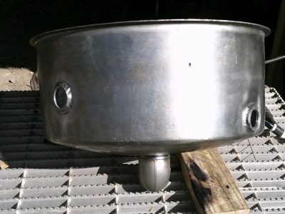

Used the plasma cutter and made the holes for the two heaters and the drain.
First I put the parts in place, one at a time and sprayed a fast light coat of primer for marking were the holes needed to be.
Cut the holes out slightly under sized, then filed them to size. A big coarse file tears up thin SS
Cleaned up the SS and proceed to weld on the fittings for the heaters and drain.

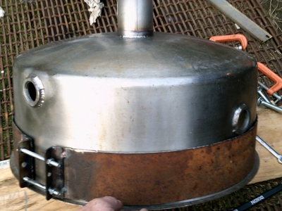

The original stand was a good idea, until I decided to add a second heating element.
So, back to the drawing board. Making the new stand will keep me busy will I'm waiting for the two 4500w heaters.
Can't weld the two halves of the boiler together until I'm sure the heaters aren't going to interfere with each other.

Are you going with the bent ULWD heaters? It might get interesting trying to screw them in.

Could you clearance the band for the element instead of making a new stand? Just throwing ideas.shadylane wrote:The original stand was a good idea, until I decided to add a second heating element.

Screwing a pair of bent ULWD heaters in might get interesting.
I ordered a pair of these.
http://www.amazon.com/Camco-02923-Screw ... B0002YUDSI" onclick="window.open(this.href);return false;" rel="nofollow
Posting with jed
Thought about it. But the original stand was also bowlegged. Don't know how it happened. it was straight when I finished welding it.
In the morning when I was sober, the legs were all bowed in the exact same amount.
Figured it must have been the damned leprechauns hiding under the still house that did it.
