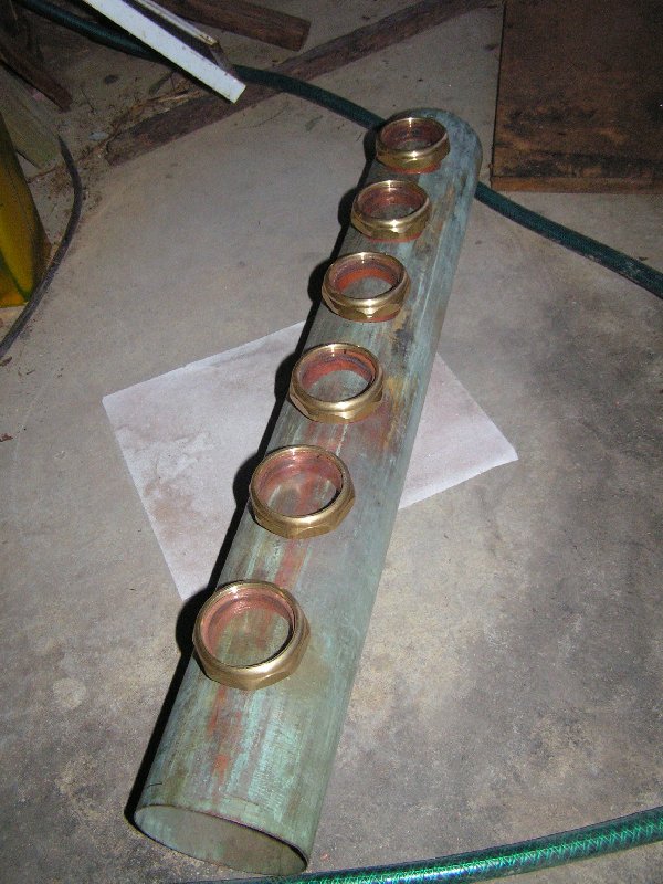

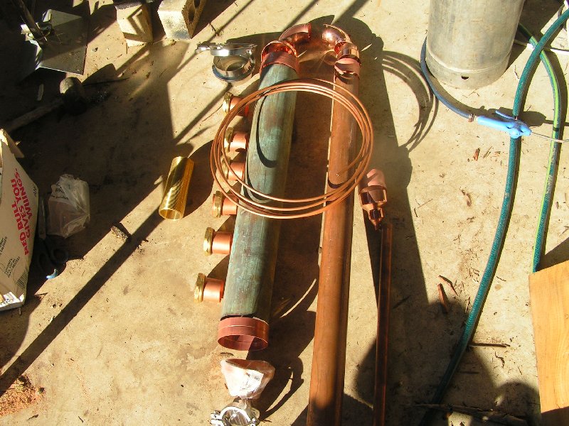

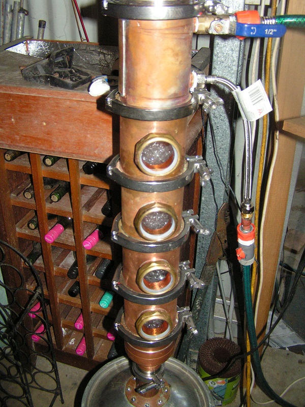

And some more Pics
Here's the collection of bits I'd gathered before I started ...at this stage it was going to be 6 plates with a drop in tree
A pic looking down from one module to the next
A window views

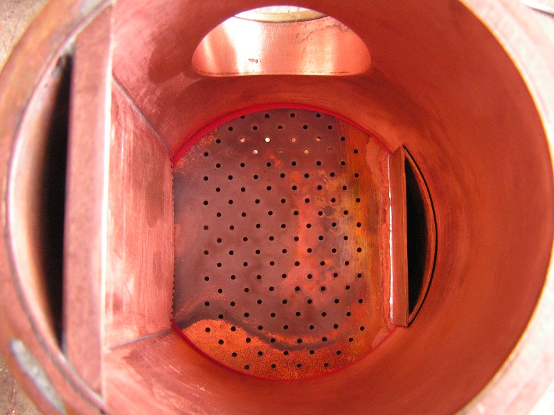

This first one is of an experimental Deflag reflux diverter...but pretty much what I would see before plates load up
A window views

Righteous. But man, you've got to take that tag off of the braided stainless steel hoses. They're fugly.

Thanks still_stirrin ....LOL ...IIRC in that photo I was firing it up on 4 plates for the first time with only the Deflag on it in Full Reflux. I hadn't even finished off the connections to the PC .so she was all very fuglystill_stirrin wrote:Righteous. But man, you've got to take that tag off of the braided stainless steel hoses. They're fugly.

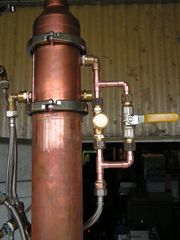

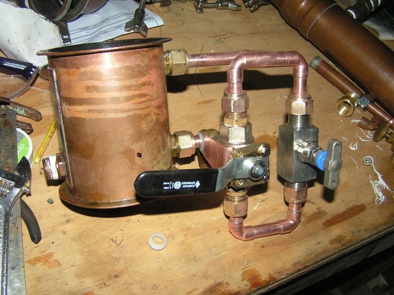

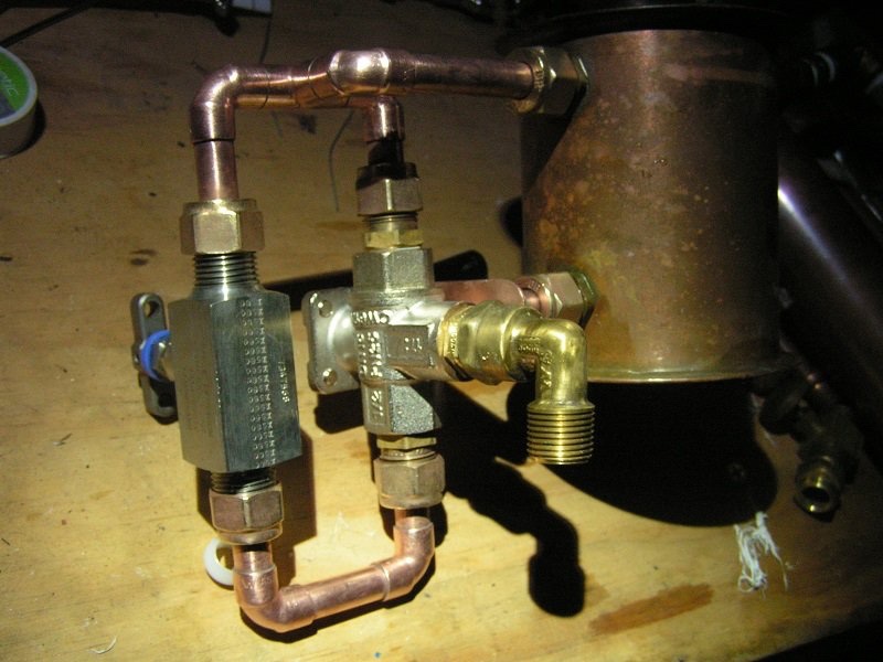

I modified the coolant manifold a few times . First I placed a valve in parallel with the needle valve so I could quickly go into full reflux and back to running again .
Heres some pics of when I was using it with a packed section . The boiler shown was just to mount it on . I would use a 80 litre keg on it .
I was having issues regulating flow with the brass needle valve .It was always a super touchy thing .
I was gifted a nice parker needle valve from Copperhead road and decided to upgrade my manifold again .
This time I included a three way valve . I could then have
1) normal plate still with coolant controlled with Needle Valve .
2) No reflux ….. no coolant flow …. IE …Pot still mode .
3) Full reflux …. Coolant bypassing Needle valve .
(Incidentally , you can see three connections to that Deflag . Only two are used . One of them was for an old project and is used as an anchor point to hold the assembly . It is a capped port with a fixing bracket soldered to it .)
This arrangement was extremely flexible and I could switch from normal running to Full reflux iff’n the phone rang . Or quickly switch to Pot mode to strip tails . This meant that the needle valve setting didn’t need so much shagging with to redial in each time . Although these improvements helped , I was still frustrated at how sluggish the cause and effect of tweaking a needle valve to seeing a change in output was .

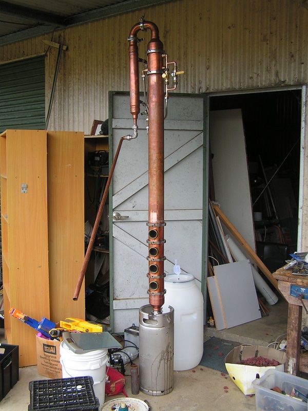

All in all , I was hating the while CM deflag thing . So I decided to modify it to a VM head .
I had a spare module I had made and never used , so I stuck a 1 1/4” nipple on it that would fit the Ball valve and condenser off my 2” LM/VM still . Instead of making a dedicated Reflux Condenser , I just flipped my original flute PC upside down and used the Deflag and inverted PC as an RC .
To this day, I still use it this way . Time poor . One day I’ll make a dedicated VM head for it .
Anyway , I sas blown away by this mod . Adjusting the Ball valve gives changes in output within tens of seconds verses many minutes with the Deflag and needle valve .
Fluctuations in heat although causing changes in output rate do not effect quality if spirit like they did with CM design .

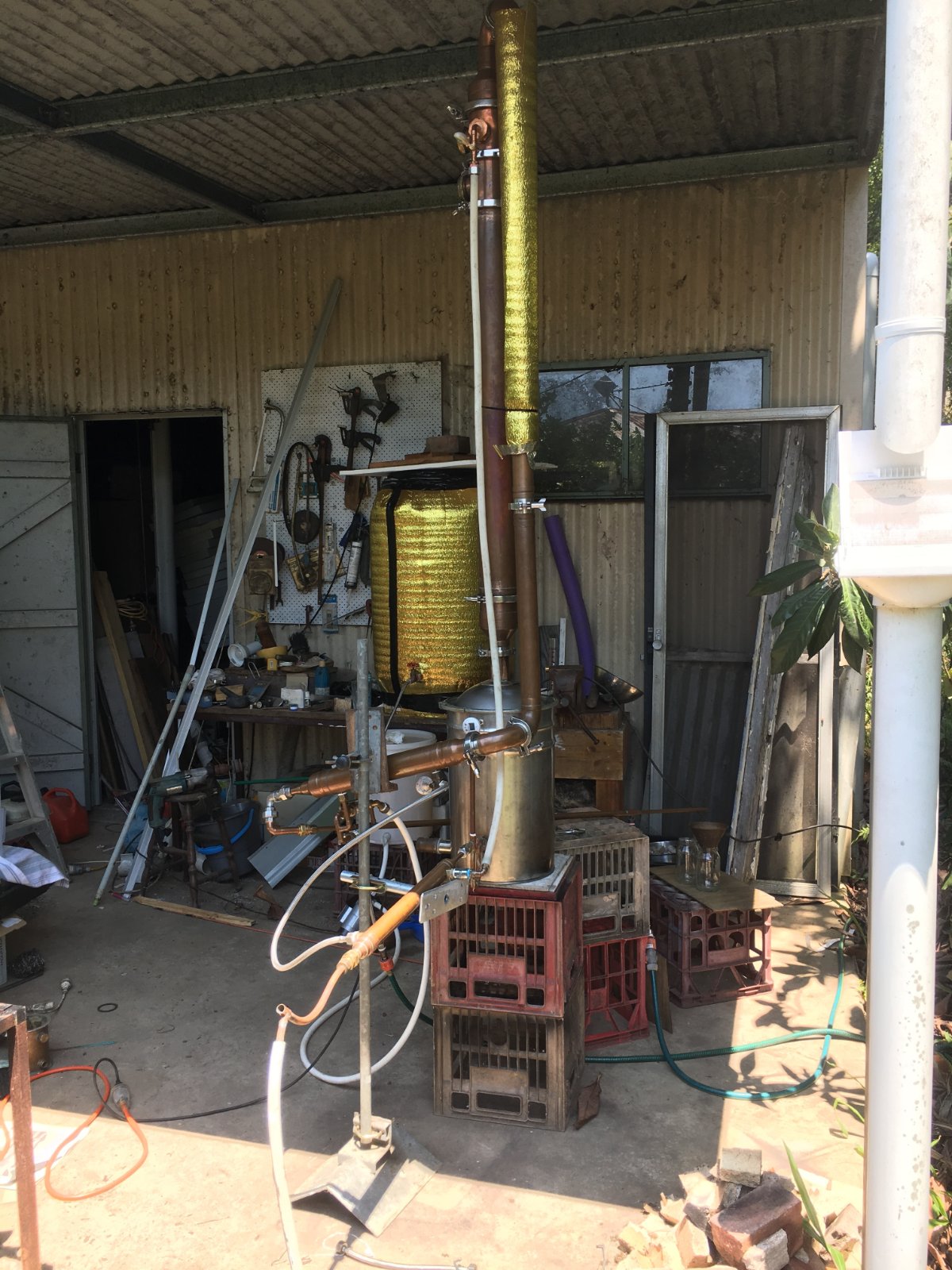

So I couldn’t figure out why in the hell all the commercial “flutes” I’ve seen have some stupid parrot attached right above the boiler making it a damn nuisance to try and collect. I knew if I searched around here I’d find a couple design inspirations. But the thing that really inspired me about this picture was the collection contraption you’ve rigged up. That thing is badass Yummy! A little “L” block bracket attached to an adjustable bracket. Pretty slick.

Arrrr , guess you're talking about the collection jar holder .
That was knocked up in a hurry one day . As I did antenna installation , I had on hand a Tile Ridge mount bracket , an extension mast and a wall mount bracket and a pice of wood ......Whaalaa , jar holder
That thing stil get used for all sorts of things . It's been used to hold up bits of my continuous still project.
