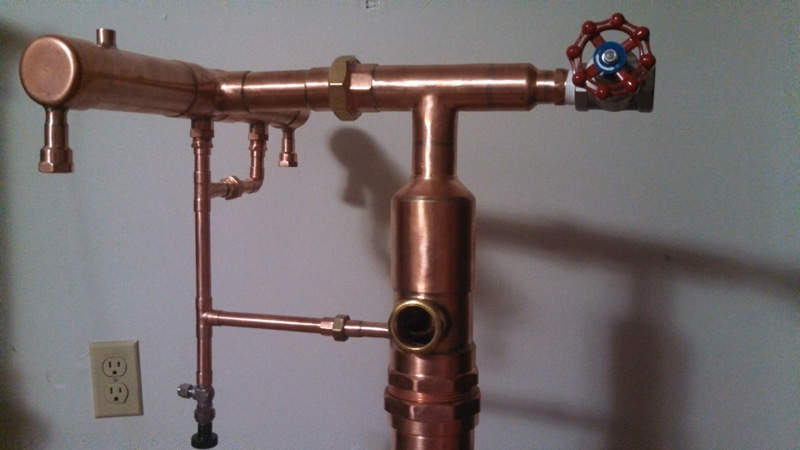

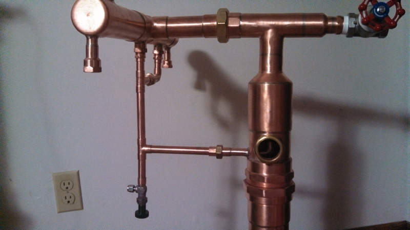

my last 3 inch VM head using Mr. Jackson's Design. Cross flow # 5 .
- Posts: 45
- Joined: Thu Dec 06, 2012 7:05 am
Re: Jackson Crossflow Condenser
Those tubes for the crossflow looks long. How big was your inner tubes for the condenser? New moonshineer?

This build I used 18 inches X 1/4 inch very thin wall tubes( not thicker refrigeration tubing) for better heat transfer ..

I was looking for the template to the endplate. Height wise, I haven't seen a more compact reflux head or condensor. I have some limitations there since I'll be working with a gas range to start. I did find a b/w drawing on the parent site but didn't know if it was true to scale. On a side note though, how well is yours working?
- Expat
- Posts: 2251
Re the end plates I made easyflange and used triclamps, this really in my opinion is the best way as you wont end up with an inaccessible leak, which proved its value immediately. If I had to do them again I would just use SS ferrules.Saltydill wrote: ↑Fri Jan 01, 2021 2:09 amI was looking for the template to the endplate. Height wise, I haven't seen a more compact reflux head or condensor. I have some limitations there since I'll be working with a gas range to start. I did find a b/w drawing on the parent site but didn't know if it was true to scale. On a side note though, how well is yours working?What specifically are you looking for? I use a crossflow for my reflux condenser, perhaps I can help.
Reference:
https://homedistiller.org/forum/viewtop ... 87&t=47632
Since the original build I've only made two small modifications; I shortened the length of pipe below the tee, and added a SS ferrule, thereby reducing the overall height and reliability of that connection. The other is that I added a second atmospheric port on the other arm of the crossflow, figured it would balance air escaping and not allow pockets to form. Note that the arms of my cross flow are tilted slightly upwards to allow distillate to return more easily, which isn't on any of the original designs I saw.
How is it working? The answer is... its bullet proof. My current setup is 5500w electric and it knocks down everything without breaking a sweat, only a tiny trickle of water is required. I'm using it on my 3" column with a 3-2 reducer and I couldn't be happier, as it maximizes the available height.
