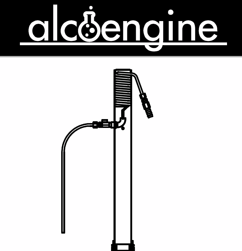

What type is this Still, if the column is packed and the off-take is controlled by a ball valve with a restrictor that only allows for 2 drips per second on a spirit run?

LM " Liquid Management. The amount/speed of the spirit leaving the still is being managed /controlled .. in turn that dictates how much spirit is being refluxed..or in other words how much reflux there is....or another way ...what the reflux Ratio is.
Most LM reflux stills use a needle valve to restrict or increase spirit flow. The type in the diagram uses a restricter nozzle arrangement. I'm told they come with 2 different interchangeable sized nozzles.
Ive never personally run that exact still, but I'm told that for a small commercially available refux still they are one of the better ones.
Not good for Brown spirits but fine for vodka / neutral style drinks.
