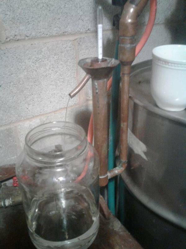

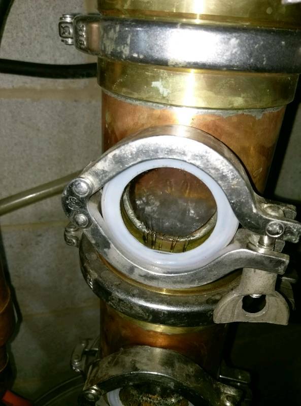

Figured it was about time for another shiner weekend. Last weekend panickry helped me see a thumper run for the first time. It was awesome, running straight out to barrel strength in one slow run.
Jed, not to be out done, said "hold my whiskey glass" . Here is my current view.
I loaded up the car with 40 gallons of 7% booners and headed to Jed's today to run my first flute. We got 27 gallons in there, gonna strip that out loud and fast. In the morning, going to put in the other 13 gallons plus the strip. Run nice and steady. Hopefully come home with a few gallons to finish off my 5 gallon barrel refill :thumbup:

I would be cautious about stripping booners for a plated still, might be light on. Maybe just run it in one run and take it of high, ya won't regret it :thumbup:

Yup. Wet just changed gears and decided to do the one and done. Clearing late heads now :thumbup:

So I have 40 gallons, Jed has a boiler that will fill 27 gallons. . My thought, being a die hard pot stiller, is to run 27 gallons hard and dirty, put that into the remaining 13 gallons, and so a slow, or regular flute run, this morning. This plan was especially true when the heads started coming of at 92%. Yikes... my poor bourbon flavor.
But wait.
As the late has came in, the flavor started punching me in the mouth. Full corn flavor, at 87%? The heads were gone, this thing is spitting like a dream. Alight, so then and there Jed convinced me to just go ahead with a one and done right then and there. We were approaching hearts, why not? Afterall, might as well run a flute like a flute. Boom.... switching to small jars.
Well wouldn't you know as soon as we make new plans, the witch fought us the rest of the night? Flooded plates, dry plates. 90% abv, 50 % abv. We bent her backwards and forwards, upside down, and every way imaginable. It was a rollercoaster. So much so that Jed, who rallied for the 2 one and dones, said "screw this", flipped all 6500 wats back on, killed the reflux, and sent the tails up damn near ahead of the hearts!
So, put my 5 gallons of low wines into the rest of the mash for the night, put her to bed, and hope she wakes up on the right a side of the bed this morning! Breakfast, then we wake her up.

Woo-wee! Tell you what. Bringing her breakfast in bed sure started the day of right. She is purring nicely for us this morning.
The heads came off at 92%, nice and slow take off. After we cleared those, settling in at a gallon an hour, 84% hearts.
And the flavor, yee-ha! Corny goodness :thumbup:
