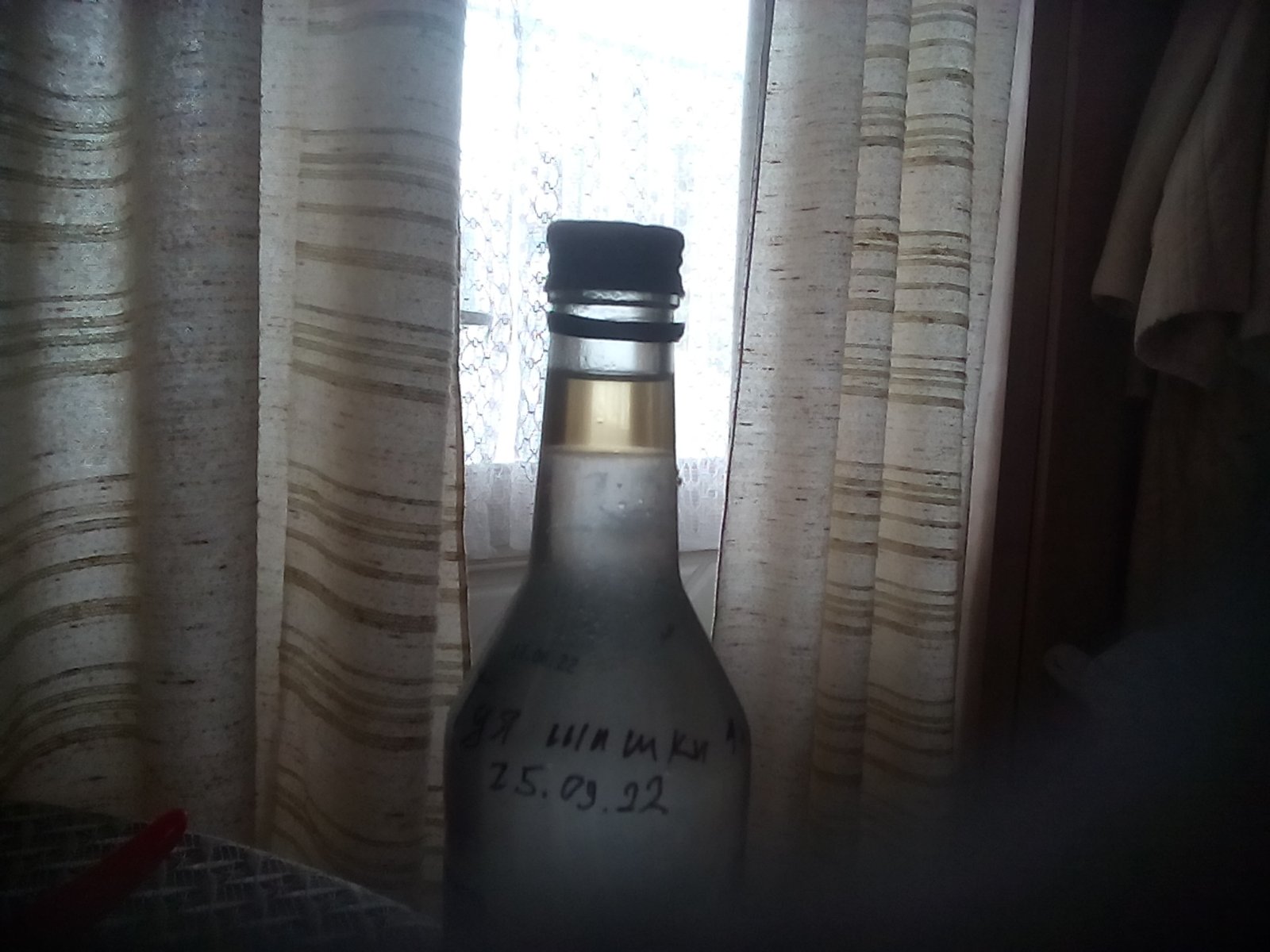

Like this juniper, its cones are like those of a poplar, they are not round like those of a Christmas tree or pine, small with small wings. And so around the juniper. Large yield of essential oil. Ran a ferry. Pleasant, persistent, strong smell. Hydrosol used to wash the face, legs, hands, teeth.
