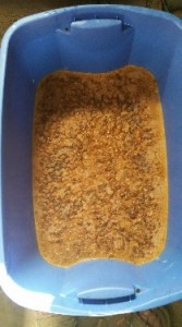

Mash No. 2 & 3:
I decided to take the risk to not sterilize the dunder for mashing and to ferment open only covered with a cloth.
Each 25% (volume) blackstrap molasses + 40% water + 35% live dunder (already diluted 45% dunder + 55% water). Garden chalk, nutrients and fresh bakers yeast. Both buckets started off as usual. Fermentation was fast because of the hot temps here at the moment.
The fermentation is finished now since a few days. No visible infection up to now. I added now one cup of fresh infected dunder to each mash. Perhaps this helps. All in all, despite the hot temps, to infect grain seems much easier and faster than to infect Rum.

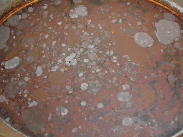

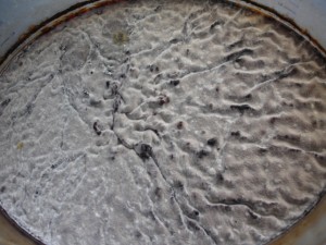

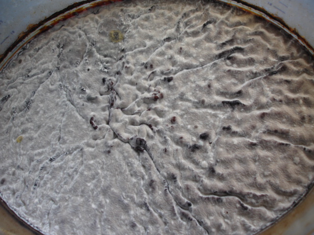

How the dunder pits look at the moment:
I now diluted the fresh dunder from the stripping runs 1:1 with water and added it to the two dunder pits. This destroyed the pellicle. But I am sure it will grow again fast.
And I started a new dunder pit, No.3, infected with all kinds of soil I have at home and a raw potato. I will make three sugarheads with those three dunders.
