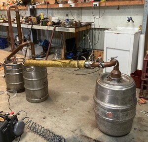

Some of you might have already seen some pics of this around here and elsewhere .

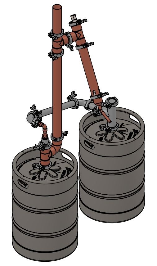

With the common 2" keg thumper connection the feed from the Boiler comes in the top and the take off is out the side . This common arrangement is easy to make but it limits the Thumper as to what it can connect to ...usually just a Product condenser .
By contrast this variation will allow any still head to be connected as the output is out the top .I'm sure I saw it some where else :thumbup:

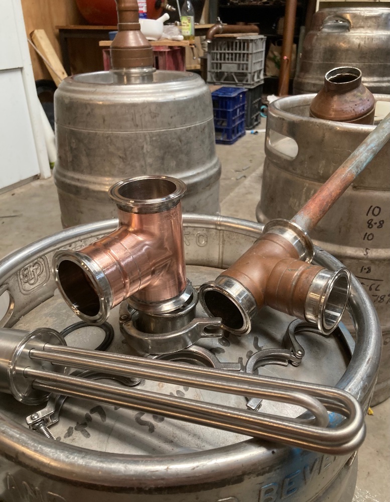

I had to chop up a few fittings so that they would fit concentrically...no biggy but had to be done .

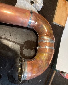

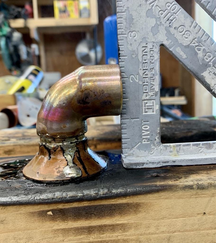

I Brazed the 2"-1" reducer to the 1" 90 bend so at least that wouldn't fall apart when I soft soldered the rest

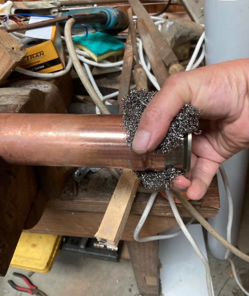

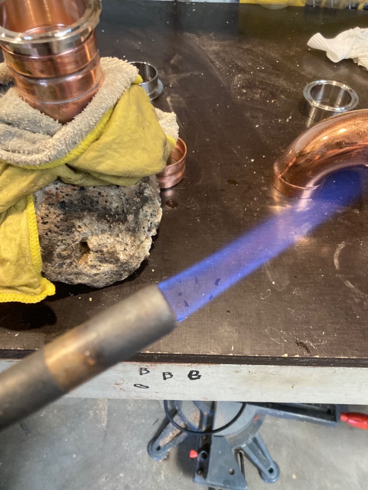

Cleaned it all up ready to soft solder the copper bits .

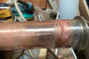

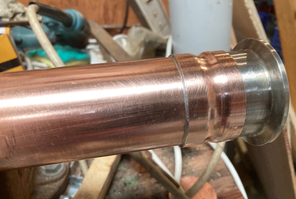

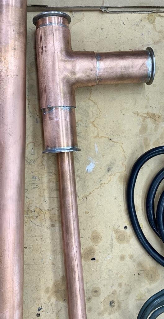

Soldered on the Staino Tri-clamp ferrules and the thump pipe
Already for a test :thumbup:
