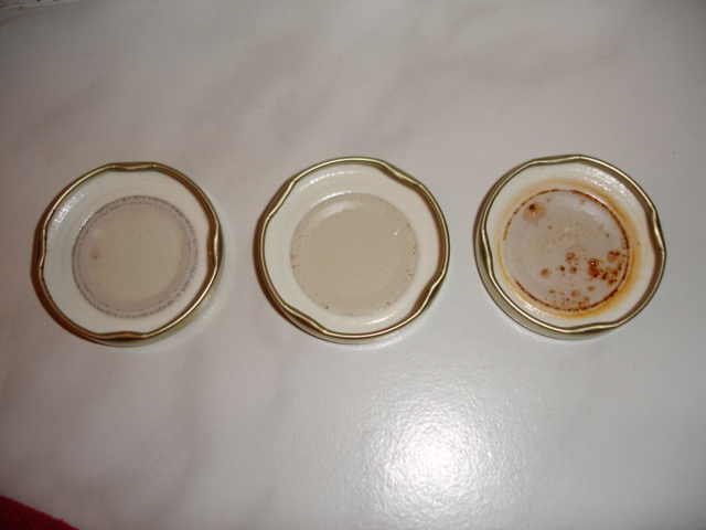

10 days since I mixed my ester solutions. I stored them in small glass jars with plastic lined lids. Here a picture how they look now:
The lids looked like new before. The liquids never touched them. You see how nasty their fumes are. Be careful when you experiment with concentrated esters!
Captain RedwoodHillBilly, we are waiting for your experiments.
