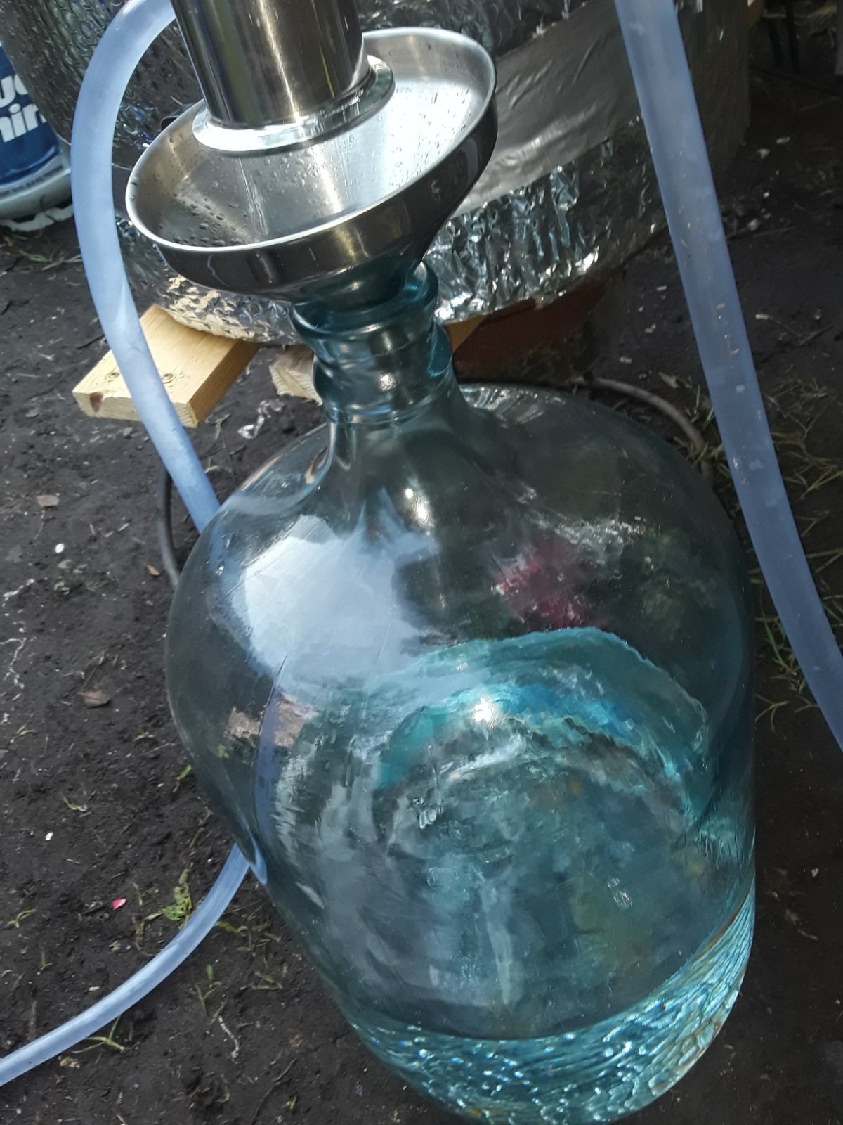

The distillate looks blue in that carboy... clear as day tho. My photos always turn weird 90* and stuff don't know why
