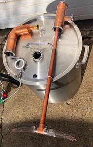

Kept low and on a tangential orientation on the vessel to ensure that all of the steam bubbles have collapsed in the liquid while also promoting a whirlpool movement.
Google eductor head and get some mixing action involved too.

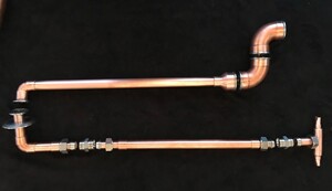

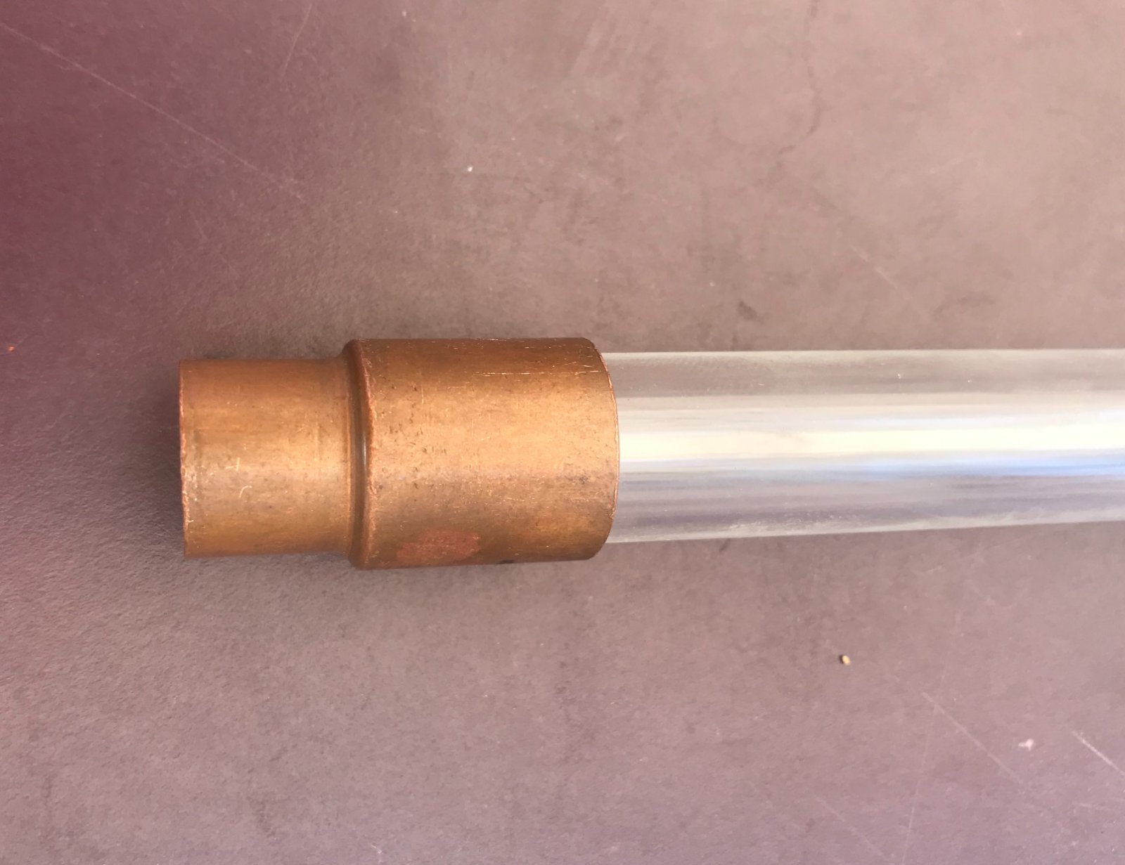

Doing more research on manometers, Some interesting builds out there, with the hobby CNC that I have, thought about cutting into a nice slab of wood, a track for some tubing to sit nestled into, with marks and readings cut into the wood at exact levels, could make a quick/nicer reading tool, but I don't understand everything enough just yet to run with it. Polycarbonate tubing, I believe is not quite acceptable? Ideally it doesn't come into contact with our wash. borosilicate glass would be the best choice, would need fittings on the ends, as you have done.
But then I came across this on Amazon, you see them all the time on this forum, but I had no idea they were this affordable.
1.5" for $23 right now. With it being much wider than other manometers, level changes in the liquid would be lower, so harder to scale a reading off of, but allows you to make a stubbier unit?

Agreed that borosilicate glass is the best (breaking hazard aside). Wish I had the glass, but am going with plastic. I figure that nothing ever comes into contact with the manometer, except in the rare emergency. So, a plastic is acceptable, given it can handle some heat. That's my thinking, but I'm curious what people have to say about it.
The sight glass option is cool, but the height variation isn't going to be shorter. The water displacement in a manometer is independent of diameter.
Looking forward to what you end up with, blue.

BS, no worries on any questions. Its easier for members researching this topic to find it all in one place, I think.

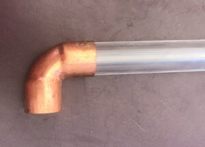

Sure, the polycarbonate will work just fine. It will, however, grow opaque over time. I just wanted something more permanent. The boro tubes are expensive if you go through a lab supply. They're dirt cheap if you hunt long enough for 'em. I think these are the size I ordered. FYI - I think you want a taller tube than a sightglass so you get a better (longer) pressure gradient to gauge your boiler pressure, IMO.
Lampwork Supply
If you're going with a manometer like Yummy's, you don't have to get fancy with ferrules like I did, just 3/4" fittings for a 59" tube. Oh, and BTW, the walls on these tubes are so thick you can rap 'em on a dining table pretty hard and they just bounce off. I wouldn't try hitting a stone countertop as hard though.
. . As far as water displacement in a manometer goes, I see that Shady's manometer is scaled much smaller (diameter) yet works fine. Same with the u-tube manometers for sale on line.
Lampwork Supply

Look up water column. The pressure of 1 inch of water in a water column is 0.036 psi or thereabouts. The deeper the water the more pressure a simple PRV tube would encounter. It's still an open system.

To manage steam vent on manometer couldn't the last down turn be a liebig?? Water drops = over pressure..

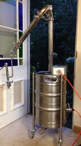

Steam distillation seems to cause a lot of concern. There is always a little confusion on the difference between a steam rig and a pot still with a thumper. I’m not convinced there is a difference. Except my steam rig has both a PRV and a manometer that will both dump pressure …. If it ever occurs. Manometer prevents a vacuum from occurring and collapsing the pot as well.
My steam rig operates the same on grain or off. There has been no difference in pressure on the manometer or the PRV. Preventing a grain plug up issue is pretty simple. I used a couple of mash pot drain screens on a copper Tee and pre heat the thump with propane whilst stirring prior to steam assembly.
I use polycarbonate for the manometer. Stays cold. Works fine. I put zip ties on it to indicate cold pre run level the other is slid up to indicate manometer fluid level when the product condenser starts to produce. The difference is about three inches. Easy to see any rise in pressure after that.

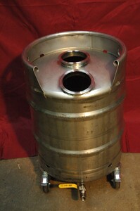

20 gallon pot is used for mash, ferment and thumper in my steam rig. Ferment on grain. Steam on grain in the summer months. BIAB during the winter and pull grain prior to steam. The BIAB just makes it easier to clean when it’s -30C outside.
FYI. The only time the pot has had pressure and lifted off the lid was during fermentation due to a plugged airlock!

Having done similar, I can say I was both concerned and happy when my yummy style 2m tall prv started to work.. grain blocked outlet, long horzontal pipes are bad mkay?
That said, trying to steam thick grains more than 18" deep, the 1.2m one didnt cut it...

Manometers are being used both as a visual indicator of pressure and a safety mechanism. Could you just make it out of 100% copper, forgo any plastic/glass/etc and just not have a visual measurement? From a safety standpoint, it would still operate as needed.

You could. Nice to see an issue before it gets out of hand.BlueSasquatch wrote: ↑Thu Jan 13, 2022 11:01 am Manometers are being used both as a visual indicator of pressure and a safety mechanism. Could you just make it out of 100% copper, forgo any plastic/glass/etc and just not have a visual measurement? From a safety standpoint, it would still operate as needed.
My manometer gets filled each time with clean tap water. Don’t see any reason it would go opaque. It isn’t in contact with steam or alcohol vapour. Does not even get warm during a stripping run on 20 gallons.

True, it's hard to turn down more data, but cheaper, stronger and just as "effective" to keep it all copper, makes it mighty tempting. The change in water level doesn't sound like it is ever greater than say 16" so if one could pinpoint a better height to start/stop the glass, you could get away with a more narrow "window"Dancing4dan wrote: ↑Thu Jan 13, 2022 4:22 pm You could. Nice to see an issue before it gets out of hand.
I'm just hung up on the manometer for some reason, I love your 'relief valve' with the stainless steel ball and keg spring, going to do the same on mine, Also I think Twisted Brick has a nice manual valve for vacuum relief, that I'm starting to consider adding in somewhere, that or a homemade version of a vacuum relief valve, they make nice sanitary connection stainless steel ones, but they run 150-200

My manometer never rises more than 3-4 inches. (That sounds bad!
) I mean the water level in the manometer never rises more than 3-4 inches during a stripping run. Vents straight up. Water in manometer does not get hot. Has been shortened since that photo was taken. Not a very good picture

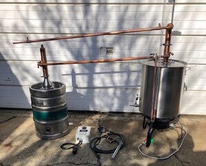

Having a hard time articulating my question but here she goes.
Travel of steam is opposite between Dancing4Dan and Twisted setup. In Dan’s setup the steam travels naturally up. Twisted’s it travels down. It may not matter at all as the steam eventually has to travel down into thump but is there an ideal incline for the steam to travel between the water vessel and the thump? Forgive my ignorance. Super interested in steam injection stripping now. Feeling the effects of an apprentice. The more ya learn the less ya know kind of thing.
-Thomas Paine
-Thomas Paine
- Dancing4dan
- Posts: 1078
- Location: Alberta
Re: New steam rig and manometer test
I run my Lyne arm up hill by placing the thumper on my banjo propane burner. Doing so allows any steam that condenses into water between the boiler and the thumper to run back into the boiler. I found this conserved a lot of water in the boiler and prevented the thumper from getting overfilled with condensed water.Stonecutter wrote: ↑Sun Jan 16, 2022 6:31 am Having a hard time articulating my question but here she goes.
I actually ran it level once without preheating with propane and the thumper liquid level went up significantly because of condensed water adding to the thump volume. In addition the boiler liquid level ran lower than the element and fried my element.
Sooooo, I run the Lyne uphill and no problems of either kind since. My boiler is smaller than my thumper. NOT the typical way of building these things. However I use propane to preheat the thumper and with a Lyne arm that runs up hill there is more than enough water in my keg boiler to strip a 20 gallon thumper.
I fill and fire the boiler. Fill and fire low to medium propane under the thumper. Assemble the steam head on the boiler. Assemble and attach the steam injection head to the thump lid so it is ready to go on. During this time I stir the open thump to prevent scorch. By this time the boiler is getting hot but not boiling yet. When the thump is getting warm to very warm, Chop the propane and put the thump lid and steam injection head on the thump. Then when everything is connected wait a short while for the steam to start. Assemble the PRV, fill the manometer make sure everything is tight and start checking for steam leaks. Once I know I have steam and no leaks I insulate everything except the manometer and product condenser. Especially the boiler, boiler riser and Lyne arm!
Once the thump is "thumping" I add propane to the thump again until I can smell fores. The steam injection will stir the thump and prevent scorching as long as you don't go crazy with the propane. It is just there to help. Go to hard and it will puke and / or scorch the thump. Once I smell fores I shut off propane because the product condenser will start to produce in just moments. No propane during production after this point.
I use a long Lyne arm to allow me room to maneuver / move around my equipment with out bumping or tripping on shit. The long Liebig condenser I use does the same. Product is well away from the boiler and thump.
There is more to it than that, but that gives a quick overview.

I sort of thought that steam acts like a gas.Stonecutter wrote: ↑Sun Jan 16, 2022 6:31 am Having a hard time articulating my question but here she goes.
Not particularly travelling up or down, but it expands to fill the available space...
- Twisted Brick
- Posts: 4173
- Location: Craigh Na Dun
Well, here's how I approached it.Stonecutter wrote: ↑Sun Jan 16, 2022 6:31 am Having a hard time articulating my question but here she goes.
I know from running my shotgun that ethanol vapor begins to condense as soon as it encounters a surface cooler than itself. My shotgun only gets hot up to the first baffle (2-3" in). So logically, vapor from the boiler would condense as soon as it reaches the 'lyne arm' (thumper transfer tube) and continue to do so until the tube reached the vapor's temp. As long as the transfer tube (at any angle) is properly insulated, condensation would be minimized, maximizing efficiency of the thumper. Angling it up sounds like it would certainly increase the vapor-to-condensate ratio.
I'm thinking the same properties would apply to the down tube inside the thumper. As soon as incoming vapor hits the downtube (surrounded by cooler wash) it too would condense, releasing its energy and pumping in hot ethanol in liquid state. How much time would elapse until the downtube (and surrounding wash) got hot enough to maintain vapor state is anyone's guess. Naturally, the higher starting temp of the thumper contents (like D4D describes) the shorter this 'heat up' period. I had some extra copper and fittings on hand so I built into my thump downtube a liebig-like insulating 'shell' that presumably would allow the internal downtube to avoid the cooler wash and start introducing vapor sooner.
Don't know how effective it really is, but I figured it couldn't hurt.

Twisted, It had to be the 10th time I studied your photos before I noticed your cat watching you through the blinds.
Small diameter copper is cheap enough, I don't mind a copper manotube, I suppose I'm just not crazy about them in general, so streamlining one is appealing to me. Having to go below your keg makes it trickier for how to support your keg, can't just sit on the ground. I'll also need to put in a Tee somewhere for this to branch off of. How small of a diameter can one go, and how far below/above the liquid level, does it have to be?shadylane wrote: ↑Sun Jan 16, 2022 11:17 pm Here's my thoughts.
A copper loop tall enough would work fine, even a water trap made out of 2 different sizes of pvc tubing.
If the manometer isn't in contact with boiling mash or the alcohol vapor, it can also be made out of clear plastic tubing.
Just make sure the tubing won't kink if the SHTF and hot steam needs to blow through it.![]()

I would think you could go 1/2" out to the manometer with no problem. I went with 3/4" because Yummy did. Since incoming steam bubbles/heat rise, your thumper downtube wants to go down into the wash as far as you get it.
Plenty of ways to elevate your keg.

Oh I was going to make a large distilling table on wheels, so the height isn't the end of the world, I was shooting for a table with mostly uniform height, so the kegs could go anywhere on it, which can still be done by adding little legs to the boiler keg, but the thumper keg would then need it too, with the piping already made up.

This worked really well, appreciate you sharing.Twisted Brick wrote: ↑Tue Jun 22, 2021 11:32 am BS, no worries on any questions. Its easier for members researching this topic to find it all in one place, I think.
Lampwork Supply
For those in Canada I found one US site that ships borosilicate glass to Canada for a reasonable amount:
ABR Imagery
and a Canadian location:
Nortel Glass
I used JB ClearWeld to attach the glass to the 3/4" fittings as you suggested.
And my results (I tried to mount out of the way to avoid the glass meeting the same fate as my hydrometers

Excellent, Born_Free! Very neat and nicely-built. I think you will appreciate the ability to glance over to monitor whatever boiler pressures are happening in real time.
Keen idea for the drain valve too. Now I wish I'd installed one. I typically open my 'anti-vaccuum' (real term?) valve just after power shutoff. Are you planning on doing this with your drain valve?
Your manometer should serve as inspiration to others from the example that Shady started.

I hadn't thought of using it for that, I figured I could drain the water when not in use or when overfilled. I am planning on a larger "oh shit" valve on the boiler itself (waiting impatiently for orders to arrive).Twisted Brick wrote: ↑Thu Jun 20, 2024 8:33 am Are you planning on doing this with your drain valve?
That darn vacuum risk seems more likely, although much less destructive, then the overpressure case. I'm using a milk can boiler so not overly thick walled, I wouldn't have gone down the steam route had I not discovered Shady's manometer idea.

The "oh shit" valve is a good practice. It's also nifty to play with at the end of a run. By modulating the valve open and closed, one can watch the indicating water in the sightglass rise and lower and get a sense for what kind of pressure the boiler is putting out (and how fast it evacuates) with the volumes and viscosity you're running in each vessel.Born_Free wrote: ↑Thu Jun 20, 2024 12:30 pmI hadn't thought of using it for that, I figured I could drain the water when not in use or when overfilled. I am planning on a larger "oh shit" valve on the boiler itself (waiting impatiently for orders to arrive).Twisted Brick wrote: ↑Thu Jun 20, 2024 8:33 am Are you planning on doing this with your drain valve?
