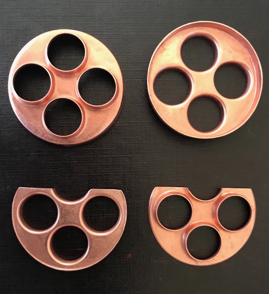

Thanks a lot, it's a great solution, I like it and it makes a lot of sense. Since there are, I ask you for advice: on 30cm in length, would 2 intermediate deflectors be enough?StillerBoy wrote: ↑Thu Feb 25, 2021 6:48 amI don't cut the baffles on one side as that method creates dead spot areas.. the baffles I make are of the full size of the inner tube.. what I do is V the plates where the tube are and drill small holes in the space between the tubes..
There is plenty of leakage with full plates anyways... leakage around the outer edge of the plates and the tubes, by adding the extra holes turbulent is create where is needed to be.. but same principal and concept apply to shotgun..
The attached pictures are of a 3 x 5 3/4" x 7 tubes (1/2") dephlegmator.. it was able to knockdown 5500w at 1.3 liter of water flow with no vapors flow through..

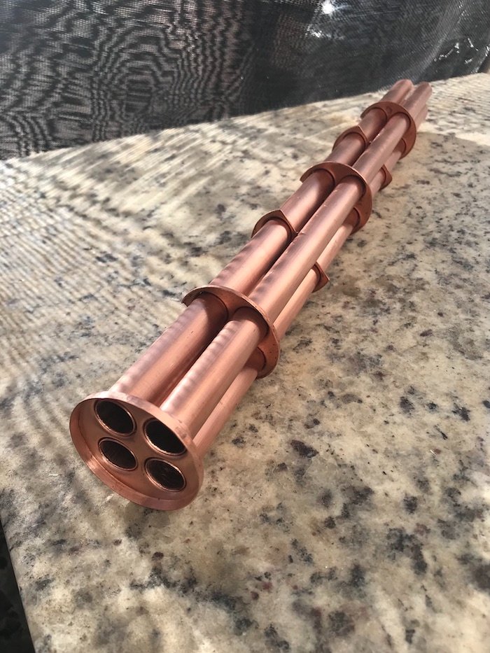

I followed the specs on the tube and baffle design guidelines and made the baffle cut outlined. Here are a few pics of them separately and just prior to installation for customers.

If it was I building a 12" (30cm) shotgun I would have 3 baffles spaced 3" (7.5cm apart, and design similar to the 3" baffles plate shown in the previous picture.. they are a little more work, but worth the effort for the end result..
What the extra baffle plate will do is reduce the water flow requirement, making the shotgun much easier to manage its operation..
One can built a 2 baffle plate and cut sides and it will work also but will require extra water flow, that a choice the builder need to make base on his skill level.. the style of built I do requires attention to details during the assembly..

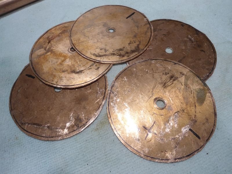

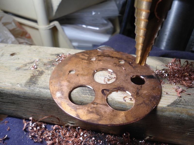

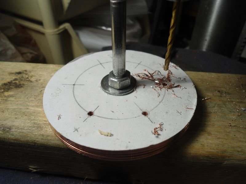

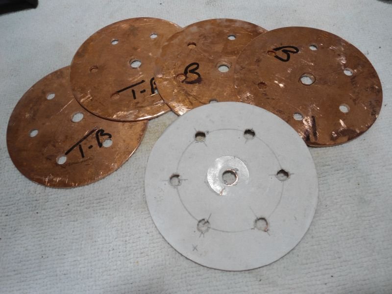

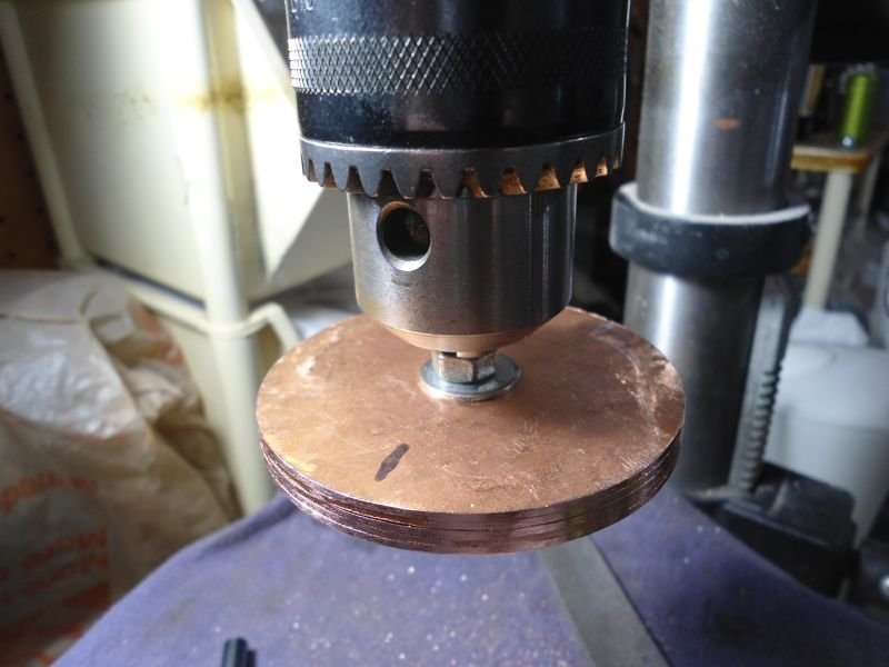

Here's how I go about doing the plates.. I cut 5 pieces of 1" x 2" in length M copper pipe, slices the pipe open, anneal the copper, flatten out the annealed parts, and then clean them up with citric acid..
Next I find the center of each plate and center punch all the plates, and drill a 1/4" hole in each plate, then the plates are assembled together making sure that each plate is numbered and a lining mark.. when that done, I now use a 1/4" bolt and assemble all the plates together and machine them down to fit inside the tube easily..
From there I paste my paper disk using a glue stick which as the design drawn on, re-assemble the disks together again and drill pilot holes where needed..
Mars..

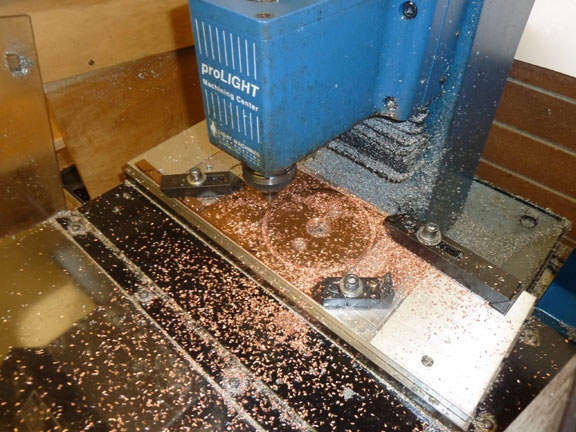

I was lucky enough to have a small CNC machine available to me when I built mine.

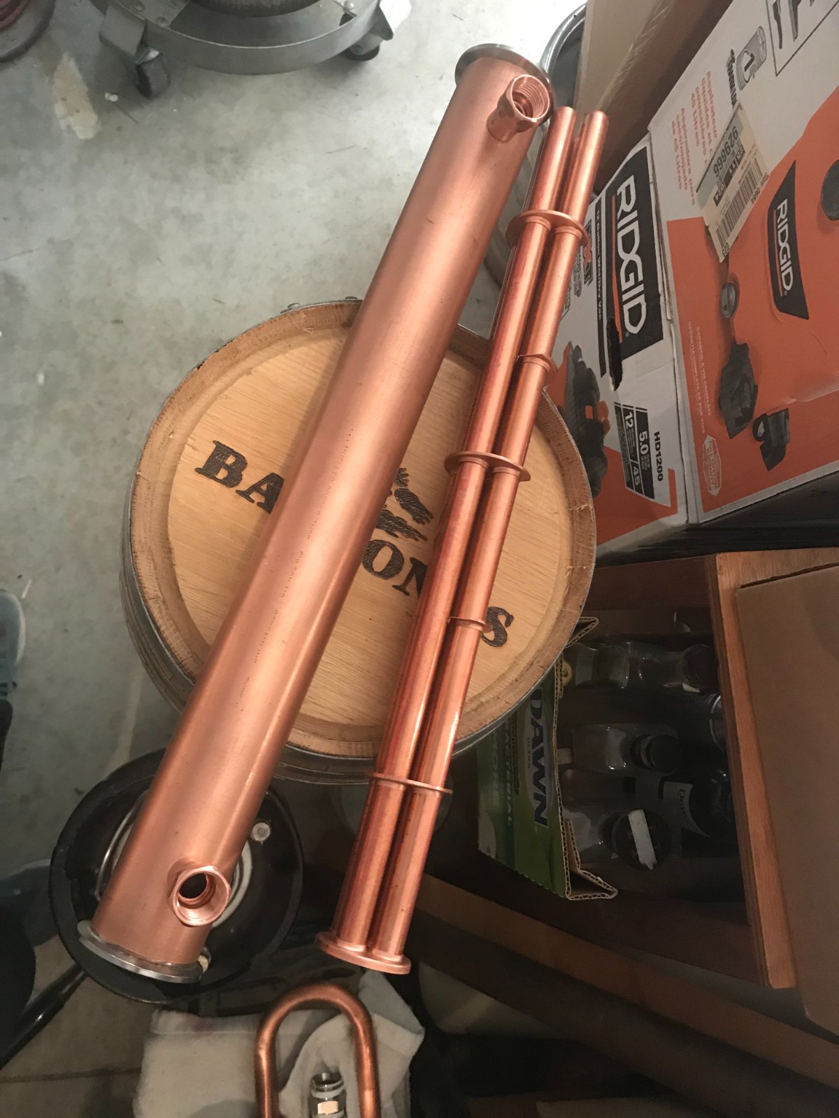

Have yet to run with this condenser, but I've heard good things about it's efficiency and I like showing it off. It's pricier than a Liebig, but more compact, and I think quite neat looking. Search Trombone/Brutal Condenser.
- Posts: 3387
- Location: Ontario
Re: Shotgun Proportions
Nice job on the built..BlueSasquatch wrote: ↑Thu Feb 25, 2021 2:31 pm but I've heard good things about it's efficiency and I like showing it off. It's pricier than a Liebig, but more compact, and I think quite neat looking.
As to its efficiency, that will be questionable having only 15" of cooling area.. the design is not much of an improvement over a regular liebig if used at an angle..
Here's why.. the inner tube will not serve of much use.. cause a liebig or for that matter any PC, only has condensing value within the first couple of inches, after that point it only serve to cool down some the distillate running along the wall if set at 45* degree or so, which the inner will not help in that phase if setup at the angle.. there maybe some improvement if setup vertically thereby allowing the cooled distillate to spread out ..
Whereas a shotgun, by reason of splitting the vapor down into multiple path, and best used in a vertical position ,condense the vapor quicker, and by reason of having less distillate flow down the walls, it cool the distillate faster..
