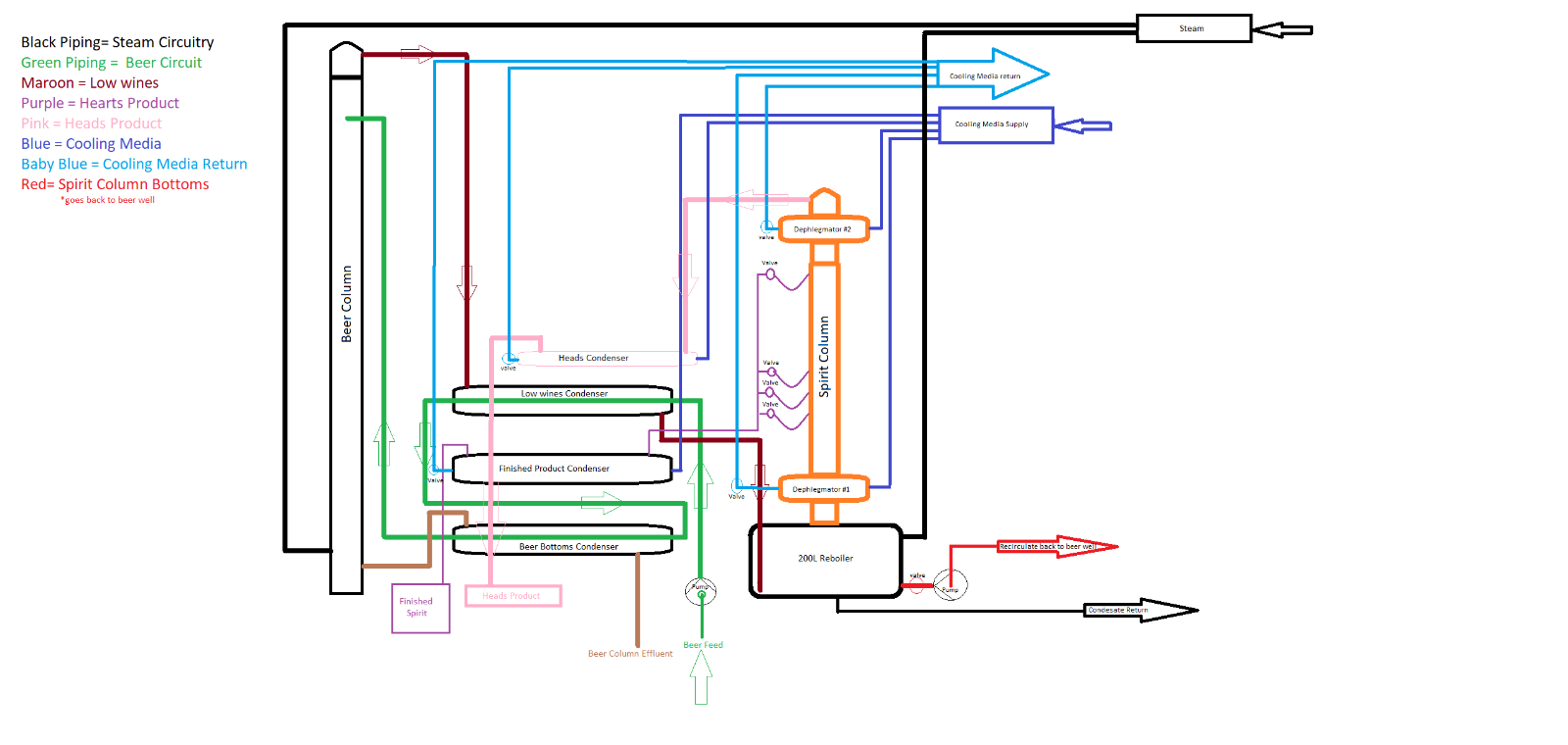

Doug's continuous distillation

- Posts: 694
- Joined: Wed Mar 11, 2009 9:13 pm
Re: Doug's continuous distillation
Yup. Latent heat of vaporization of water is about 3 times that of etoh.
Change paradigms.
If you had 2 percent etoh for 7 pounds of wash how much energy to boil off all but .1 percent alcohol?
Imagine you have a stripping column and you had 2 percent dripping into a 5 gallon pot of pure water boiling merrily at 212. How much energy to boil the etoh off?
A stripper column is recursive. You don't have to boil off the water of the 10 percent IF YOU HAVE ENOUGH PLATES below the insertion point.
2 gallons per hour, 190 proof, on 4800 watts.
On a pot still, in reflux producing 190 proof at max efficiency, there is liquid dripping back into the pot.
What percentage is that liquid?
On a continuous still, with pure water in the boiler, what is the percentage dripping into the boiler?

Umm, the first paragraph is incorrect. The vapor of a 10 percent wash is purt near 50 percent etoh. It takes 3 times the energy to do the water as the etoh though.stevea wrote: ↑Fri Jan 21, 2022 5:41 amAt 10%ABV you get roughly 3 water molecules vaporized per molecule of EtOH (3:1 ratio). By the time you get to 1%ABV, it's near a 25:1 molecule ratio.drmiller100 wrote: ↑Sat Jan 01, 2022 8:40 pm In a continuous still why would you count the vaporization of water?
The Successive plates are "powered" by the condensing vapor giving up it's heat of vaporization. So of course the excess water selectively condenses and you end up with more ethanol and less water in the product ... but you don't get the ethanol into vapor phase until you pay the cost by vaporizing a lot of water.
On the second I'm inserting my wash half way up the column. So the same way successive works up it also works down.
The only WORK done is the 95 percent vapor at the top of the column and heating up the wash being inserted into the column.

You don't have to ADD heat at each level in the column. The while point to a packed column is that the water amd etoh trade heat, and the etoh goes up amd water goes down.
Yes, in a traditional pot still the math sucks horribly. To strip the pot you have to boil all the water and alcohol many many times.
With a continuous still the math is very different. Ultimately, the only WORK done is lifting the etoh vapors at the top up to the condenser.
Separating the water from etoh isn't a chemical reaction which is endothermic or exothermic.
The magic of continuous is you only vaporize 95 percent etoh sort of once. Yes water is vaporized at the bottom to carry the heat up the column. Then the column does its magic to separate etoh from water.

wow this is real awesome. Be nice to have for stripping sounds very efficient and fast! 20 GPH of wash nice!
