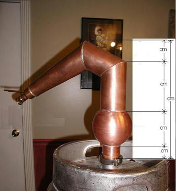

Here is how to make a copper sankey adapter...
I use 6 gage bare copper grounding wire purchased at Lowe's for $.86 a foot. I foot will make two if they are generous like they were with me. You also need 2" copper pipe.
Start by hammering the wire into square. Medium raps down the length of wire for about 7". Turn on it's side and repeat down the legth to make your round wire square. Now hammer your square into a wedge by hammering at an angle along the length on one side only. This will begin to curve the wire as well. Now I use vise grips to help bend the wire around the pipe. This will take some time to get a good tight fit. One it is close, it is time to cut the excess off. I use wire cutters and a file to clean up the ends. It will take more tweeking to get a good fit.
7.5 gal and 15.5 gal SS keg with copper Super Sankey Scotch Style Still head.http://homedistiller.org/forum/viewtopi ... =16&t=8550

Now you clean the pieces well, apply flux and reassemble. Time to solder. Stand it on it's end and apply a heavy bead of solder.
Use a file to make sure the bottom is nice and flat. It is now ready to go on the keg. Use a cork gasket! Clamp it down.7.5 gal and 15.5 gal SS keg with copper Super Sankey Scotch Style Still head.http://homedistiller.org/forum/viewtopi ... =16&t=8550

Hey Rumbull, I keep coming back to this post as I love the still design! Aesthetics is half the fun IMO.
Now that you have had this beast for awhile, what is your experience with the pre-condenser that you have in the Lyne arm portion?
Have you tried runs using/not using it as a comparison and does this affect the rum flavour at all or just allow quicker operation by knocking down vapour temp before condenser? Just curious at how well it worked. Sorry for the 20 questions, just re-read topic and couldn't find any note of it. I am looking at re-making my pot still head with this as inspiration (hope you don't mind).

Don't mind at all! This still head performs like a dream.
The precondenser works like have a very long tapered arm. It colapses the vapor in a short length that would happen in a much longer length without it. I got the idea from reading a post about the how a long tappered arm works better than an abrupt reduction is pipe diameter. I wanted a compact still head with the bennefits of the larger ones. It does not effect the flavor at all because it sends the spirit to the outlet rather than back into the still. All it does in speed up the collection rate and allows for less water running through the condenser. I have ran it without the precondeser and I had to turn up the water by about 1/3 if I were to estimate.

Ciao Rumbull, congratulations for still, very, very beautiful.
Did you use pure tin for soldering?
What the height of the column, which the column height of the ball up and what is the thickness of copper??
Forgive me
for asking too many questions
, tank you, ciao.

I just used a lead free solder from the hardware store.
The still head is about 15" to the peak so about 12" or 13" to the first angle. Not sure which you are asking about but roughly 2" to the ball and another 6" after the ball.
I don't know the thickness of the copper, it was a piece of scrap. The thickness looks the same as what I have in standard 1.5" piece of copper pipe from the hardware store. Hope that helps. Ciao!

Hello, I write the measures directly on the photo? Thanks

what size onion did you use? i have access up to 12 inch onion floats, bigger the better?
- Posts: 123
- Joined: Thu Mar 20, 2008 7:16 am
- Location: Ozarks
Re: Super Sankey Scotch Style Still
5.5 inches, I felt that was praportional to the 3" pipe but I suppose bigger could be better?DCT wrote:what size onion did you use? i have access up to 12 inch onion floats, bigger the better?
I used a 1.5" to 3/4" reducer with a 3/4" bronze union.DCT wrote:more details on how the condenser attaches to the arm
Precondenser that makes the short tapered arm act as though it was much longer. I run the warm water exiting the condenser into the precondenser which is just a loop, a cold finger. It begins to cool and collapse the vapor. It will work fine without it though.DCT wrote:what are the two little pipes at the end of the arm for
