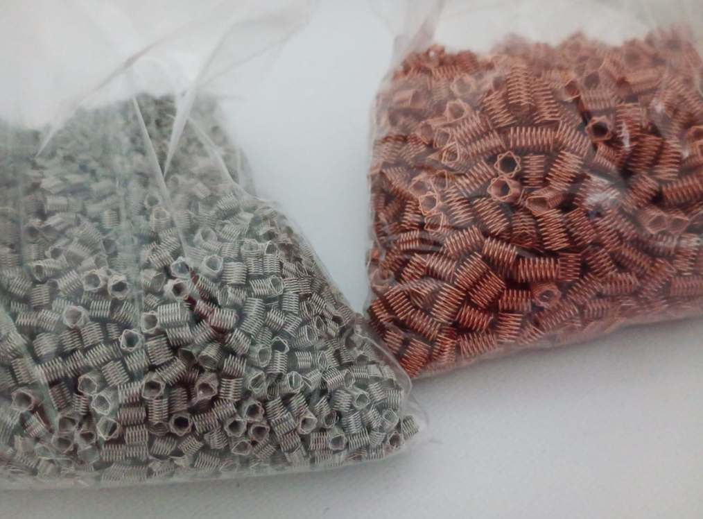

Updated my stuff, now fill is ssp and copper spiral. Not runned yet, but soon hopefully. Have around 15 liters once pot stilled stuff waiting (40-50% ABV)
Poland company, forgot name, but it was cheap, bargain. Was cheap charlie and took cheapest delivery, it took "months". Do not make same mistake.

After doing proper cleaning runs to clean the SPP, I would test it as it is intended to be used by doing a Spirit Run using your Low Wines.Jabman wrote: ↑Sat Nov 23, 2024 12:43 pmInteresting, how about running wash straight reflux? Is it worth to test?Saltbush Bill wrote: ↑Thu Oct 19, 2023 2:04 am Many don't bother to strip if using multiple plates.
It could be argued that wash once through 3 plates is triple distilled.
Sure you can try doing a single run with a wash, but you will always get cleaner results by stripping and doing a spirit run regardless what type of packing is used.
