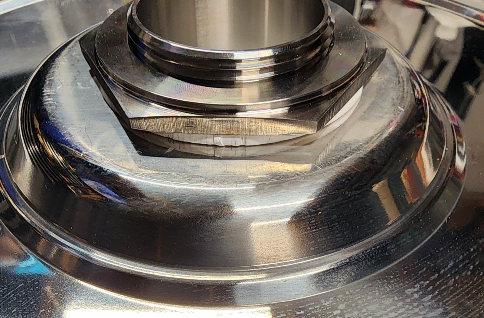

We used a 1 1/4" hole saw and a dremel flap disk to fit the 2" tri clamp bulkhead. I was very careful and sized the bulkhead hole so that it would thread into the lid material tightly without the nut. We wrapped both silicone gaskets with PTFE tape, installed everything and tightened it down. We also wrapped the lid seal in PTFE tape and reinstalled it.

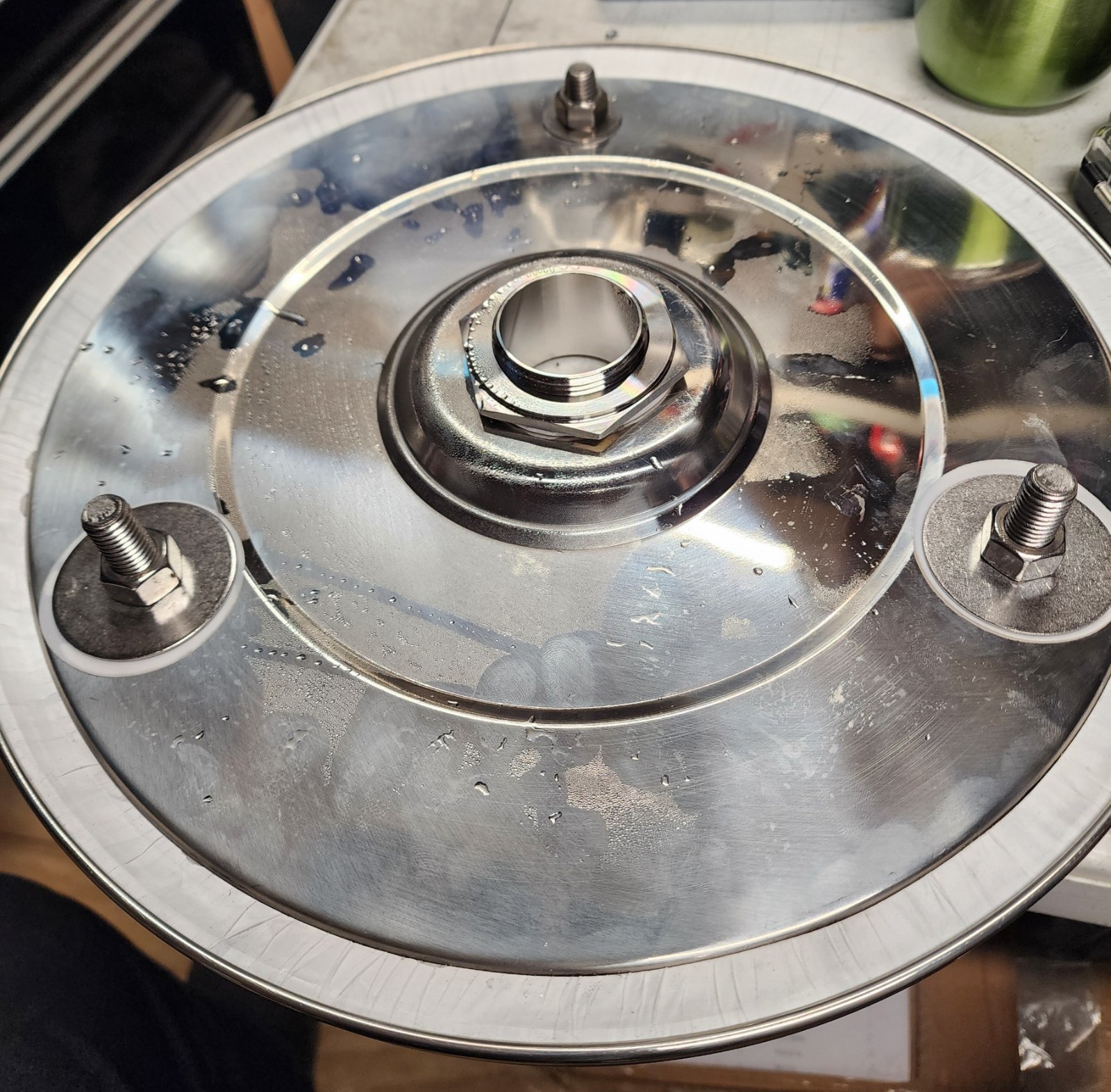

We filled the lid holes with 1/2" stainless bolts, fender washers, nuts and PTFE gaskets. We made the gaskets from USP PTFE blanks, I made a punch from 1/2" copper.

That's looking really neat Rusty.
You certainly will have a more pleasing result to look at than the ones I did.
Why the hell I didn't think to plug small holes with stainless bolts I don't know!
Seeing your pics was a complete "DOH!" moment for me since I have a shed filled with boxes of stainless hardware that I bought from a closing business.
Nice wiring job too, I hope the cutout doesn't cause you any issues but easy enough to bypass if it does.

Thanks Moose, we're having a blast! I think I saw the bolt thing on here someplace, but I can't seem to find the thread where I saw it to give credit to the actual originator. We're hoping to have it ready for a stream run this afternoon.MooseMan wrote: ↑Sun Feb 02, 2025 1:47 am That's looking really neat Rusty.
