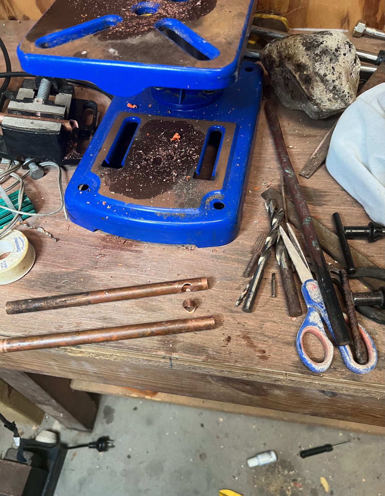

Are you sure you understand how it works? That mandrel looks balanced to me. Both sides will pull equally if you have shaped it correctly.BritishChemist wrote: ↑Wed Jan 15, 2025 11:42 am Big issue is that with just a single tang they are unbalanced and apply force that is unbalanced too.
- Posts: 38
- Joined: Sun Jan 12, 2025 12:02 pm
- Location: The Midlands
Re: Soldering multiple copper bits needs multiple arms???
Are you sure you are thinking about the home-made tool mentioned by me, or maybe you're talking about the expensive tool with retractable (twin) tangs which looks well-balance to me too?.........NZChris wrote: ↑Thu Jan 16, 2025 12:32 amAre you sure you understand how it works? That mandrel looks balanced to me. Both sides will pull equally if you have shaped it correctly.BritishChemist wrote: ↑Wed Jan 15, 2025 11:42 am Big issue is that with just a single tang they are unbalanced and apply force that is unbalanced too.
- Posts: 13955
The DIY tool made from a bolt.
- Posts: 38
- Posts: 483
The "tang" sticks out both sides. Its a triangle. How are you only seeing it on one side?
- Posts: 38
Regarding the home-made tool (NOT the expensive, professional tool).........If it was a triangle, how in the heck would you get it into the hole before it was swaged wider?
The tang can only be on one side if it's to fit through the hole to be widened. Even then, you'd have to "wiggle" it in at an angle to get it into the initial hole.
I'm finding this rather incredible!!!!
- Posts: 483
The slot in the side is to feed it through a smaller hole at an angle.
Think about getting a table through a doorway. You cant go straight through as its legs make it too wide. So you put the end of the leg through at an angle.-

You must not be good at puzzles. The tool is keyed (for lack of a better word) so you can snake it into the smaller hole. It’s like getting a large couch up spiral staircase. You have to move the couch around and flip it’s angle a few times to make it up and around the corner. From the side, that triangle looks a bit like a question mark. If you want a video of one of these, it will make sense then.
I’ve made and used one of these and as I said before, there can be a little cleanup required. Mainly some light file work on the extruded lip. You need to secure the pipe to the brace well and apply a firm and consistent pressure with the tool.

Maybe a picture of a commercial one would be easier to see. Even though it looks almost identical the angle may be better.
https://www.plumberschoice.com.au/produ ... inch-only/
- Posts: 589
Here is a photo of the commercial version ($358 US for 1/2")

The end of that DIY one would have been turned from the original bolt head, to a mushroom shape, (Meaning it would be dimensionally equal, not uneven as it looks in the picture) then flats ground to the sides, then finally the slot cut so that it can be inserted into a smaller hole drilled into the pipe ready to pull the shoulder.
It would definitely work but I'd anneal the copper first.
If you have nimble fingers, a bit of time and patience and ideally a set of bent nose needle pliers, you can do a passable job of it that way, but I wouldn't want to do a load of them!
I found it easier to flare the piece that's getting soldered onto the pipe with the hole, it's far simpler and provides lots of mating surface for the solder. I recently did it on a little Liebig water jacket when I had no suitable bits to hand so I had to get creative. Not pretty but my soldering never is! Lol

I now see the "broken triangle" aspect and that the tool can indeed be cut to enable it to be wiggled into the hole from the outside.
Unfortunately, it can only be used to make a 90 degree join using a pipe of a smaller diameter to the main pipe(s).
That introduces constrictions to the flow in the pipes, which I want to avoid.
Update.
Key Learning:
after a few short trials at building simple copper-copper bridges between parts via micro spot welding, it does indeed seem to be a lost cause - with cheap equipment anyway. Both high electrical conductivity and high thermal conductivity are working against us very effectively! If we put enough energy into the small weld to actually form a bridge, we're going to get our fingers burned (big time!).
So some form of jig is necessary.
The jig can be a solid one ideally with some form of mechanical fine-tuning of the final positioning (adjustment screws etc?), or maybe a temporary mouldable one (remember MooseMan's suggestion of using clay?) where the final positioning is done by hand and eye?
Because of the zig-zag nature of the component I want to make, it can be broken down visually into a series of "U Pieces", see diagram of one such U piece. I'm now going to experiment using MooseMan's idea of making a mouldable jig, let it set and then try silver soldering on a test U piece.
This is a huge simplification of the jig required to accurately solder the whole item required! All of its bits need to be held in the precise positions necessary as the entire item is soldered up in one operation (to avoid remelting neighbouring joints).
Exactly how is in the lap of the gods right now, but I'll try some ideas out and report back on how it goes!
Update.
Key Learning:

- Posts: 8915
Sometimes you just have to get in the shed and try something .
Sorry no milling machines or lathes , so the fit is not perfect and I made the coupling too short .best I could do with a drill and a file
The point of the exercise was to see how hard it was to hold it all together while brazing .
Turns out the wire twitch method works perfectly and I even accidentally dropped it on the floor and it stayed together .
Alas because the gap between the pipes was too close , the brazing rod started to flow between the pipes .
