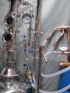

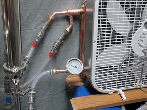

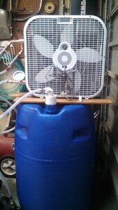

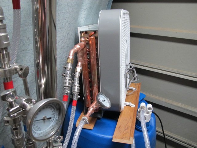

For my 26 Gallon Boiler and 4" plated column set-up, I use a large plastic drum as a cooling water reservoir so I don't waste water, and I built a radiator core with a fan that I attached to it for cooling the hot return water flowing back to the reservoir tank. I have a submersible fountain pump in the reservoir tank which circulates the water through the still. I split my cooling water feed line into two separate lines. One feeds the Dephlegmator, which is controlled with a needle valve, (coolant enters in the bottom and out the top where I installed the needle valve,) and the other line feeds the condenser's cooling jacket. Each have separate control valves and work independent of each other, which gives me better control of each device. I run the flow in and out of my Dephlegmator sort of backwards, in that my coolant enters it closest to the product flow path, but it eliminates the chance of trapping air in a high spot in the Dephlegmator, which could make it run erratically.

Nice setup there u just gave me 1 idea how to cool the watter

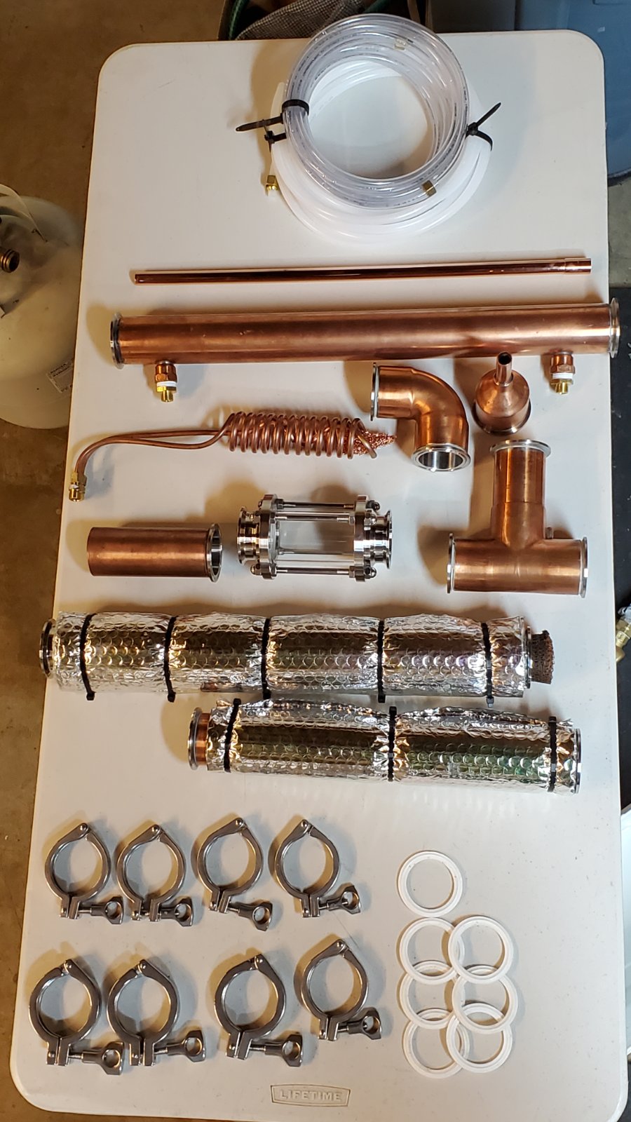

That was a great read, and funny how much it matches some of the changes I am making to my still.Prairiepiss wrote: ↑Sun Dec 18, 2011 5:22 pm CM Still Output Improvement Mods Mile High / Brewhaus PSII.
Speaking of packing. These commercial available stills come with two kinds of packing copper mesh and Ceramic Raschig Rings. Again this is only an observation on my part. I have no proof on this one. Would like some feed back on it from those that do. But it is my understanding if both types are used in the same column. The two different types will hamper the columns ability to equalize with a proper temp gradient. Since the copper mesh and the Ceramic Raschig Rings handle heat differently. The gradual temp gradient from bottom to the top will be broken with the change from one packing to the other. I'm not going to say one is better then the other. What I am trying to say is it is better to stick with one kind of packing throughout the whole column. And a little copper in the vapor path will help remove sulfides created during fermentation.
This information was comprised of info I have gathered from many different threads around HD. And some real world experimenting with my own CM still. I would like to thank all those that helped me learn all of this. But that is so many. So I will say Thank you to HD.
And feel free to point out other things I mite have missed or forgotten. I would like to update it so it is a one stop shop. For those that need it. Forgive my crappy paint pics. Its all i have to work with.
Mods I placed it here in the novice section because. I thought it should be available to the new members. And they would come across it easier here. If you think we need to move it that's fine.
I bought the kit altogether, I babysit my run the whole time, and yes was making very fine-tuning on my water flow. I am at the point know of putting a split intake valve and separating the water flow so I can control the water jacket on the column more precisely
However, your information on using Copper mesh and Ceramic in the same column...
I don't know how true it is, as I am only one person and I only have my own personal data on running my own Sill, I have been running it now for a year.
So yes I am still a newbie. but, I am pulling some high proofing #'s.
My normal run runs between 190 and 196. I really do not know how I could be doing any better than that.
The changes I am making will make it easier to make more precise adjustments, but I don't see how I'm going to get any higher 95 to 98 ABV?

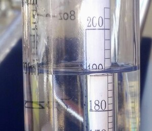

Re: CM Still Output Improvement Mods Mile High / Brewhaus PSII.
well my eyes are not that good but so this is the best I can get
got another batch tomorrow

You're running it too fast for the condenser. That, is why I tossed my "dual purpose still" head and condenser in the recycle box. To run that thing slow enough to not burn through ice water at an alarming rate, you're not gonna get more than about 2 qts an hour.
Plan accordingly, or build a proper rig that will get through a hobby sized run in decent time.

Thanks for the candid feedback. Alarming rate of ice water is right.Deplorable wrote: ↑Sun Mar 07, 2021 5:18 pm You're running it too fast for the condenser. That, is why I tossed my "dual purpose still" head and condenser in the recycle box. To run that thing slow enough to not burn through ice water at an alarming rate, you're not gonna get more than about 2 qts an hour.
It takes 540cal/g to knock water vapor to liquid. It takes 80cal/g to melt ice into water. Therefore it takes 6.75x as much ice for the same volume of water just to change the state of matter. For a modest 2 gallons of distillate, it would take 13.5 gallons of ice just to condense. Granted ethanol does take less energy to do all of this, but you're still fighting efficiency issues such as the pump generating heat, ambient temps, sun, etc. All these numbers make me go
If anyone has feedback on run rates on spirit runs, I would still like to hear what's worked for you.
Sadly, I'm thinking running this thing in summer when water temps hits 80f may be mission impossible.

Smitty, I've come to the conclusion that for myself it's just easier to run cooling water to waste from the tap. Many here have somewhat elaborate recirculating systems with radiators and fans to keep a 50 gallon drum of condenser water cool enough to make it through a run.
If I had the space for such an elaborate set up, I'd do the same thing.
Another option for you is to cut off that inefficient liebig, and build a nice copper one that will transfer the heat better and reduce overall water consumption.
I did this and ran it briefly for a few runs before building a completely different still. It improved my run times by almost a third and reduced water consumption a bit as well.
