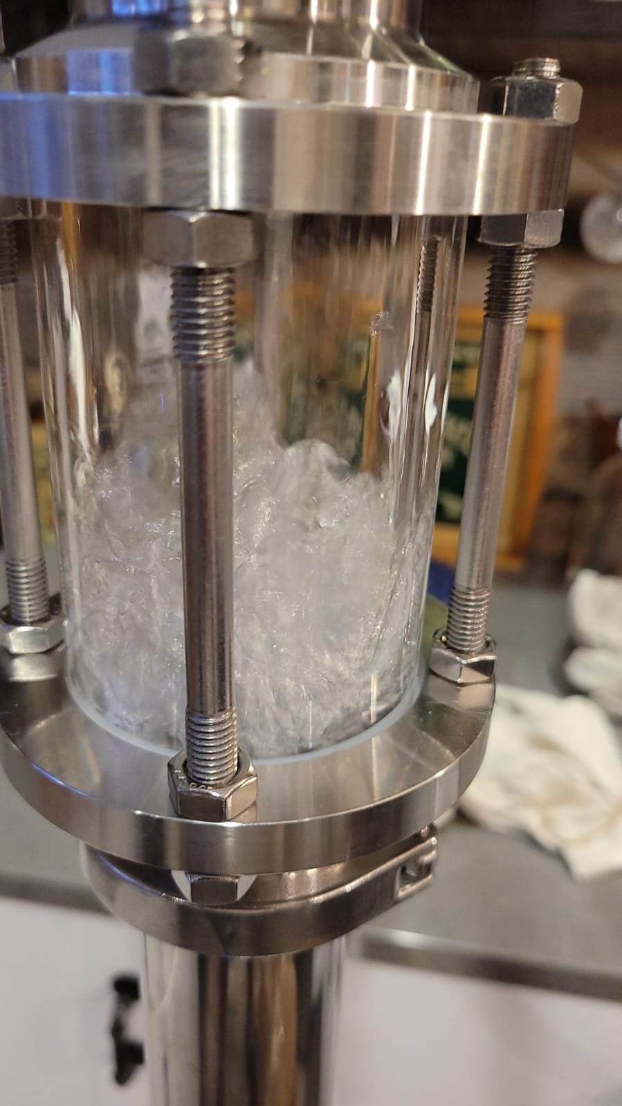

So the modification that I think helped the most was using the copper mesh in the reflux condenser. I put the filter screen for my sight glass below the condenser to break the flow of liquid as well. I couldn't find anything to make a conical to break up the flow... thus the filter screen.

- Posts: 12846
Re: CM Still Output Improvement Mods Mile High / Brewhaus PSII.
That explains the flooding seen in the site glass.
